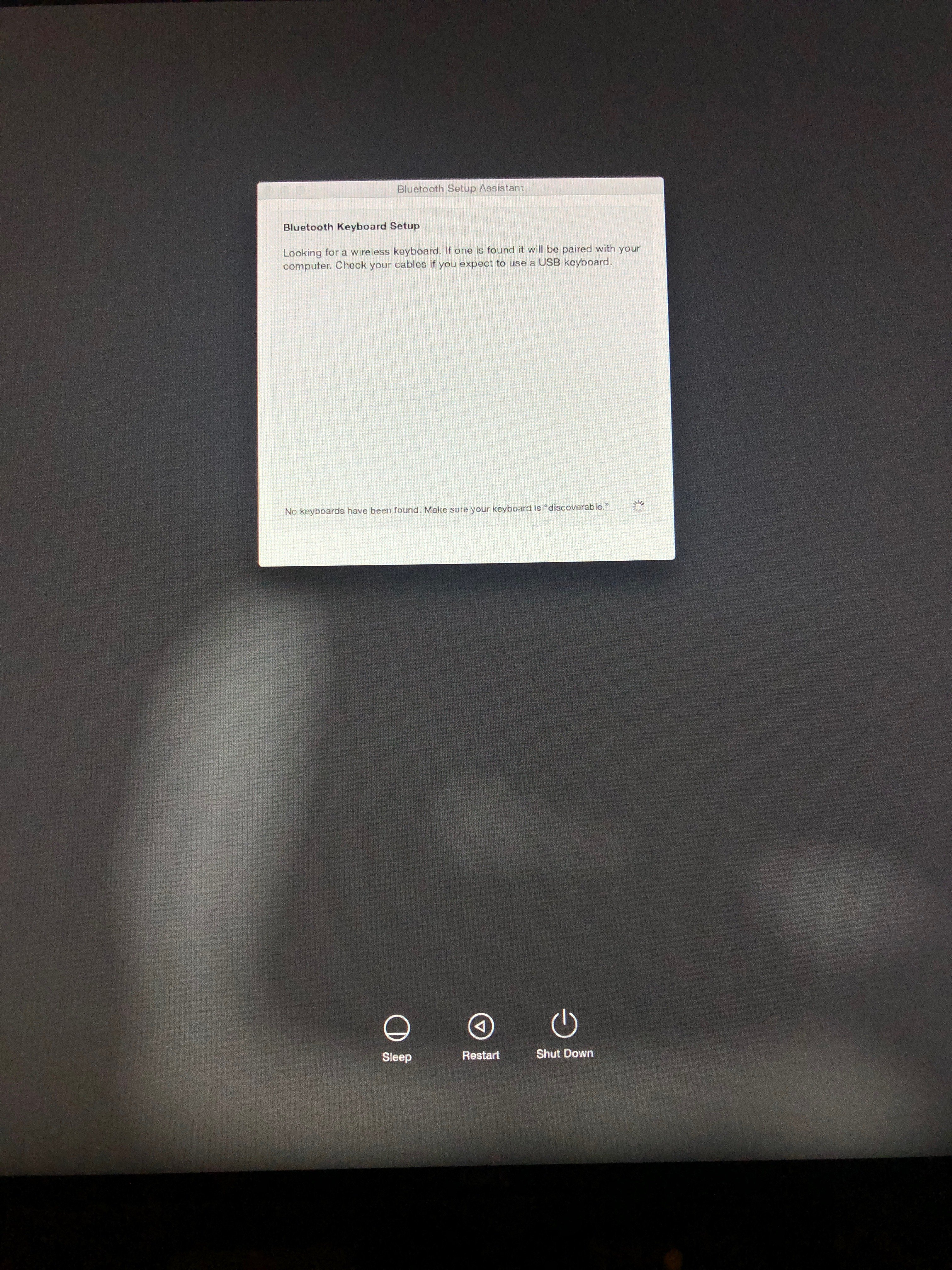

Very odd thing happened just now I should note. The only thing plugged in was the monitor and I pressed the power button a few times then the logon screen came on but it had this odd grey image in the background, like someone sitting at a computer. Is this safe mode? I logged on, my harddrives were there, but everything was loading so slowly and there were no apps. I should mention the background looked the same as it usually does.
sure, this is it before I plugged the keyboard in, or just as I was..
Those white "smudges" don't look like anything I've ever seen before. But the login screen with High Sierra is a "blurred" version of your desktop wallpaper, so does your desktop have something like that on it?
Sounds like your black screen issue is solved though?
My background is the high Sierra stock background, so honestly those white smudges don’t make sense. Also there’s another circular smudge behind that dialogue bar which is what makes it look someone sitting at computer desk... kinda creepy.
But again, this only happened when the computer was already on and I pressed the power button a few times in a row. And when It logged me on, like I said there were no apps, just a few files on the desk top and the links to my drives. some of the files I remember being from a previous version of my Mac, possibly from the old hdd I booted from originally years ago? I deleted a bunch of files from that drive, so is it somehow possible the computer is booting from that old drive? When I rebooted, the black screen issue persisted again. Not sure what’s going on at all, it’s really bewildering.
