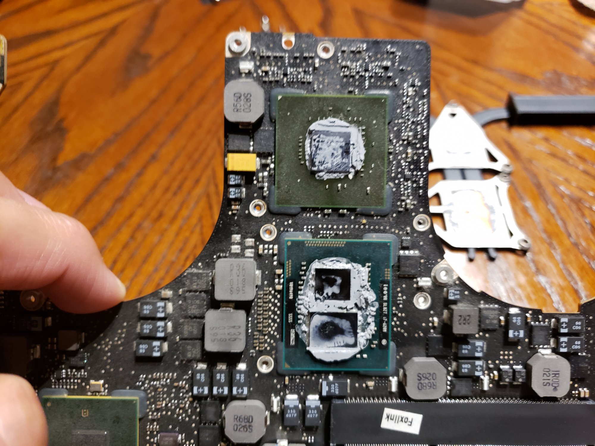

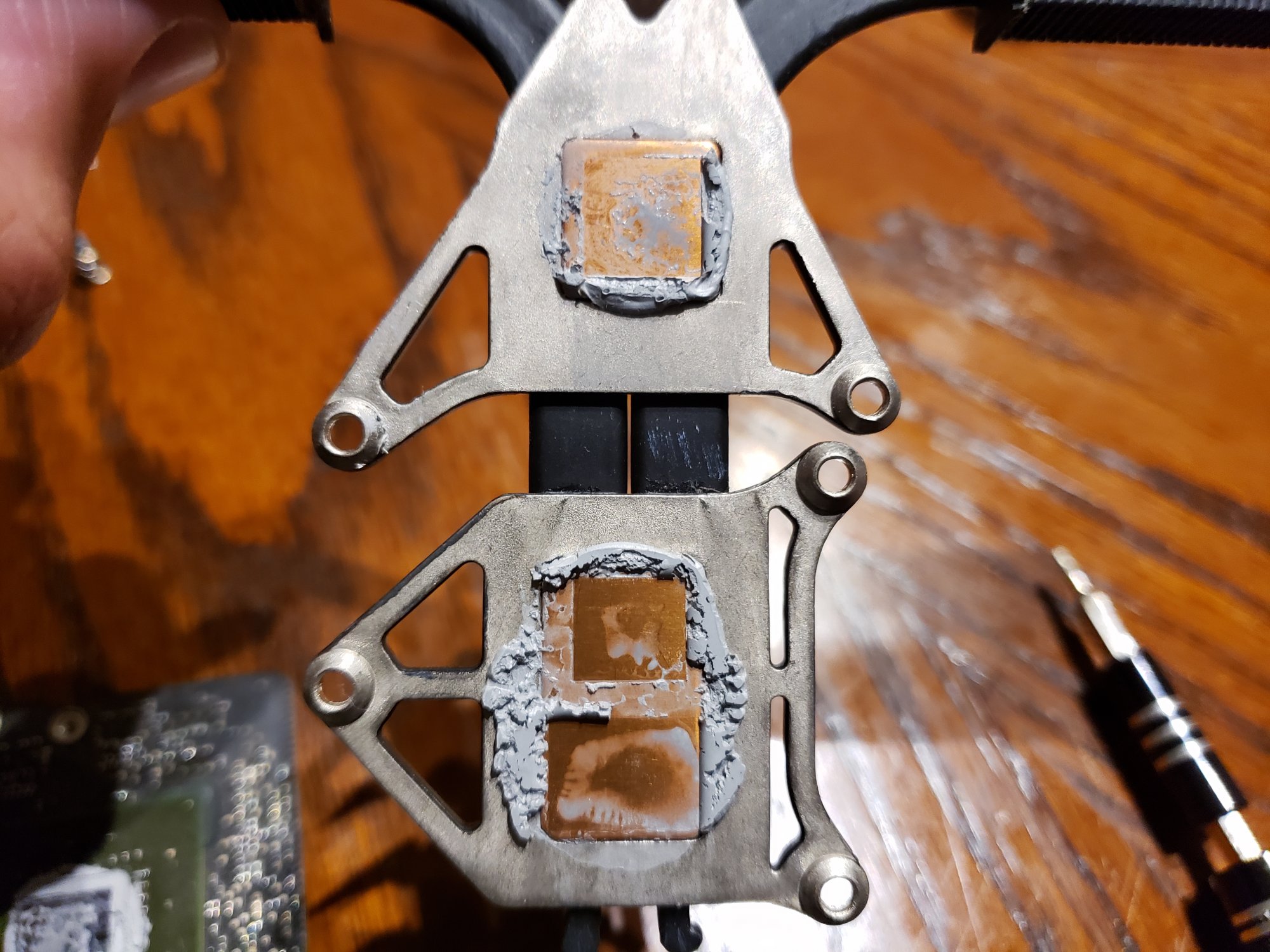

I finally had a moment to replace the thermal paste and do a thorough cleaning of the heat sink and fans. There was very little paste left on the components and I thought it was surely the issue. After applying some new thermal paste I tested it by streaming HD video and it would eventually reach 70 degrees. While doing normal tasks like web browsing and downloading it stays at an even 50 or so. Overall, it helped to reduce the temp during normal usage but when I tried to test its efficiency it performed the same at heavy loads.
Do you guys think it is just the unibody design that limits the cooling capabilities?
That looks like too much paste, but that wouldn't influence the temperatures
It certainly looks as if too much paste was originally used, and I agree that generally that wouldn't influence thermal performance - unless it's a low quality paste.
However the use of too much paste should be avoided because of the danger of shorting components - especially with a conductive paste.
