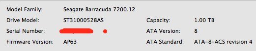

I purchased a 21.5" iMac on February 24th, 2012. It has the 1TB drive, which is a Seagate Barracuda ST31000528AS 7200RPM drive. About 30 minutes ago, the iMac started to make a very, very loud "hum" and "grinding" sound, that if you put your fingers on the back of the case, you could feel a slight vibration. It's been on and off (mostly making noise vs. not making any), while idling. I ran the Apple Hardware Test, and checked the S.M.A.R.T status, it passed both. The grinding and humming is extremely loud.
Here are detailed specs of the drive...

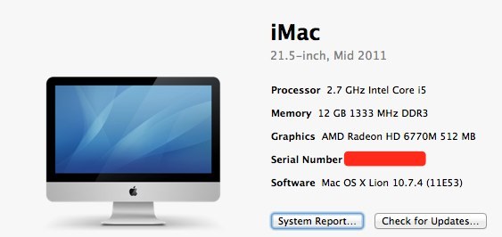

... and the iMac itself.
