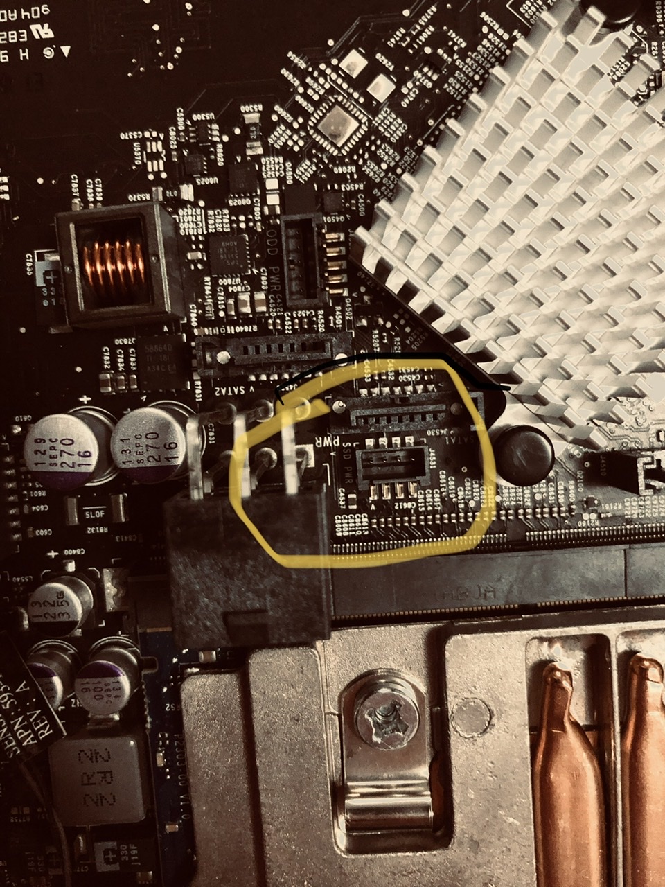

this is my mac 21,5 2011 - yes, ssd power connector is present.
So, you just connect 4 pin connector from owc and simple sata cable. Thats all. About what model of ssd you will get- i don’t know. I just waiting my cable from aliexpress and i think i will take something from a-data or crucial drives. About speed of your SATA: Sata 0 connector - 6gb, Sata 1 - 6gb, Sata 2 when you connect ODD will be 3gb, cause it ODD.
