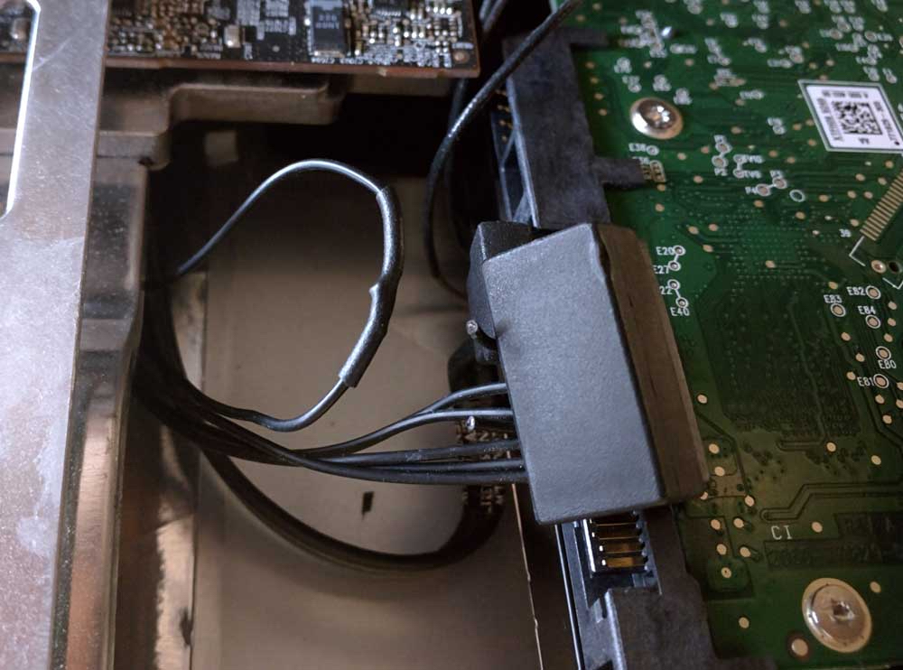

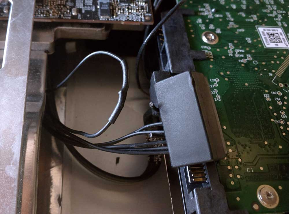

No problem, I ran my old 2011 iMac for several years using the delock enclosure with a SATA SSD without any issues. (It was much easier than opening the iMac and risking damage, and dealing with the thermal runaway fan issue that will occur when anything other than the stock hdd is used.)
Actually there is a fix for the run away fan issue now. and it doesn't cost you 50.00 for OWC Solution and all you need is Macs fan control.
