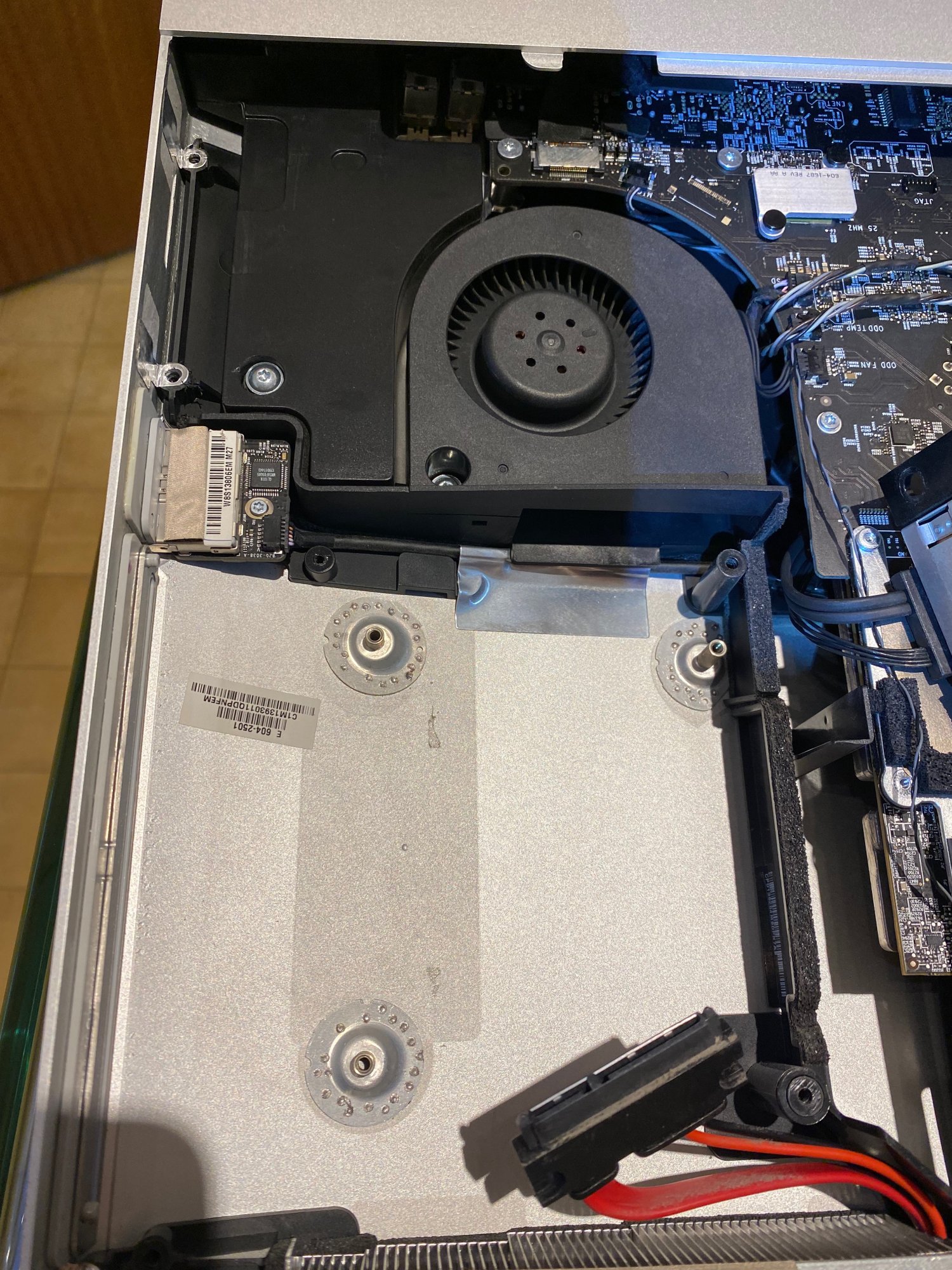

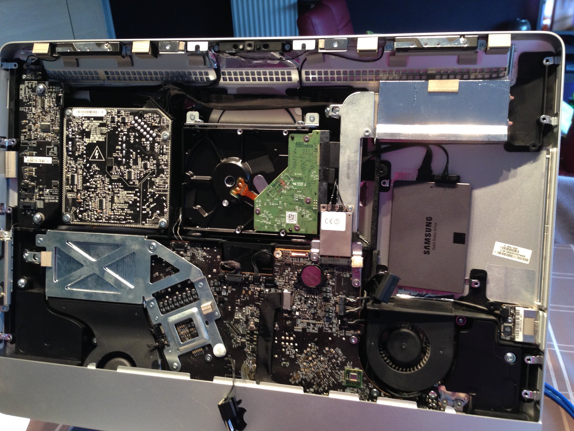

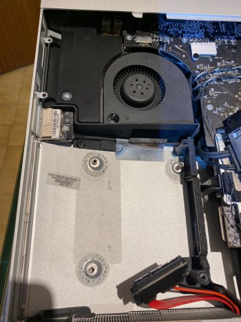

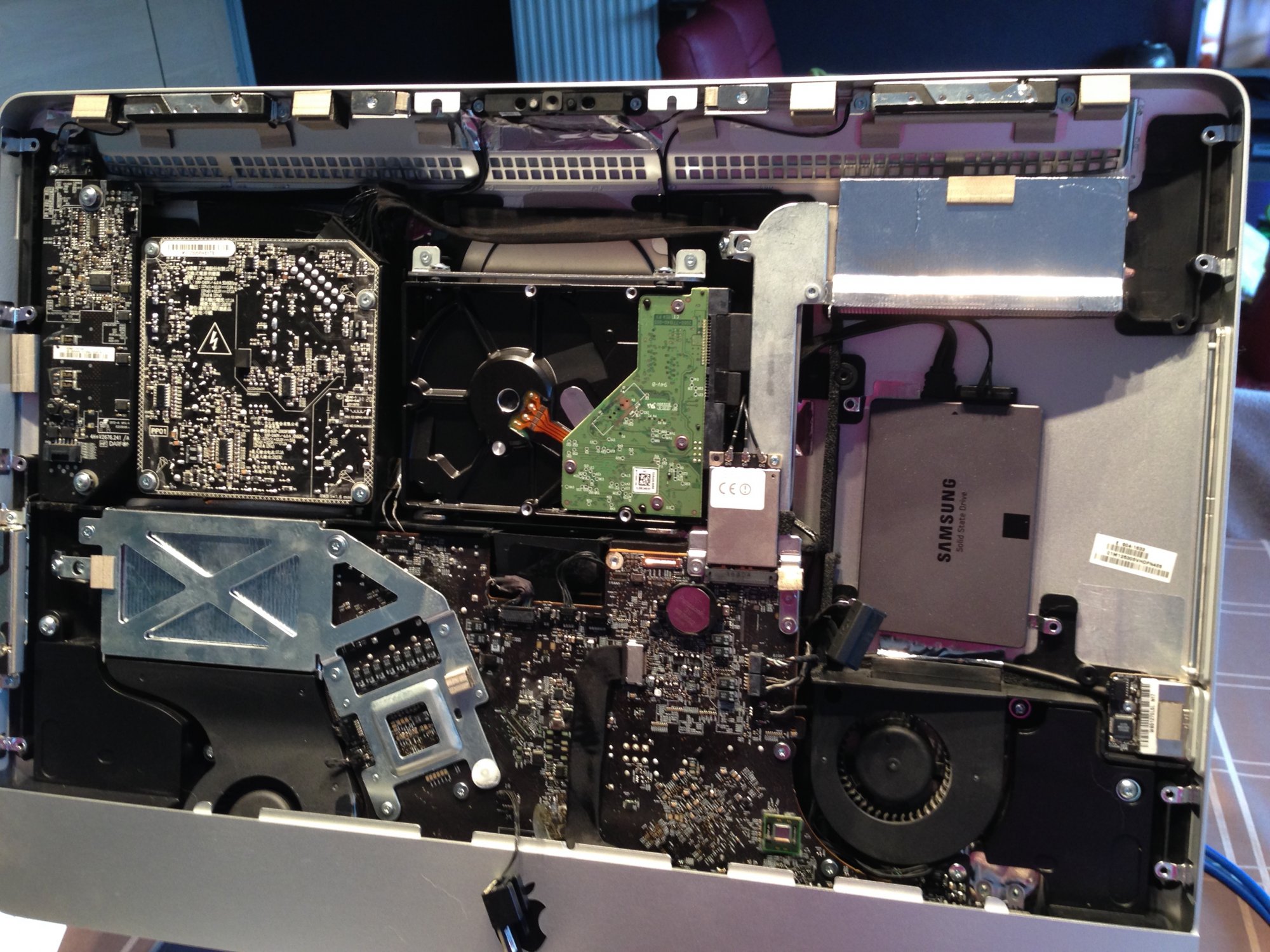

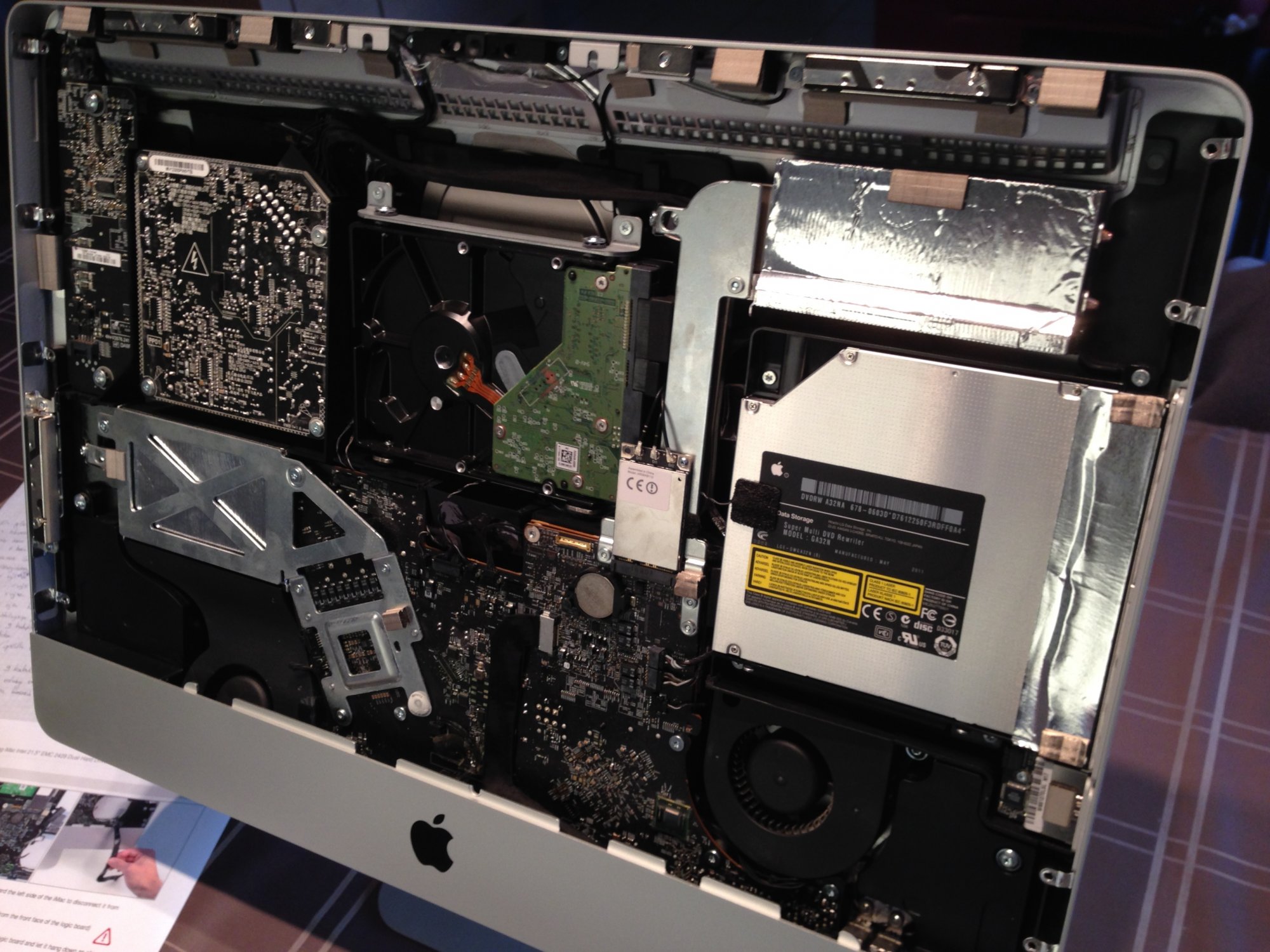

Adding a 840 EVO to my mid 2011 21,5 inch to create a fusion drive with the original HDD did not cause any issues. SSD was installed almost 8 years ago and the iMac is still my daily computer. There’s space behind the CD slot to stick the SSD. There’s an empty connector you can use. Because the original HDD is still there, there is no need for any software or sensors to control the fans. I used the ifixit kit to install the SSD.
Hope that helps.

Yeah, similar experience. About two years ago I put a Samsung EVO 500GB behind my optical drive on my mid 2011 21.5. At the same time I swapped in an i7 2600S and bumped it up to 32GB RAM. I used Carbon Copy Cloner to copy the original hard drive to the SSD. Ten years old and this computer runs better than new.

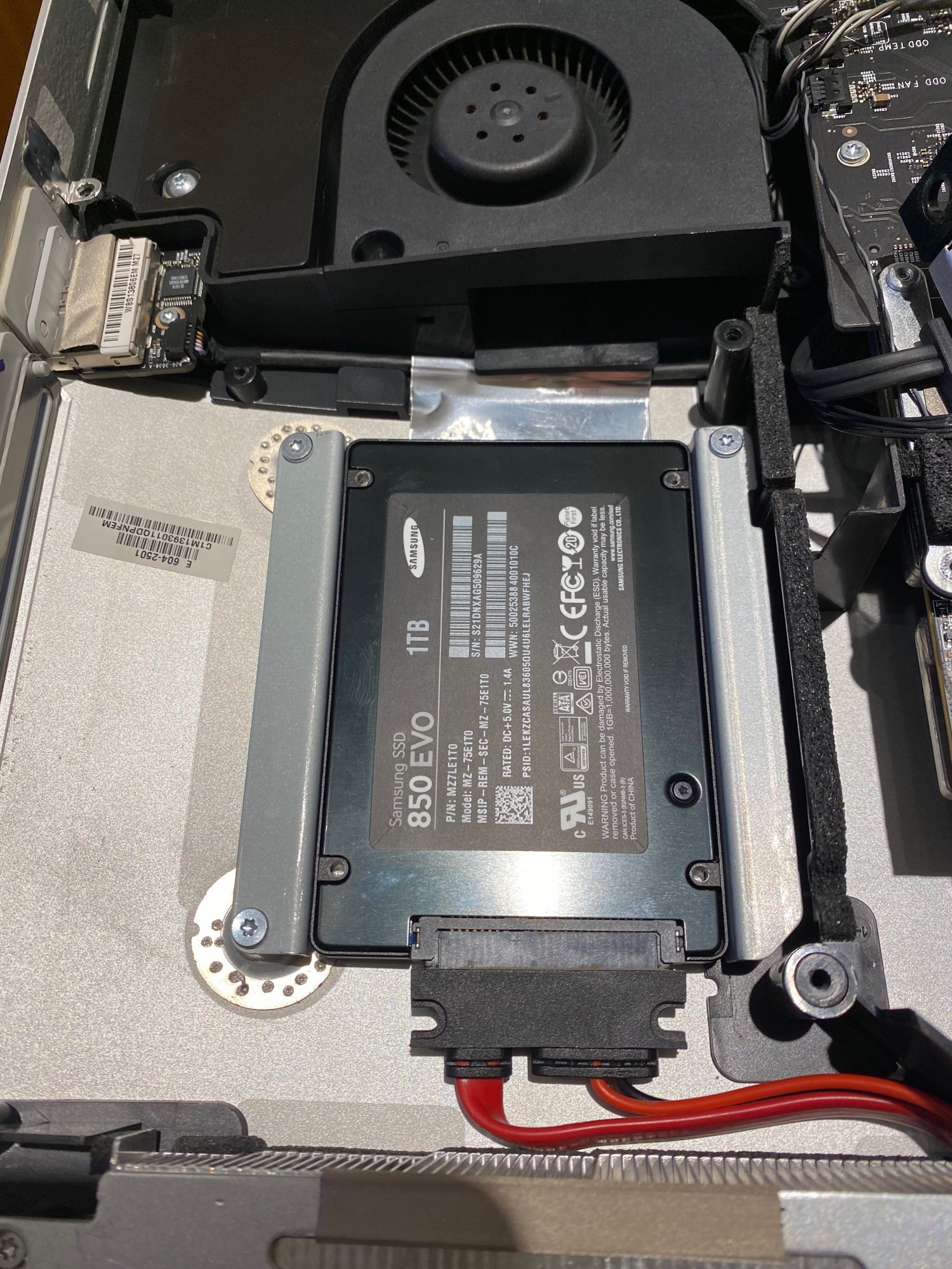

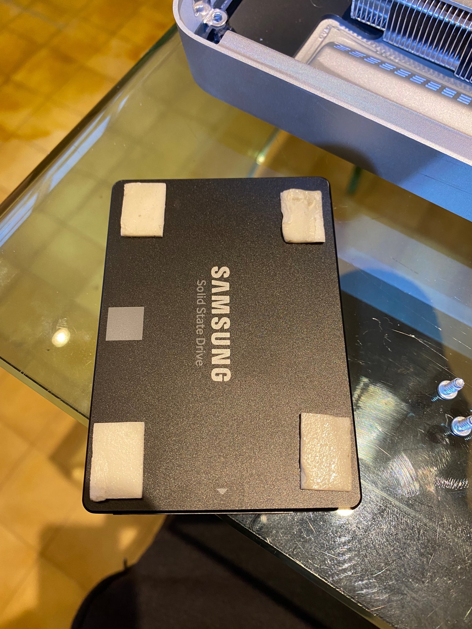

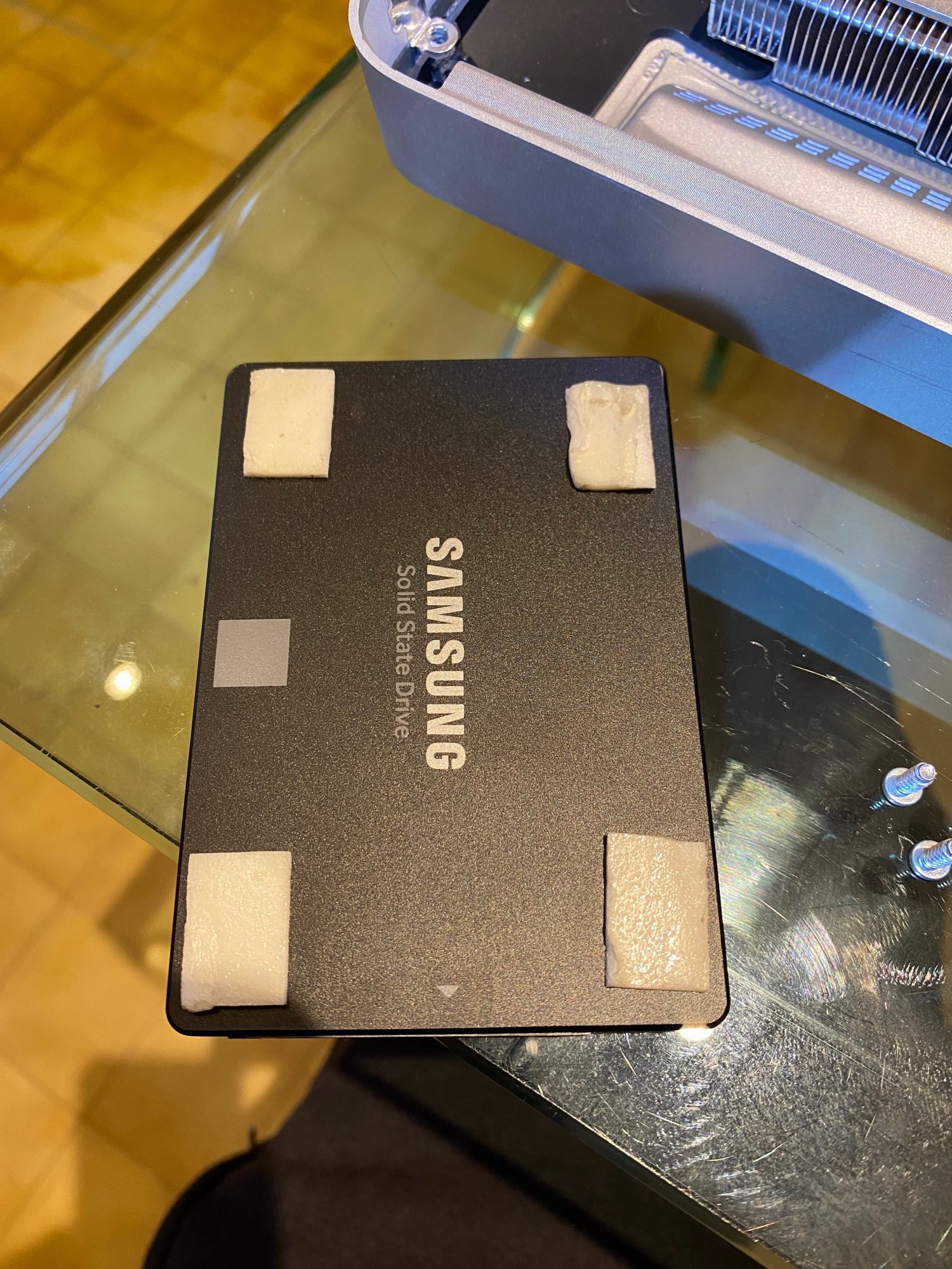

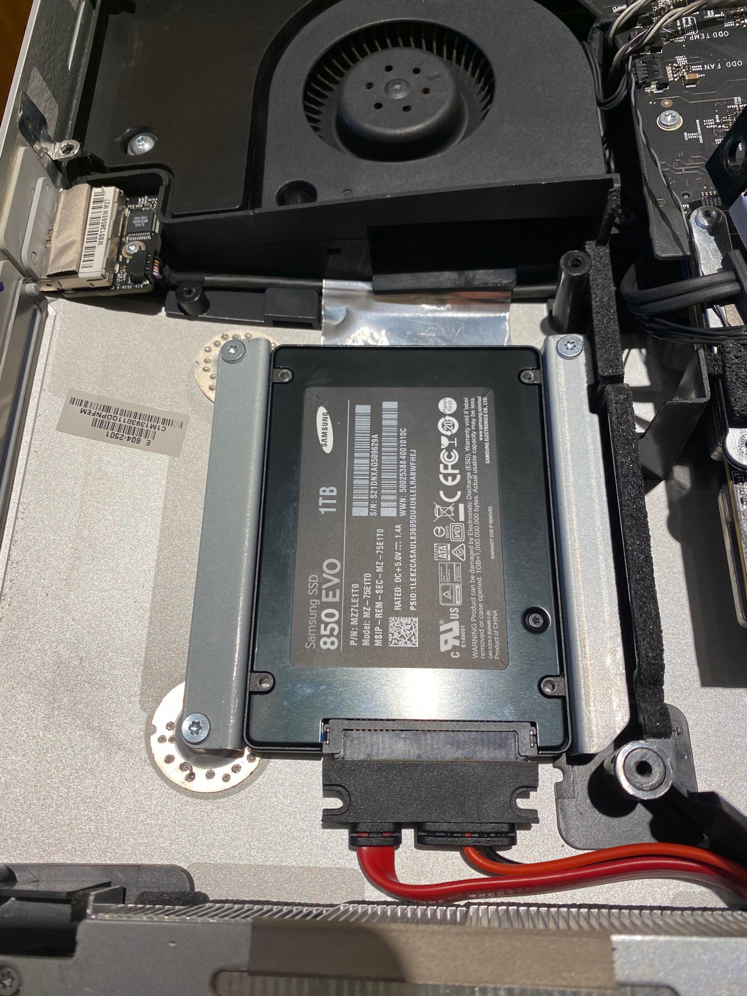

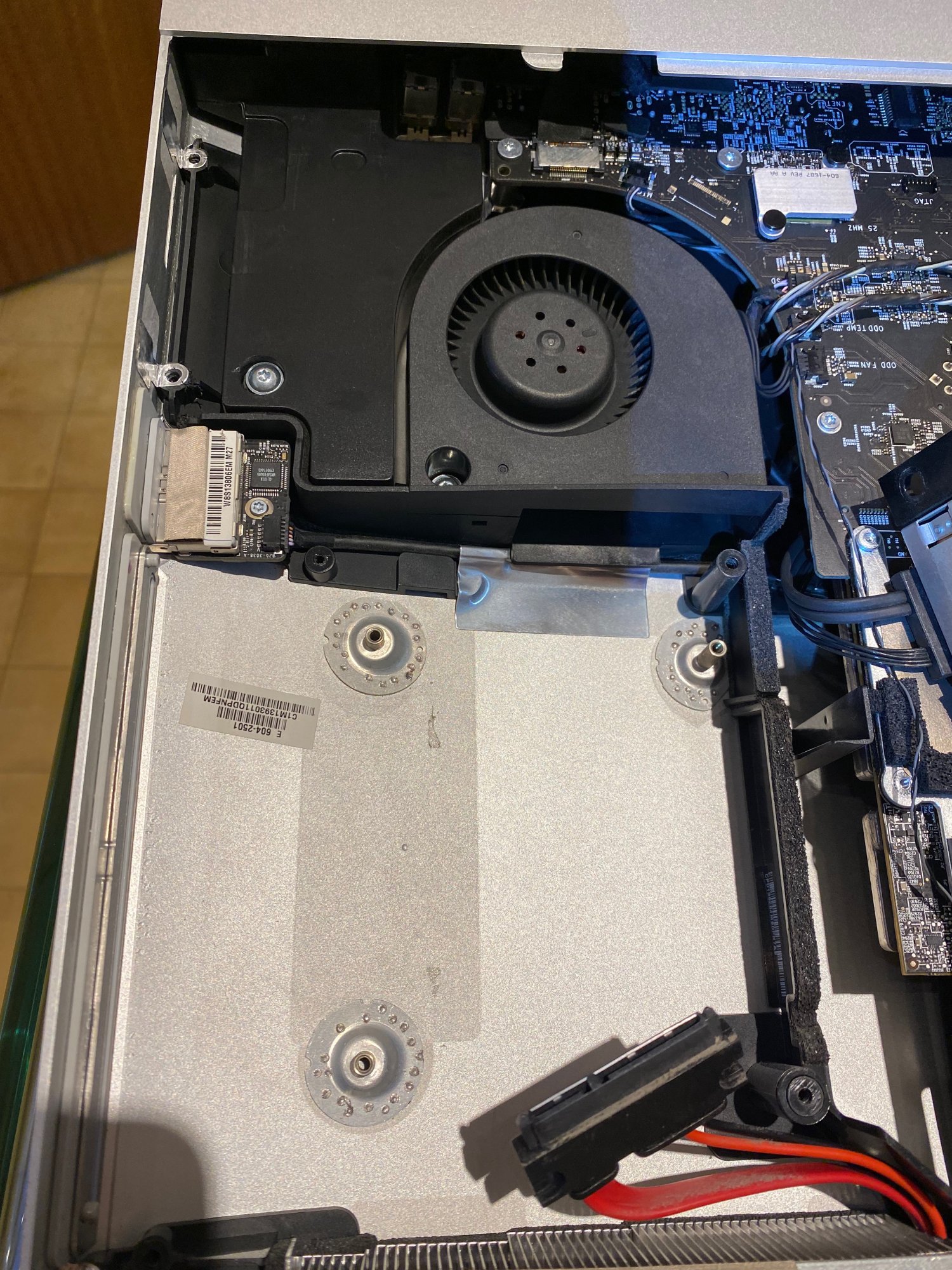

The 850 EVO was installed in 2015 by a Mac 'specialist' who used 4 sticky pads that lost adhesion leaving it dangling on its cables underneath the ODD. I have since been back in myself and refitted it properly using the factory frame when I replaced the long dead Seagate 1TB spinner with an 2TB 860 EVO plus OWC Temperature Sensor.
Just hanging around...😱
Very little contact area can be seen from only two of the sticky pads - not rocket science when you take into account the curve in the case. 🙄 My guess is it had become detached by the time I had driven it home...😡
Sticky pads vs Apple mounting frame designed for the job!

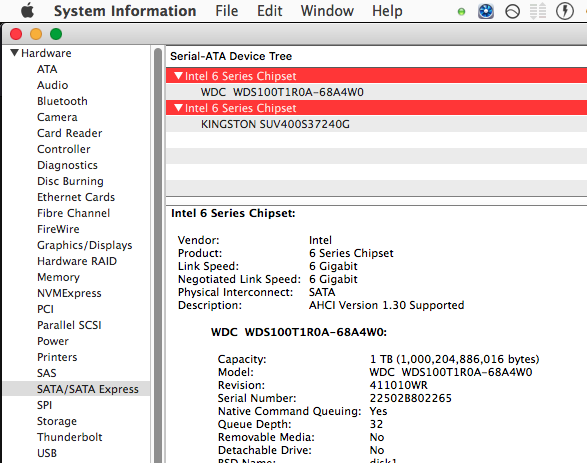

Adding on this, I can attest (for those reading this discussion later on) that I’ve experienced consistent good outcomes with running WD Blue (from 2021) and WD Red (from 2023) SATA III 2.5-inch and m.2 form factor SSDs in my 2008 aluminium MacBook Pro (which uses the ICH8-M chipset) and 2011 unibody MacBook Pro (which uses the Intel 6 Series chipset). (Both the Blue and Red lines have built-in DRAM caches.) The Kingston model you see below (which also has a built-in DRAM cache) works well as a SATA III boot volume on the late 2011 MBP.
Additionally, I’ve also had success using a 2018-era, budget SATA III SSD, the iRecData 6, as the boot volume in another 2011 MBP with the Intel 6 Series and had no issues:
In short: compatibility/suitability may come down to the chipset found in your Mac (see: System Information > SATA/SATA Express tab): Macs using the Nvidia chipset, like those from late 2008 through 2010, may have completely different tolerances for which SATA III SSDs they can use, especially for boot volumes. It really all comes down to the Mac’s firmware associated with the SATA bus.
