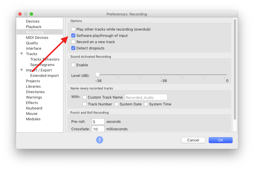

Latency may rear its ugly head, and the option does use cpu. You may want to use overdub, but that's up to you.
