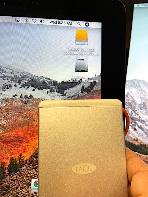

2013 iMac with the ultra SLOW spinning 5400RPM HDD - just found Transcend and LaCie made some nifty Thunderbolt drives that is now used to be my primary boot drive.
What a screaming machine now !
I replaced the LaCie spinning drive with an SSD and voila - the external TB drive now boots the OS, runs web browsing super quick and no longer the spinning beach balls...
Power is in the bus passed thru the TB port.
The LaCie was used on eBay for $50 and the SSD was $40. Total cost $90.
The more expensive route is the Transcend 256 or 512 GB SSD with built in Thunderbolt.
The plus side is that I didn't need to open up the iMac and replace the slow spinning drive - it now sits as my Time Machine, music repository, and photo archive.
Gotta say Thunderbolt is at least 2x faster than using an external USB drive!
