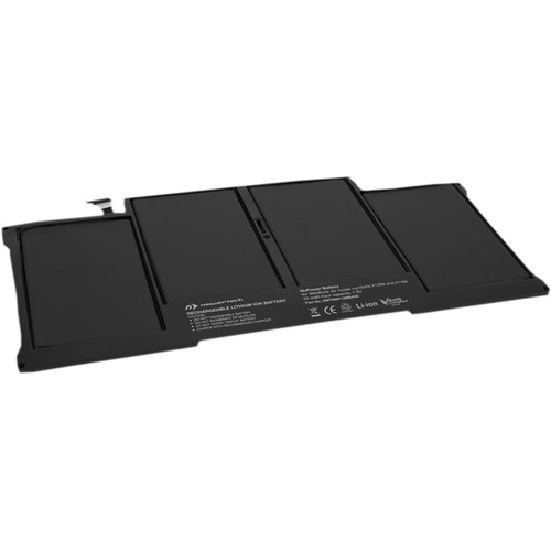

Now I buy only genuine factory batteries or the best aftermarket brand: NewerTech (NuPower) cells that have proven themselves over a period of a year - they are are the best - retains power evenly from 100% down to 0.
NewerTech/Nupower 55Wh highly recommend:

Yes, I have seen this a lot! ...Now I buy only genuine factory batteries or the best aftermarket brand: NewerTech (NuPower) ...
Yeah, I'm kicking myself a bit now that I didn't check in here before pulling the trigger on that AMZ-battery. Maybe I'll be lucky and I did come across the one seller that actually sells decent stuff instead of a steaming pile of 💩. If not, I can always get on AMZ's case for a refund and go with a NewerTech instead.
Update: No change after SMC-reset... battery lasted down to just under 20% and then the dreaded no-warning-shutdown.
I'm too old to waste my time with crap products like this, so I've already initiated the return with AMZ and just got done ordering a NewerTech battery via B&H. The defective AMZ one was $55 and a proper NewerTech one is $79 @ B&H
