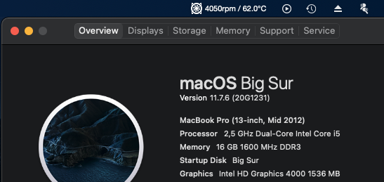

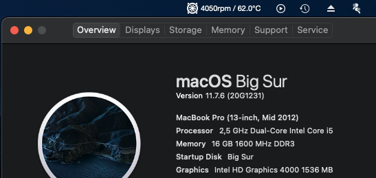

I replaced a thermal compound in mine in 2018 and use it in a clamshell mode and I don't see any extreme temperatures.
Something is not quite right here. Are you sure that your Mac has not been hijacked by some extracurricular activities?
