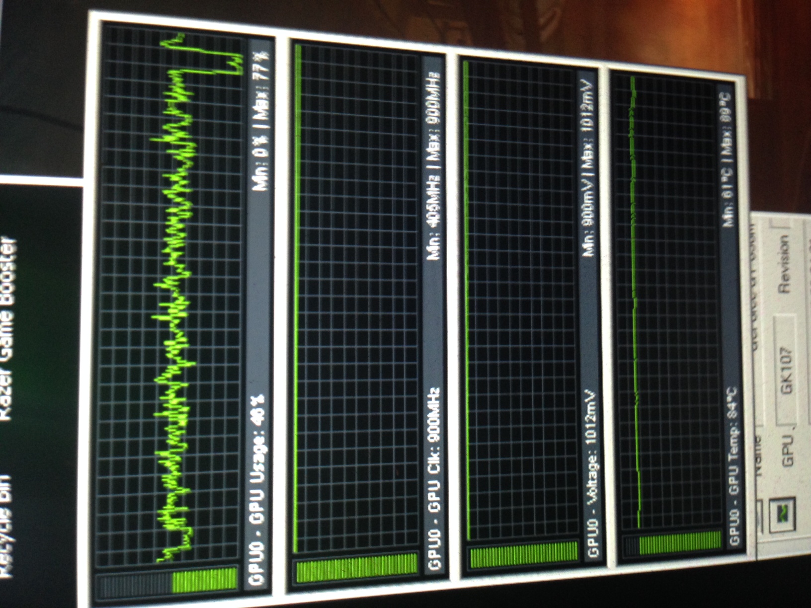

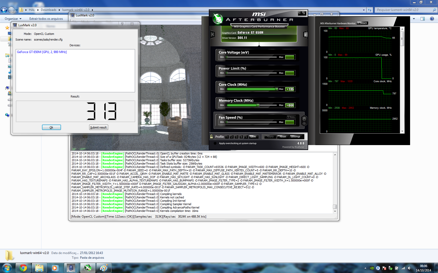

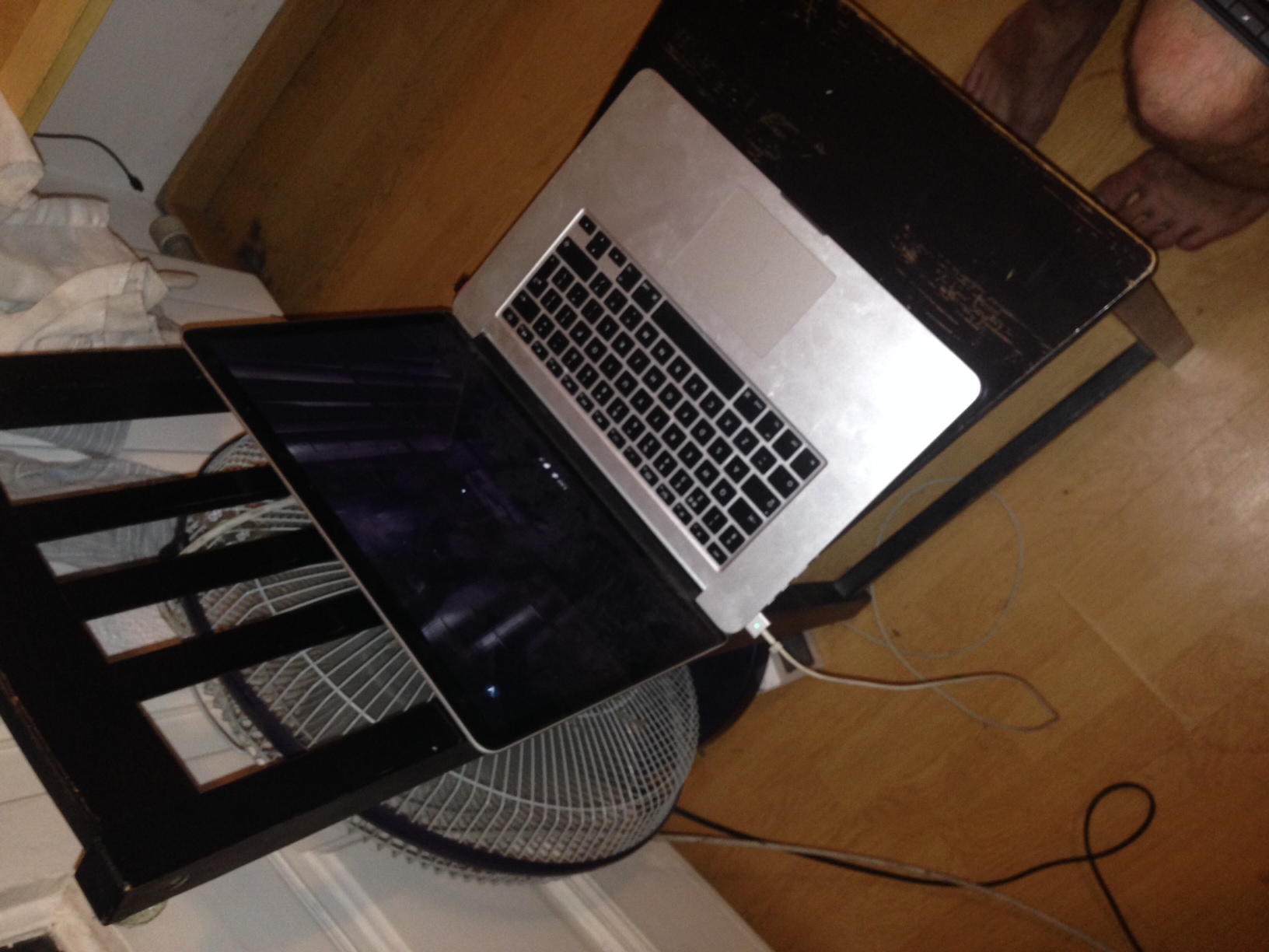

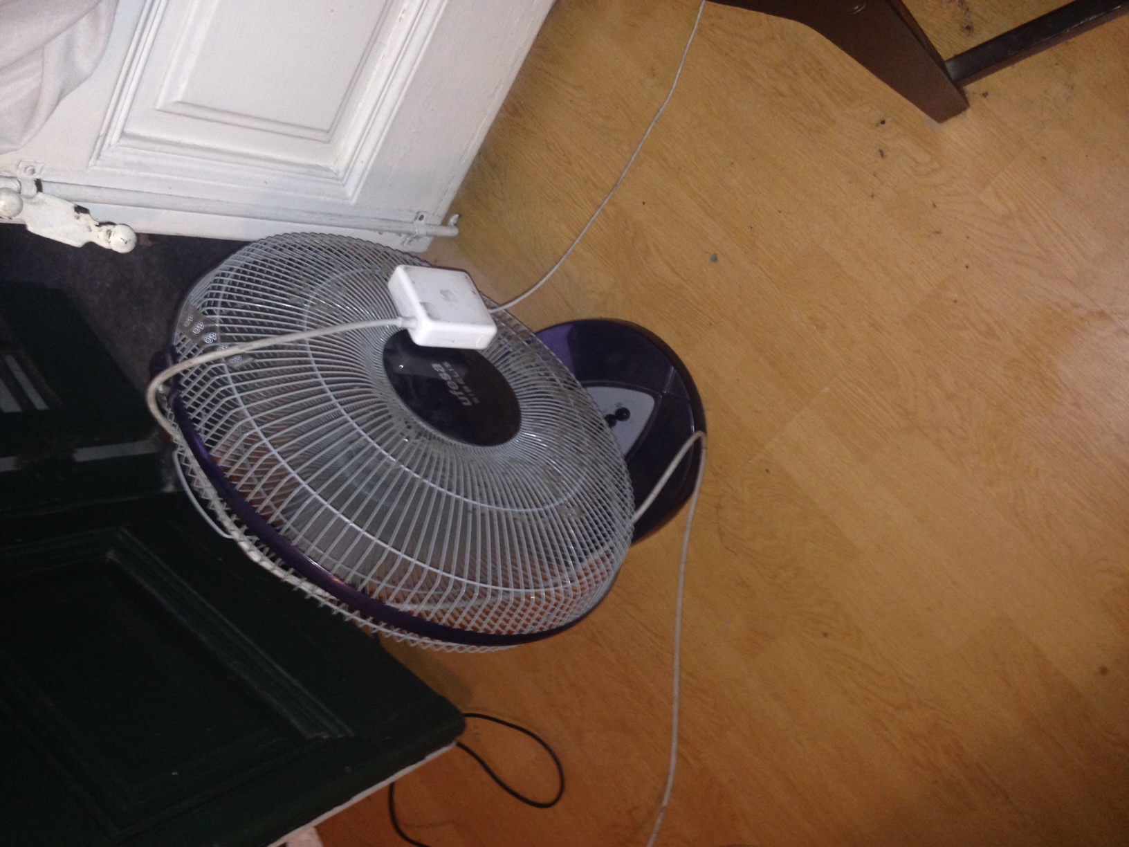

🙂 I figured out how you can turn on throttling + 100% CPU 🙂
my script + a lowtech workaround
please be sure to keep the power supply cool, it seems to cause throttling also, we've been playing wolfenstein on high graphics without any issues at all. 🙂 Should probably run it on mid though...

eh after running for a couple of hours the battery for my laptop was empty and the machine turned off.
Perhaps its not a great idea to run at 900MHZ, or perhaps it has to do with the TURBO or with the powersupply just sucking. : /
shame :/ be careful!
It has to do with the power required being higher than the PSU can provide. The MBP will also draw from the battery to supply the additional power it requires. It's not unusual for it to drop a few % while gaming.
Whatever you've been doing is drawing lots of additional power. Probably not a good thing...

hmm after a little bit of messing around, i think the problem is that the macbook gets hot at the power cord connection, when that happens, worst case it shuts itself off and does not allow power to conduct as to keep the heat down. i think this is what caused my laptop to die. now that i have a thermal heat pad thingy im not seeing the problem anymore unless i move my laptop so that the topleft corner doesnt get sufficiently cooled down. i have turbo enabled and im running at 900mhz.
Hmmm, this makes me wonder if attaching heatsinks onto the body of the power brick will work... It is highly plausible that the power brick is thermally limited, though this is the first time I've heard of it being suggested.
guys, I am not experiencing any serious throttling problem anymore!
Apparently they fixed in the latests Yosemite DP (don't know which one, I'm using GM3.0)!
no throttlestop or firing the fans to max before launching anything, and still works perfectly (tried with borderlands 2 and luxbench, 100%)
even overclocked with luxbench, getting results close to a 660m (screenshot attached)
