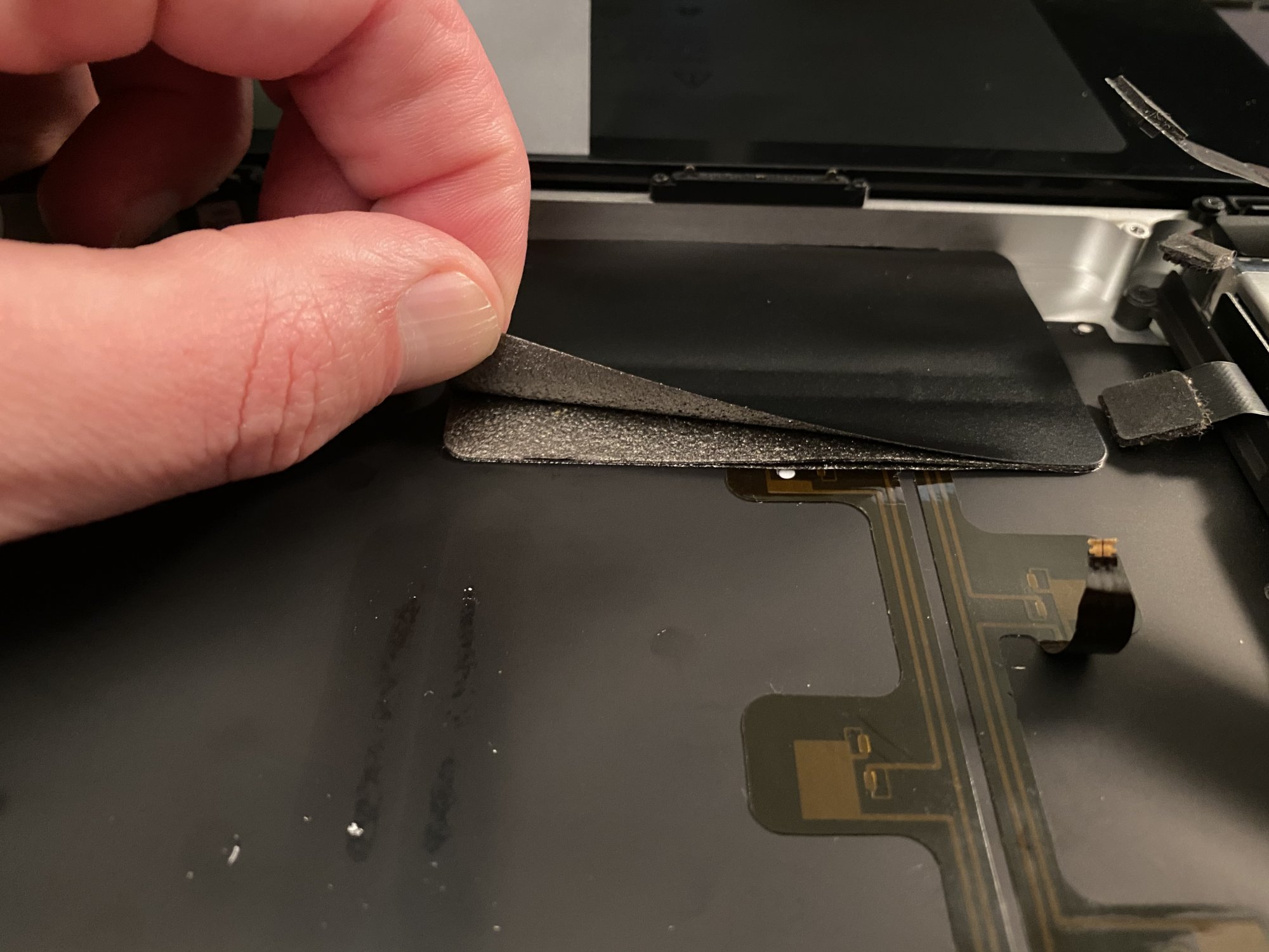

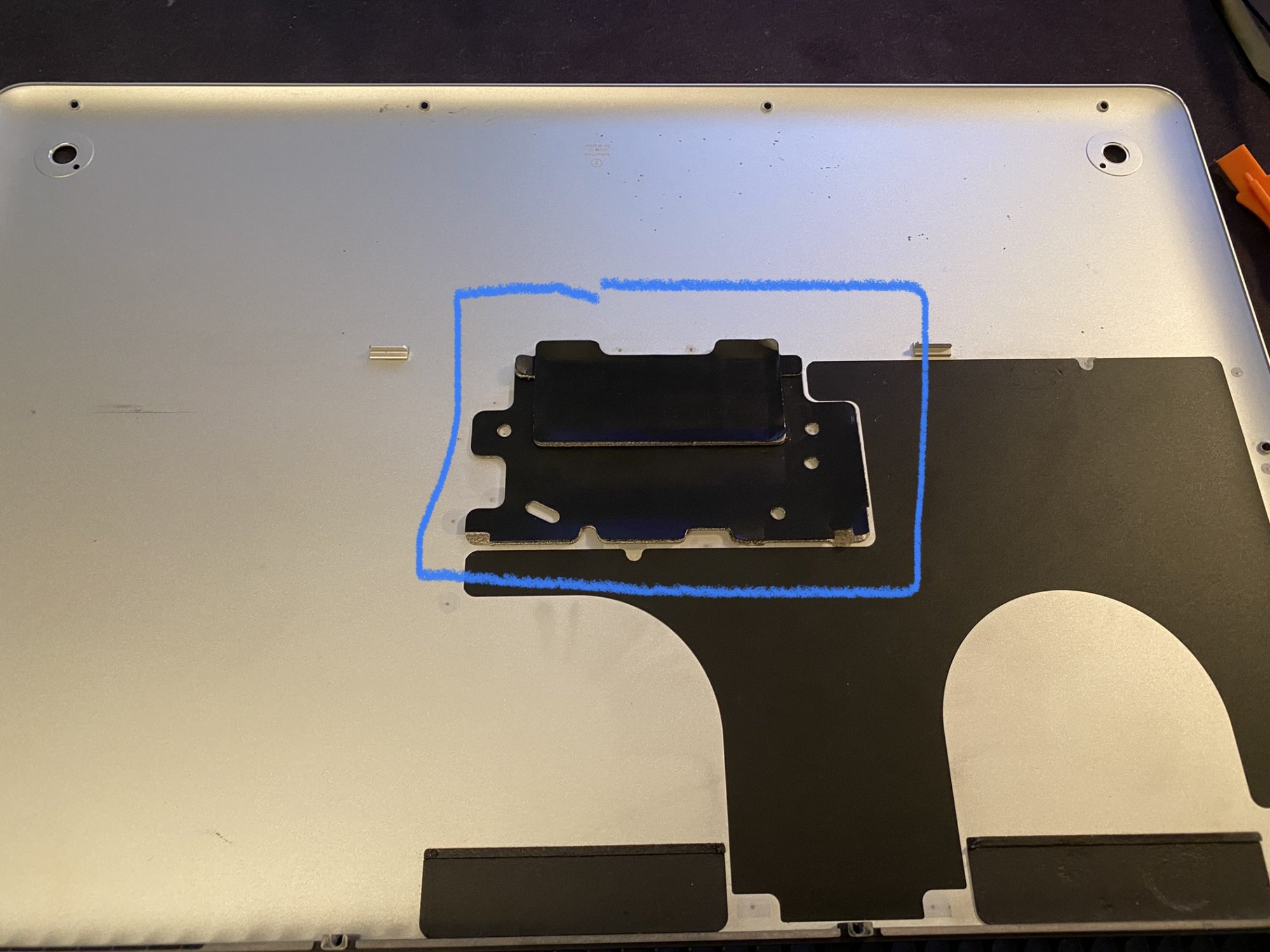

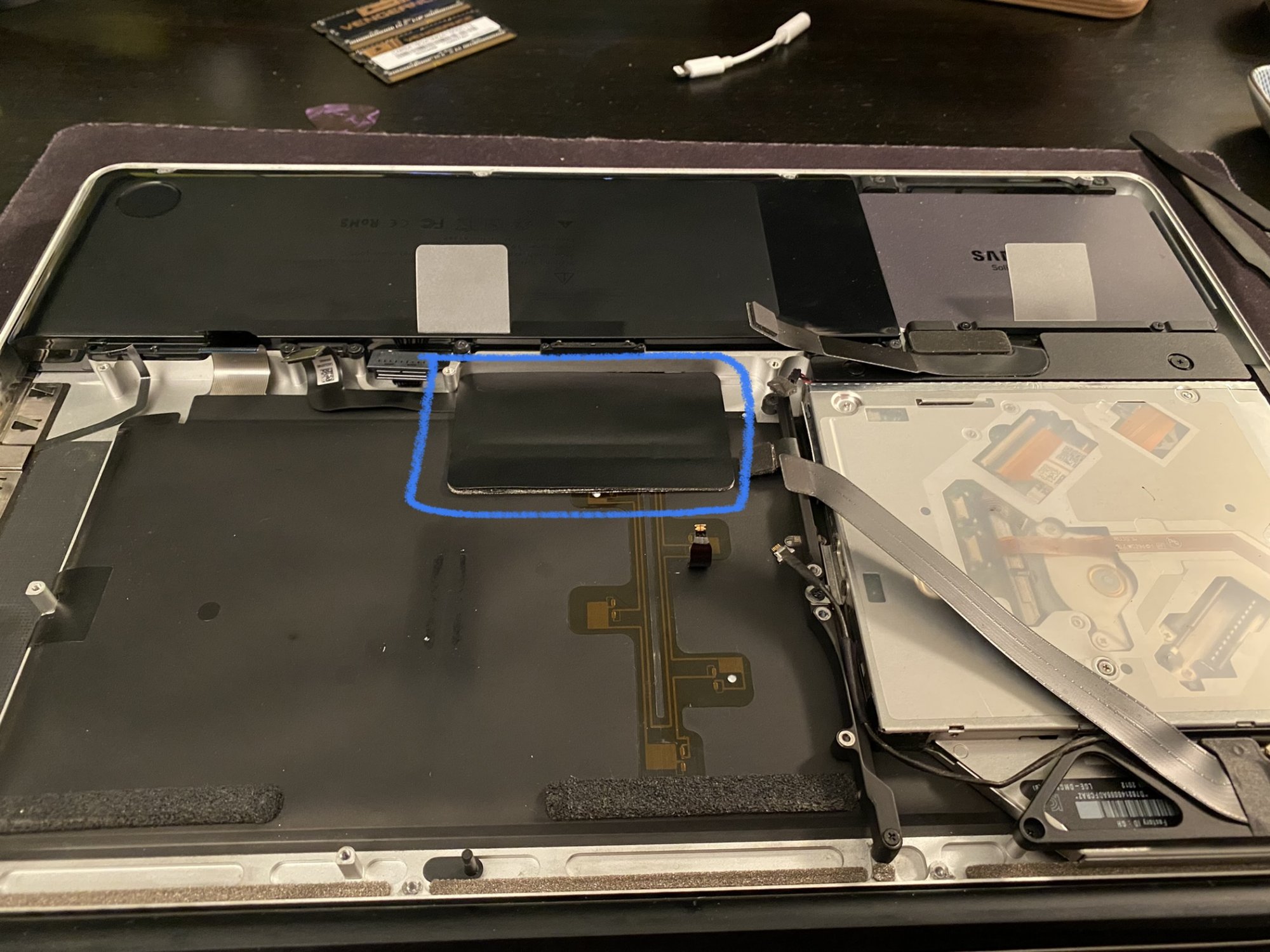

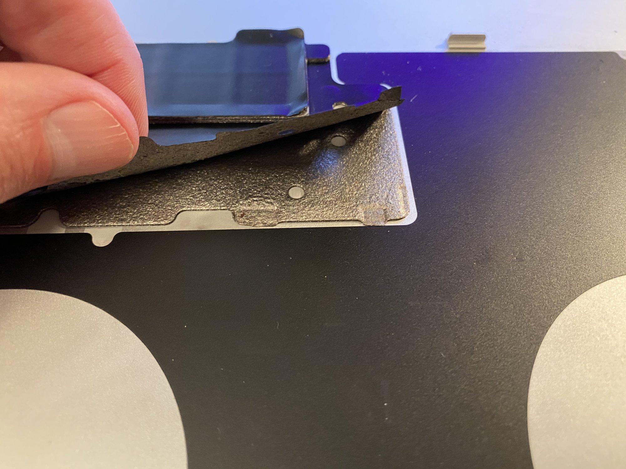

Hello people,
I’m hopping in.
I am battling with some bad smell / stink with my unibody 15inch MacBook Pro Mid 2012 since quite some time.
I’ve read the body odor smell problem, but not quite sure if that’s what is meant.
As of now I’ve changed the old battery. It was time and getting really hot in there. After changing the Temperatur dropped by 20*C
I‘ve changed the thermal paste, since I read it causes the smell. And it was old and time too.
Today I am changing the fans since bearings are making noise and can cause smell when wearing out.
Next I would like to clean keyboard/backlight since there’s all the gunk of 10years of usage which definitely would not smell like unicorns.
And I will replace the ddr3 memory modules since these smell too.
Which brings me to my question:
👉 Can anyone give me some guidance on what is shown in the pictures?
It is some piece of foam(?) and is located right on top and below the ram modules. Pressing firmly into the modules.
They smell pretty bad. (I’m wondering if they cause the smell or the memory modules cause the smell)
Also they seem to peel off.
My guess is, that they are some form of heat spreader and begin to smell when getting too hot.
I think that the system got too hot at some point in the past decade and the materials just wore of.
👉 Could they be the cause of the smell and can they be fixed, replaced or safely removed?
Reactions: toniepadius
I’m pretty sure the smell comes from the foam pressure pad on the bottom case (and the one under the logic board, if applicable) that rests against the RAM modules. Both the foam and the adhesive are degrading after all these years and one or both emits a foul, slightly acidic smell. This is not unheard of in polymer chemistry but undesireable nonetheless. You can replace the patch with a different pad of similar thickness, as long as it’s non-conductive and does not generate static electricity. Or just remove it and accept the slightly higher risk of memory slot failure (which is what the pad is supposed to prevent).
A venting battery is usually a much quicker (and more violent) reaction so I don’t think it is related to that. Though, if your battery is swollen or indeed venting, you might find this iFixit guide useful for safe handling.
