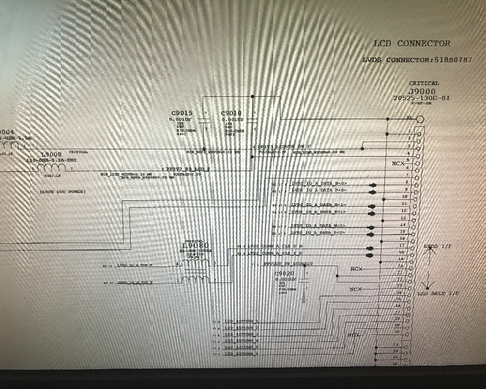

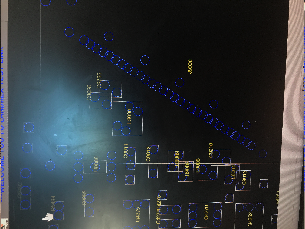

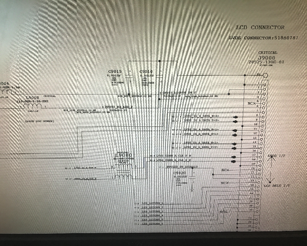

L9000 have 3.3v?
holy crap! Im a little start struck!! Ive been watching and listening to a heap of your youtube videos!! Listening to them whilst i drive around for work prove very entertaining!- thanks 🙂 - and i think i have found the right video for this.. ill report back once ive had a look!! 🙂
L9000 have 3.3v?

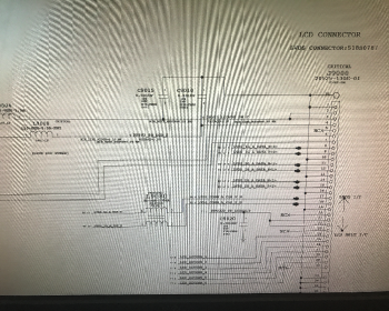

Hey Louis IMG_2874.png IMG_2875.png , Ive been scouring everything for so long trying to find this damn 'L9000'.... Any chance of a hint? Heres what ive been looking at... The closest i get to is L9004.. :-( I know you're a busy man but even a hint or a clue would be great... im willing to put in the work but im at a dead end.. sorry!🙂

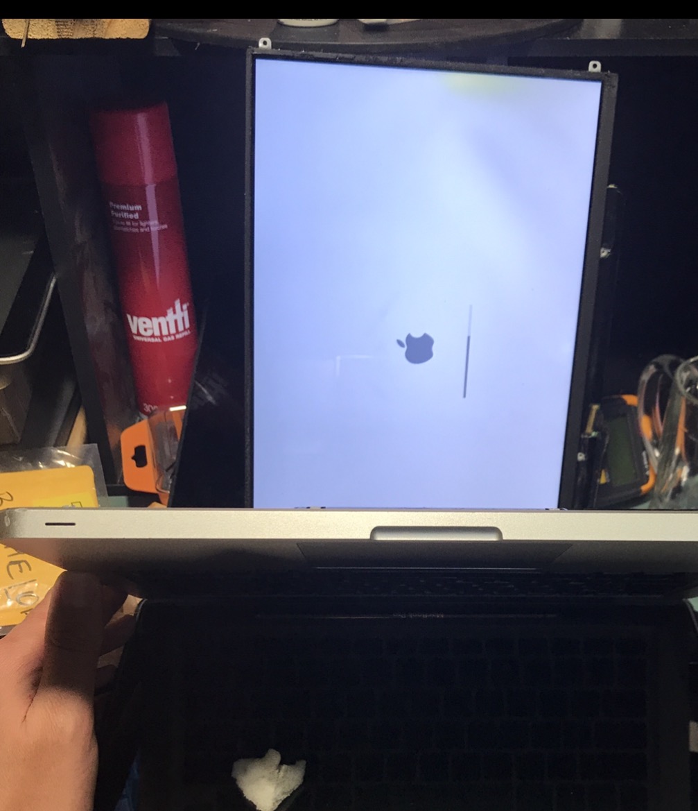

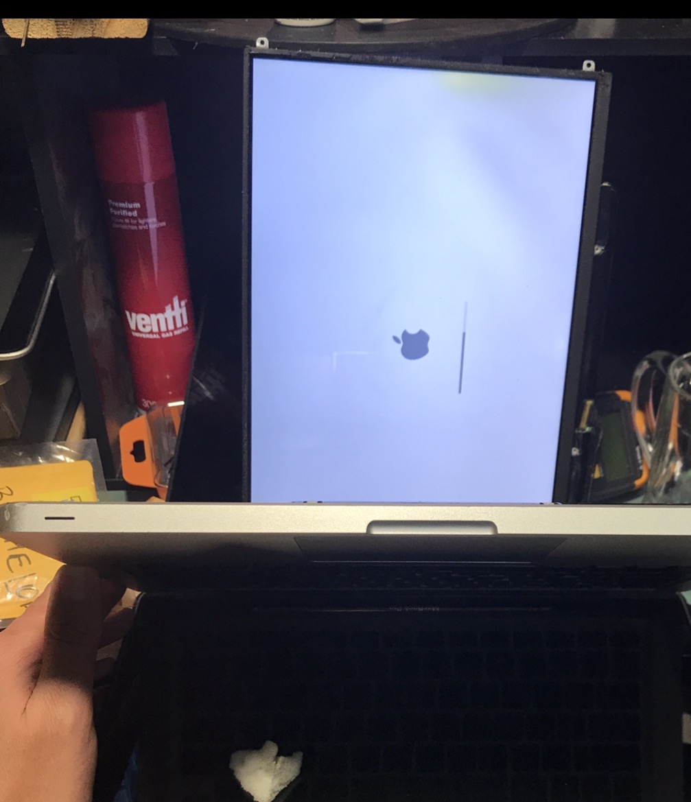

Ok so the screen is fine - as per the pic! I'm guessing it's something logic board or GPU related....
