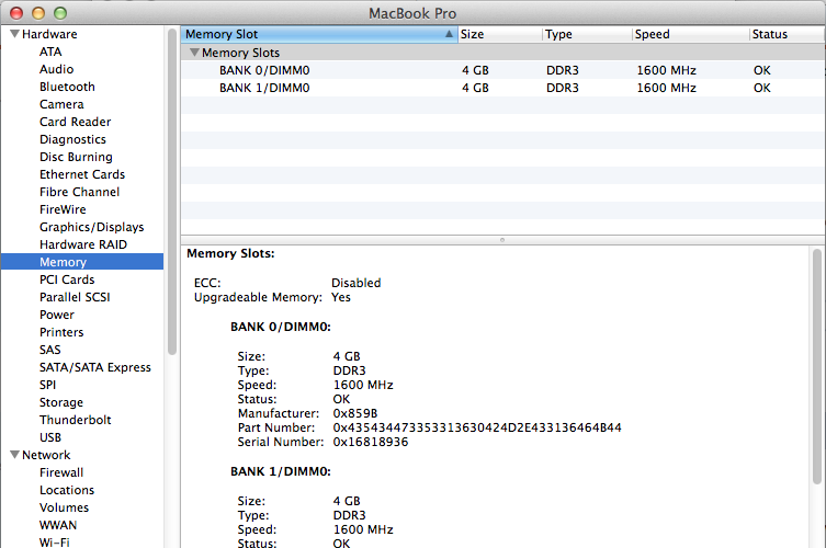

If the MacBook Pro only has one stick of RAM installed (being a 4GB stick), then you could add another 4 GB in the other remaining slot. If not, you'll have to buy an 8GB pair. I actually use a 2012 non-retina MacBook Pro as well, and this is the exact kit I used to upgrade my RAM: https://www.amazon.com/Crucial-PC3-...e=UTF8&qid=1511753627&sr=8-7&keywords=Mac+RAM.
To check how many RAM slots you have occupied, under the Apple logo, click 'About this Mac' and click on 'More Info'. Then click 'System Report' and highlight the Memory tab. Just for reference, I attached a screenshot of what mine looks like.

If it is factory spec and hasn't been changed, it will have two 2GB RAM modules in the machine because Apple recommends equal amounts of RAM in each slot.
You will need to buy two 4GB RAM modules. The specs are on these link below.
https://support.apple.com/en-us/HT201165
Despite the information on the page, the actual maximum is 16GB. However, most people will only ever need 8GB.
For 4gb, the current configuration is almost certainly two 2gb DIMMs.
For 8gb you could buy 2 4gb DIMMs.
Or, buy ONE 8gb DIMM, replace the topmost DIMM (after you take the back off), for a total of 10gb. Supposedly, "unmatched" DIMMs (in size) don't run quite as fast as do matched DIMMs, but I'll bet that she (and perhaps even you) won't notice any difference.
