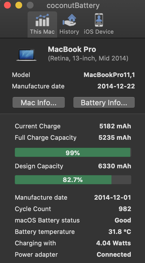

I have a mid-2014 Pro 13" (i5, 8 GB, 128 SSD, 982 battery cycles, healthy according to system report, 5173 mAh capacity, healthy, bootrom 157.0.0.0).

All this leads me to conclude it must be the battery. Or am I missing something else?
