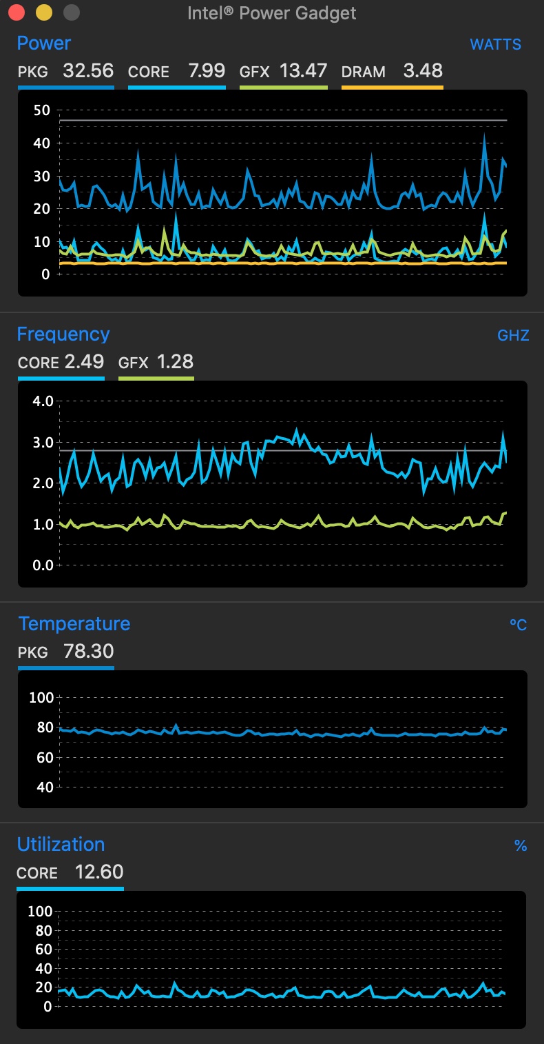

Thanks for the info @leman! I ran a test tonight where I let a Youtube video run in Safari with no other windows open. As seen in the IPG graphs below the temperature averages about 78C. While I didn't get a very noticeable fan ramp-up like I have before, frankly I still think this is too high considering the <20% average utilization. Ambient temperature in the room was 21C. Graph I believe is about 2-3 min of data @ 1 second intervals. Also this machine has the i7-4870HQ i7-4980HQ processor w/ i+dGPU.
Regarding power consumption, it's at the lower end of what you mentioned. Disregard the spikes at the end as this was me opening up Screenshot. I think it would be fair to say I expect the temperature to average out ~10C lower in this case, or would that not be reasonable?
@MZ3Alex I'd say that your screenshot clearly shows high single-threaded CPU utilisation. The CPU power draw is 25-30Watt and the CPU is also boosting. I don't think that there is anything wrong with your machine to be honest. Could you run Cinebench to check whether your scores are within the expected range (just to verify that the performance is fine)?
