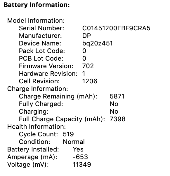

Hi, the last couple of months my MBP battery has been a pain in the ***. At about 35% the MacBook turns itself off, and when I try to restart it, it shows the battery as 0%. Also, it only lasts about 2 hours on a full charge. This would't be weird if my battery had loads of cycles, but it only has 519 cycles on it (see screenshot). It shows battery status as OK, but it's far from OK and makes my MBP really unreliable. Also, when plugging it in, the percentage wil jump around like crazy. Can anyone help me with this? I don't think its the battery itself, but more like the battery management system that's doing some weird things.
This video shows what happens
Your battery is 5 years old so even with < 1,000 cycles it ca be bad. I would take it to get looked at (could be the motherboard) before Apple marks them as vintage and won't service them.

It's really weird, I did a SMC/PRAM reset, charged to 100% and left it plugged in for 2 hours. After that I drained the battery and left it drained for 5 hours. Unfortunately still no result. I also don't want to pay a hell of a lot of money for a 6-year old MacBook to be fixed, I'm just a poor student😅... What would be the most cost-effective thing to do here?
It's probably around $200 to get a new battery put in. It is possible to do yourself for less, although the quality of the replacement batteries isn't as good, and the replacement process itself can be a bit tricky due to them being glued in.
If you do it yourself and then found the battery to be a dud like many others have, Apple will charge you more for the replacement.
My replacement with a 3rd party battery was going to be £401 instead of £199 as they weren’t getting their own battery back...
