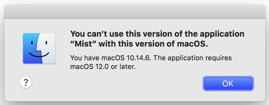

I'm composing this reply on a 2018 Mac Mini running Mojave (which is "later than" High Sierra).
When I try to launch Mist, I get this:
It requires OS 12 or later to run.
Well, ok.

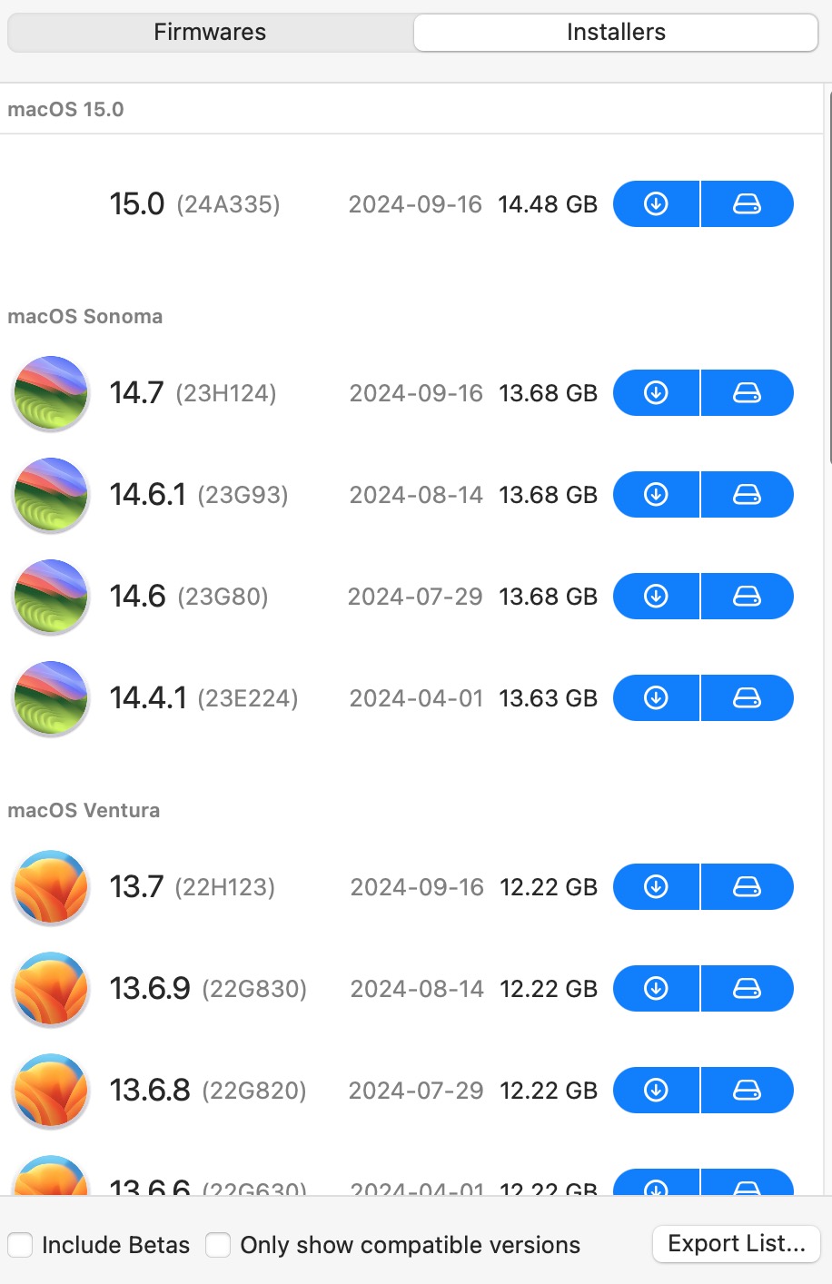

I break out my 2021 MacBook Pro, which is running OS 14 Sonoma.
Open Mist.
It will first "update", and then display a long list of both firmware and downloadable OS's.
IF it can also download and create a bootable installer in one operation, it will ALSO display that, as well.
Here's "the upper part" of the list:
You can see that Mist can create bootable flashdrives from these [later] versions of the OS.

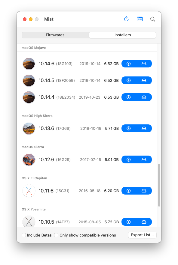

Now, if we scroll down to older copies of the OS, we see this:
Note how there is an option to download the installer, but NO option with which to also create a bootable flashdrive.
So my advice to the OP about using Mist to download the OS and also Install Disk Creator (or DiskMaker X) to create the flashdrive stands.
If you have "postable evidence" to the contrary, please post it.

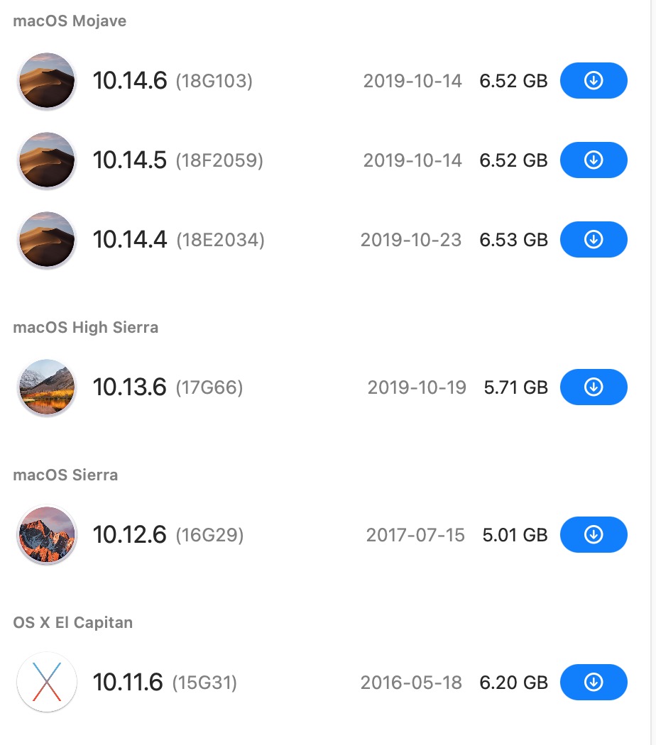

The confusion appears to be due to Mist behaving differently depending on whether you run it on an Intel or AS machine. On an M3 MBP running Sonoma, Mist 0.20 doesn't offer to create a HS USB, whereas on an Intel MBP running Monterey it does. I'm guessing the difference is the hardware rather than the host OS, but verification would require that I update the Intel machine, and... no.
