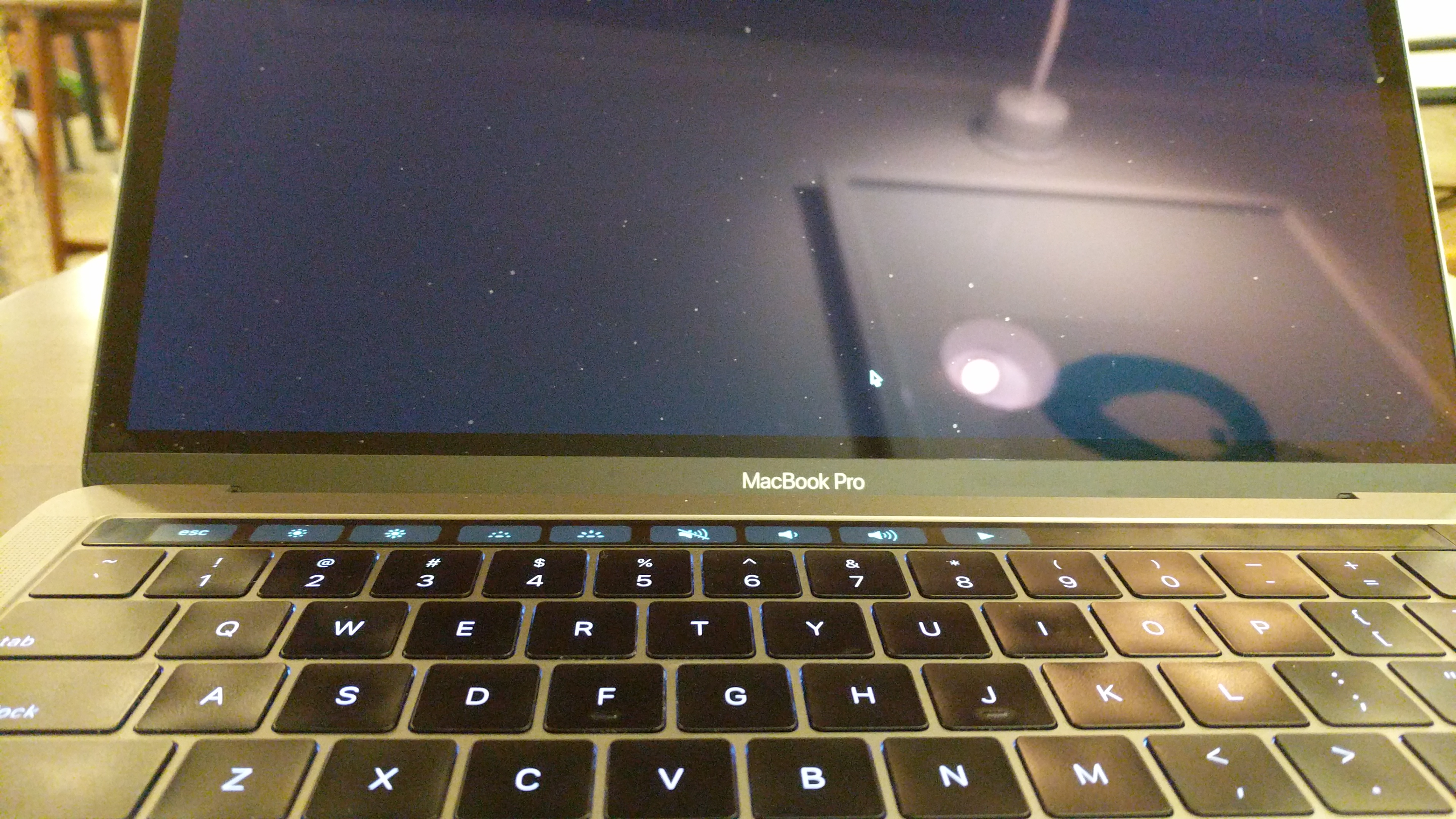

I'm having the same issue! I can see my cursor and I hear music and OS sounds. 🙁 This has been happening all week!
