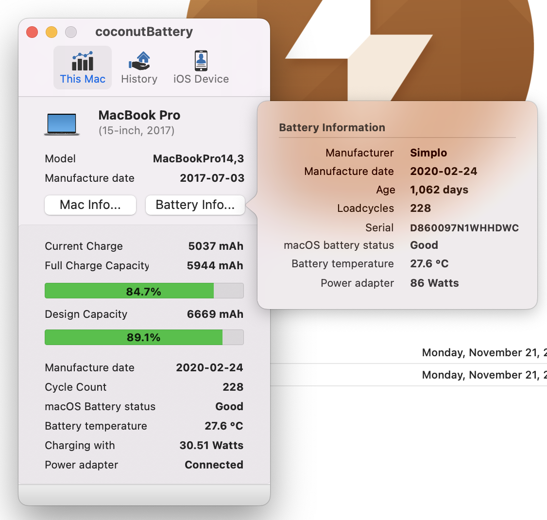

Have not heard of it before but installed it and here is the status. Thanks.
The battery looks OK based on coconutBattery if I read it right. I'm looking for how to calibrate a mid2017 MacBook Pro. Thanks.

Bad cells can 'look' ok, and will just die.
True. It's like SSD and HDD. On SMART it might look fine but it can just die or corrupt your data . Most of the times those tools will let you know that something is wrong. But sometimes it won't

Things like Coconut can’t tell you battery health factors such as internal resistance.
Capacity is only one measure of health. If the aged battery cannot output current fast enough, the device will shut down regardless of capacity. It’s like a kettle with a plugged spout. Cold temperature increases resistance and lowers capacity.
Cycles alone doesn’t tell you the full battery health picture. You need a battery replacement.
It seems the battery drains fine when open and in use and discharges rapidly while closed but not shut down. Thanks.
Seems premature for that new of a battery to fail, but I’ve seen this before on even new batteries I put in. I immediately swap out the battery and return the one that crashes the machine as defective. It’s 99% of the time the battery.
Yeah. You can calibrate all you want but if the internal resistance is too high. It's not gonna run correctly. Like my old MBA 2014 battery has an acceptable amount of capacity left. But because of it's high resistance, it can't handle high currents. It likes to trigger the low voltage protection circuit when you take high currents even though it's at 100%
