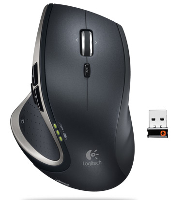

i had the same problem but that little remedy stops working one day so i would say to you is get a logitech performance mx wireless mouse they are freaking awesome,it has one touch search and 4 buttons that you can customize i love apple products but their mouse is not that good,i have a mac with a non apple back Lit keyboard and a non apple mouse 😛
