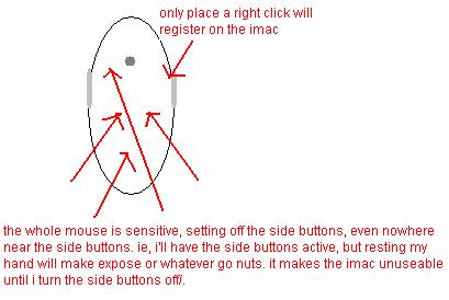

The whole mouse is crazy sensitive. Even JUST touching the right side, the right click just barely works above the right side button. And I mean just above it. When my hand is just resting on the mouse, it's making clicking sounds like crazy and if I have the buttons active, it makes the iMac unusable. This is with both the original mighty mouse, and the replacement Apple sent me. On two different PCs, the right click is fine, and no clicking sound just resting on the mouse.
Something's wrong with my iMac. I need to know if there's a way to reinstall MM drivers, or should I re-install the entire OS. Normal clicking works great, it's just a pain in the ass. I paid good money for this computer, I want it to work.
