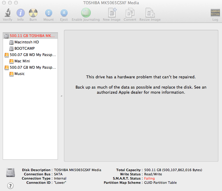

I suggest you launch Disk Utility, and then re-initialize the internal drive.
Does it re-initialize without problems?
If you get that far, I suggest you next run DU's "repair" button on it.
Does DU report the drive is ok? Or not?
If DU reports ok after one pass, I suggest you run six more "passes".
Does DU report each successive pass as being ok?
If that's the case, it leads me to believe that your problems with the internal drive were software-based (i.e., perhaps directory corruption, or corrupted or missing files with OS X), and that the drive may still be functional, "hardware-wise".
If you get this far, you might consider using CarbonCopyCloner to "re-clone" the contents of your external (boot) drive back over to the internal.
Even if you no longer trust the internal to be your "primary" drive, it can still serve as a "bootable backup", or a "scratch storage" drive (i.e., a drive on which to store things you may want to keep around but would not be afraid to lose if the drive failed)
See attached screenshot. Disk Utility does not give any options to repair the disk.
The disk has a smart status of failing. I suspect it's either the reallocated sector count, I don't know what is typical, or the 1.14 million load/unload cycle count. I don't know what the stock Toshiba is rated for, but he new WD Black drive I got to replace it is rated for 600K cycles.
I plan to use DU to clone the external to the new drive and then use the external for either time machine backups or have regular clones made of the new drive.
My only concern at the moment is how up to date the 10.8.4 install from the Recovery HD is in relation to what the App Store software update thinks. I am reluctant to run the update due to not knowing if there are "missing" updates that need to be installed first.
