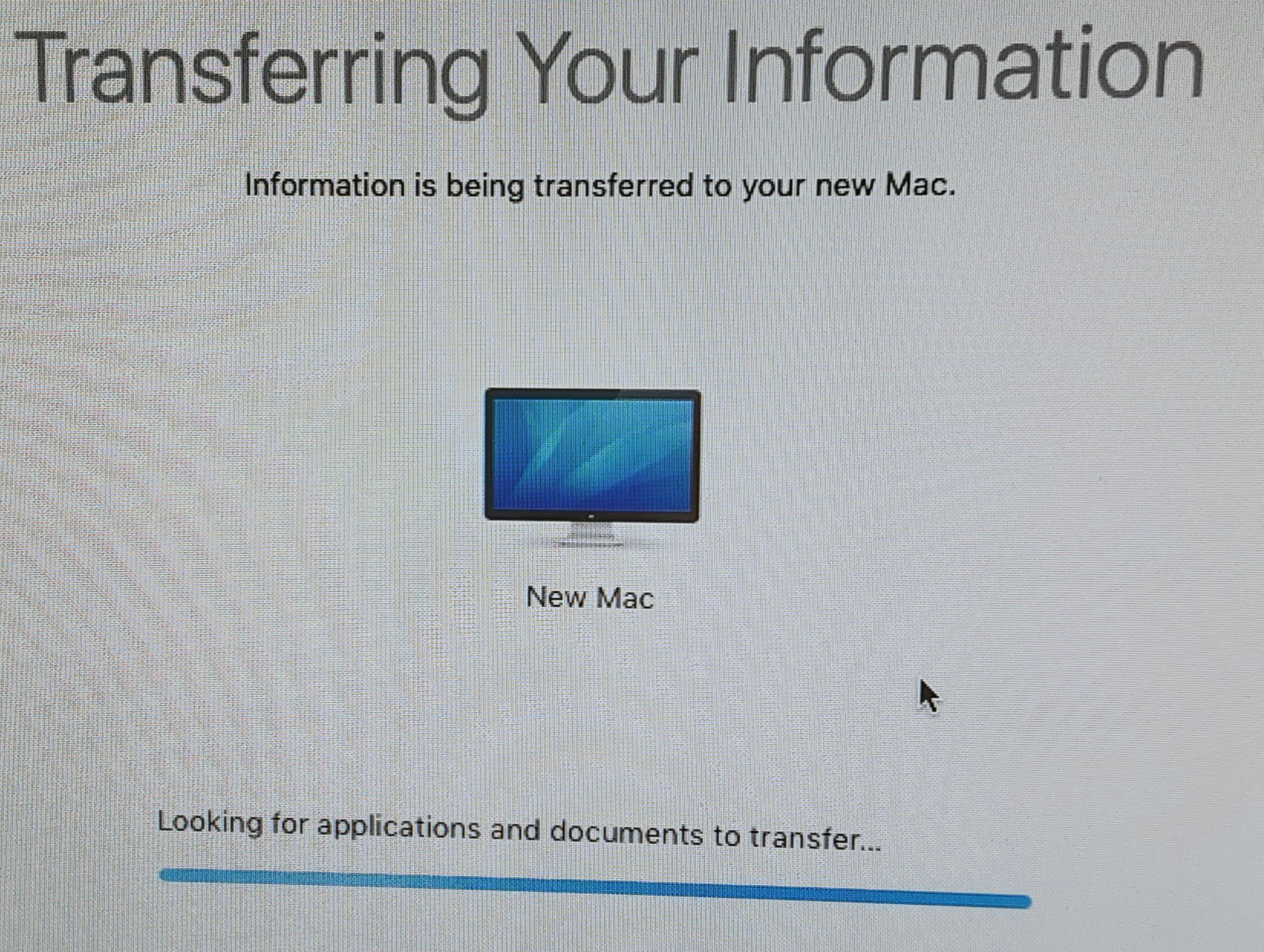

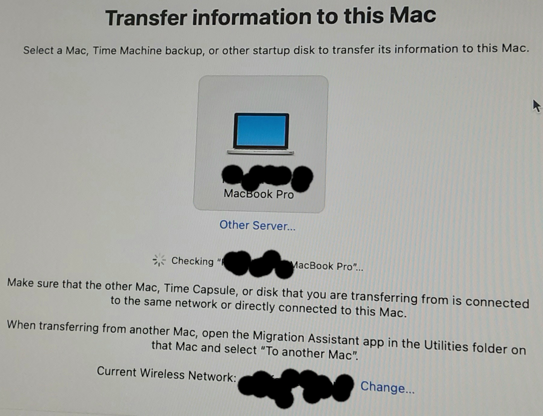

I am using Migration Assistant to transfer from a 2010 MBP to a new MBA M1, it has been about 5 hrs now. Not sure if this is normal. See screen grabs from both laptops. I just blacked out my name on the new Mac. I did turn off the firewall on my old Mac before starting. Is it working or stuck?

Looks as if is still searching for items to be transferred. I'd call it a hang.
How are you transferring the data? From a Time Machine backup or ... ?
I had my old 2010 Macbook Pro connected to the same home network as my new mac but after 6 hrs I decided to stop it. I was thinking maybe I should buy an adapter for my current external hard drives for the old system and try to transfer files this way. Is this a better option.
In the past, I've found that it works best to make either a Carbon Copy clone or time machine backup to an external disk on the old Mac, then connect that disk to the new Mac.
