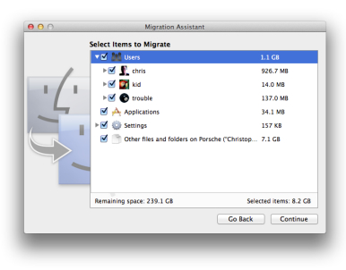

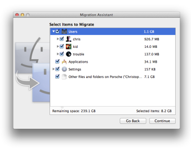

When you begin the migration there is a screen that comes up asking what you want to move over.... are you checking everything on that screen?
It looks kinda like this.
Looks just like that. Could it be Little Snitch?
If you followed the steps we discussed and ran the import during system setup, Little Snitch would not even be running or installed on the iMac, so I don't see how that would do anything.
