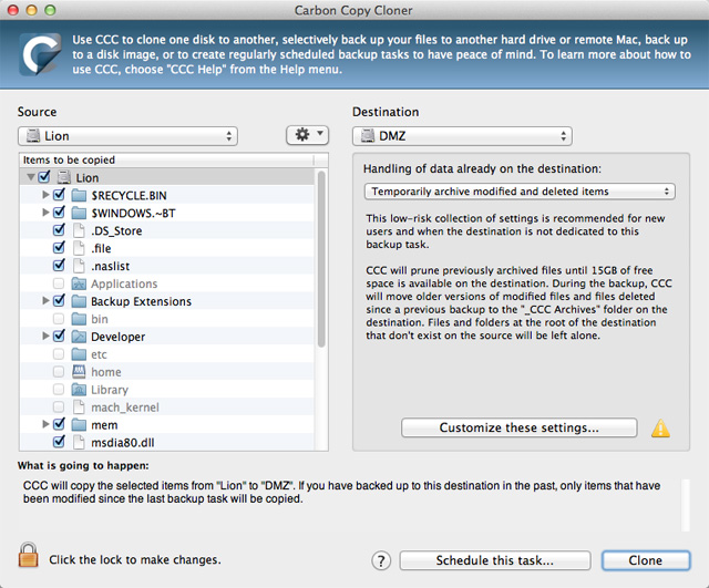

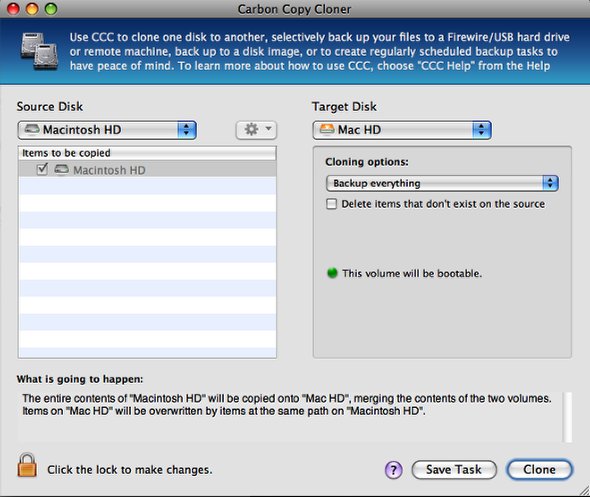

Now question about step #7, I cannot find an option in CCC (trial version) where I can create am image/clone of full HDD. When I select my HDD on source and any other drive/usb key on destination, it always shows me that "selected files will be copied....". Nothing about full bootable system image, etc... Is this normal? Can this be because I do not have a destination disk with required capacity and formated as MacOS Journaled plugged in?
I foudn the following screenshot on the web, but I cannot get my version of CCC to show me the same:
Whenever I select my HDD in the source, I'm always getting something similar to the screenshot below:
Can someone please explain how to make a proper bootable clone of HDD to SSD using CCC 3.5.2?
