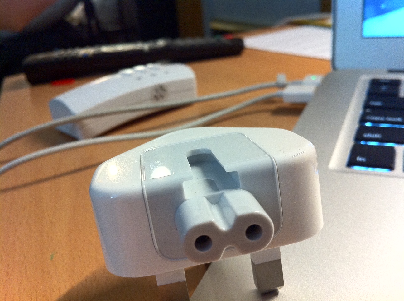

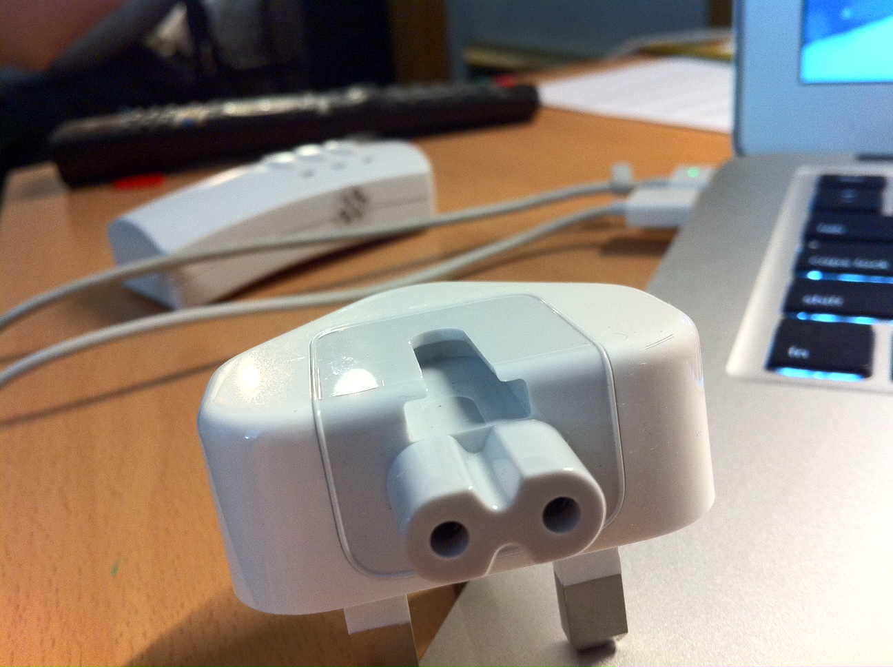

Yeah, but it's missing the metal contact on the plug bit making that metal button completely useless.😡
