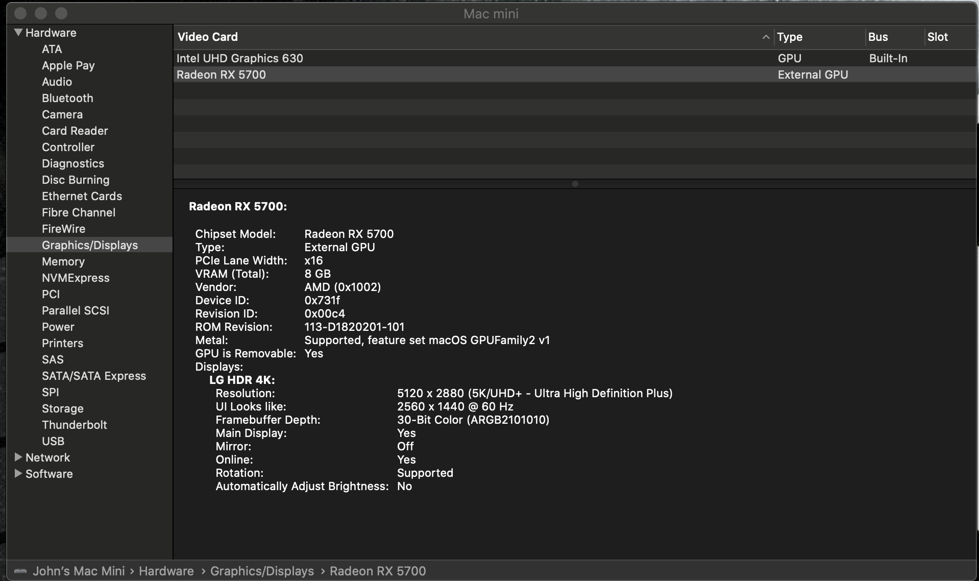

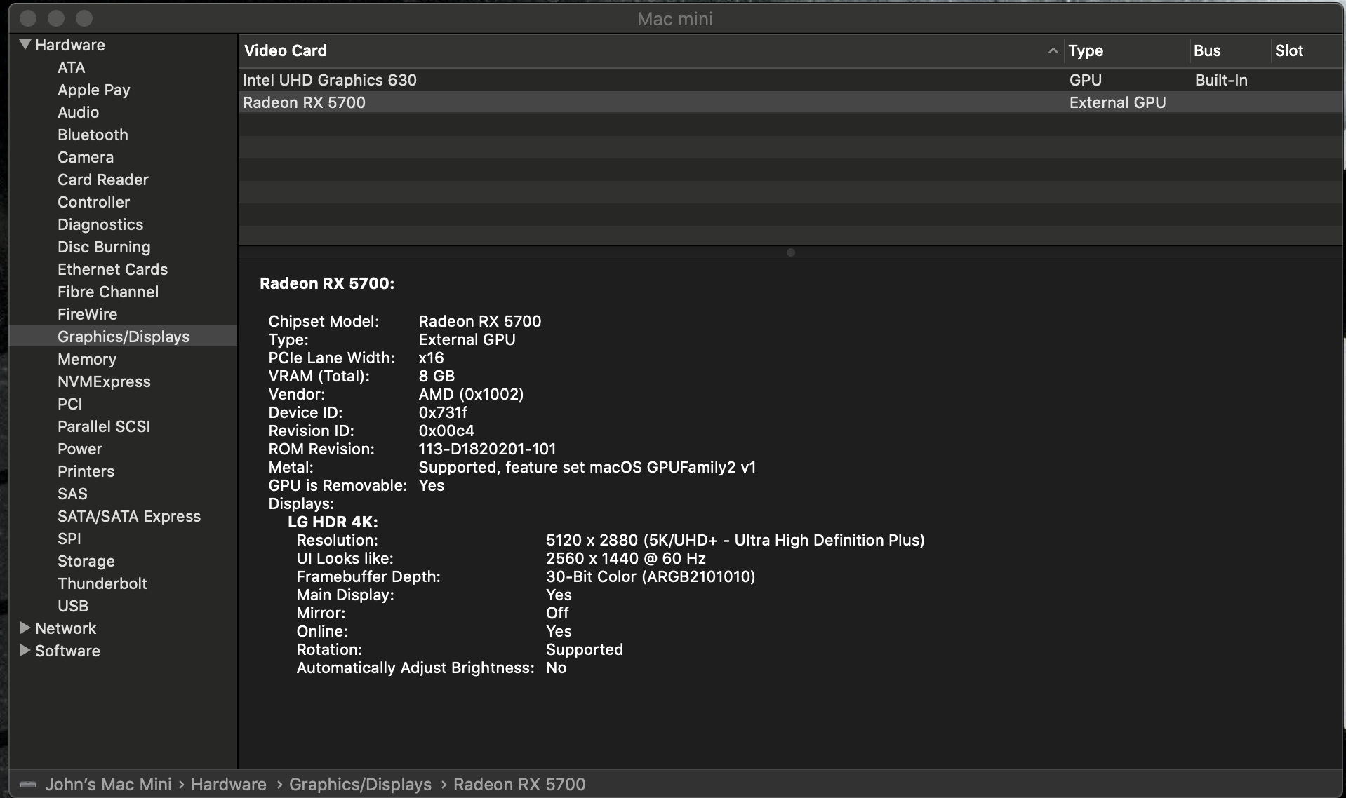

Upgrading my Sonnet 350 by putting in a 550W Revolution SFX power supply and updating my graphics card from RX 580 to a RX 5700. It booted right up to login screen perfectly.
AMD Radeon RX 580 - Metal Score - 33074
AMD Radeon RX 5700 - Metal Score - 39885
I have not stress tested the GPU yet to see if it's stable but it seems to work okay, so far.
Radeon RX 5700:
Chipset Model: Radeon RX 5700
Type: External GPU
PCIe Lane Width: x16
VRAM (Total): 8 GB
Vendor: AMD (0x1002)
Device ID: 0x731f
Revision ID: 0x00c4
ROM Revision: 113-D1820201-101
Metal: Supported, feature set macOS GPUFamily2 v1
GPU is Removable: Yes
Displays:
LG HDR 4K:
Resolution: 5120 x 2880 (5K/UHD+ - Ultra High Definition Plus)
UI Looks like: 2560 x 1440 @ 60 Hz
Framebuffer Depth: 30-Bit Color (ARGB2101010)
Main Display: Yes
Mirror: Off
Online: Yes
Rotation: Supported
Automatically Adjust Brightness: No
eGFX Breakaway Box:
Vendor Name: Sonnet Technologies, Inc.
Device Name: eGFX Breakaway Box
Vendor ID: 0x8
Device ID: 0x30
Device Revision: 0x1
UID: 0x0008DCF8B482B500
Route String: 3
Firmware Version: 25.2
Port (Upstream):
Status: Device connected
Link Status: 0x2
Speed: Up to 40 Gb/s x1
Current Link Width: 0x2
Link Controller Firmware Version: 0.36.0

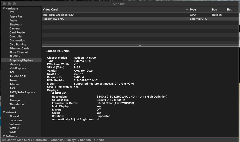

I noticed you're running your setup with an LG Ultrafine. How are you getting your GPU to run the LG Ultrafine? Did you use an alpine/titan ridge card?
I have no issues with the GPU and LG. I am using the HDMI cable that came with my monitor.
