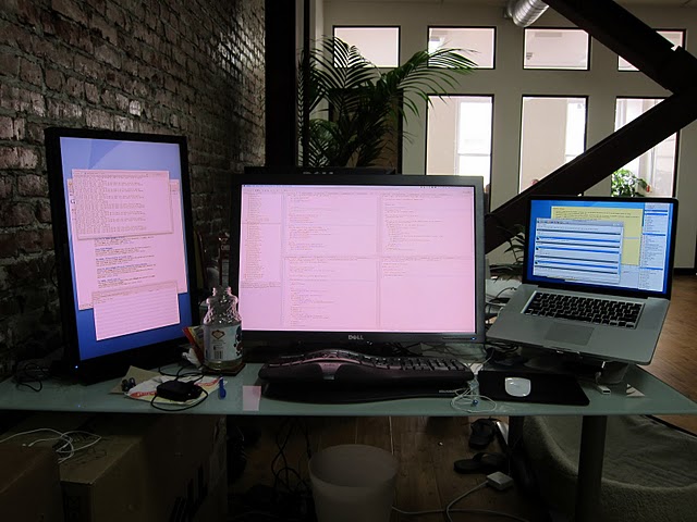

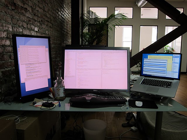

Macbook Pro 17" - driving 3 monitors (1 laptop + 2 external)
I have a 17" macbook pro (core 2 duo version). I'll be driving a 30" Dell 3008wfp (2560x1600) and a 24" Dell U2410 (1900x1200).
The macbook pro's mini displayport can drive the 30" dell using a mini displayport to displayport adapter since the 3008wfp has a displayport built in.
I'll be driving the 24" Dell U2410 with an external USB video "card" using DVI. It's a device that runs solely out of your USB port (no power cables etc) :
http://www.geeks.com/details.asp?invtid=ITV-101&cat=CCD
It plugs into your USB and it provides a DVI out. Hence, I'm plugging my 24" directly into the DVI. It works! Best part is, it's relatively cheap. Around $60 shipped. Even better is that you can get up to 6 of them apparently, though I'm not sure how many you can plug into one usb hub. You may need to do it port by port for the bandwidth. Shrug. I only have 1 so I can't test it out.
As long as you're doing 2048x1152 or 1900x1200, this $60 device will work fine. If you want to go 2560x1600 or 2560x1440, you can only drive that via the displayport.
At least with this device, you can also reuse it - doesn't have to be just on a mac.

Screenshot
Here's the pic of my 17" MBP on the right, the 30" being driven via the mini displayport, and then the 24" on the left via the external usb video thing I mentioned earlier.
The 17" can run up to 1920x1200 but I don't set it that way.
The 30" is at 2560x1600
The 24" is at 1200x1900 (or 1920, i don't remember)
