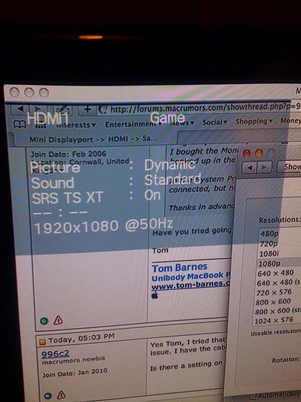

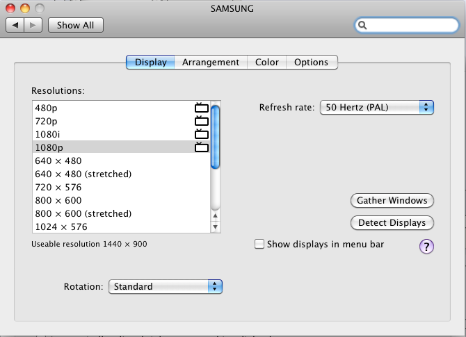

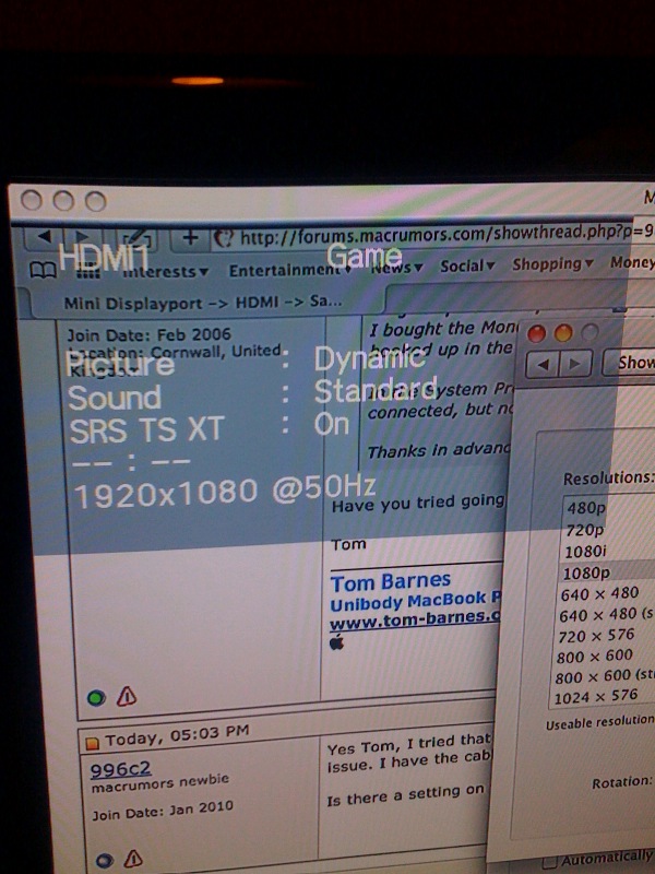

Hmmmm, well I have a Samsung TV LE40A559P, and I have been using my monoprice HDMI connector for ages. I know you are running Leopard, but it used to work fine when I had leopard. I sholdn't think the hertz setting should make much difference. Here are some screenshots of what I have going on...
I'm not sure if these screenshots will be of much help. As I remember, when I first plugged it all in a few months ago, it was pretty much plug and play except for setting it to the correct pixels for my TV - I settled with 1080p as that is really the best.

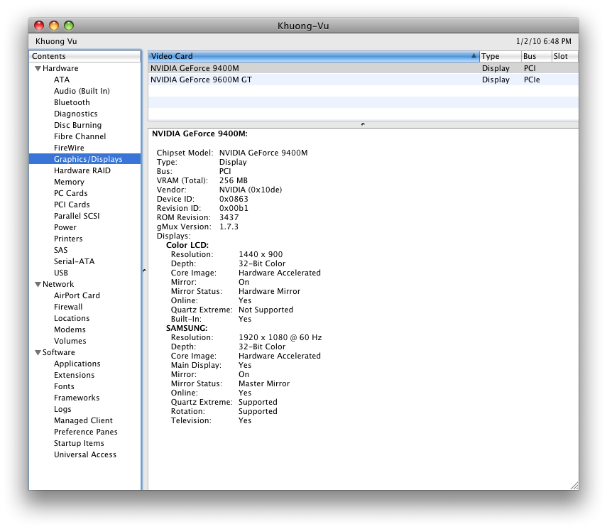

Further to my last, which I am sure won't be much help, does the Samsung TV show up in System Profiler?

I don't have the same resolutions options as you do with the 1080p.

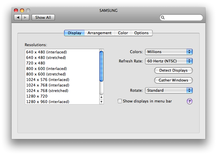

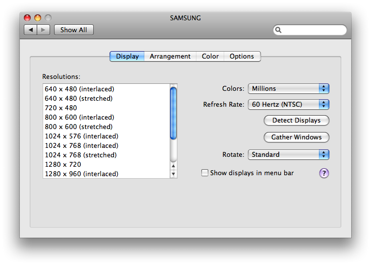

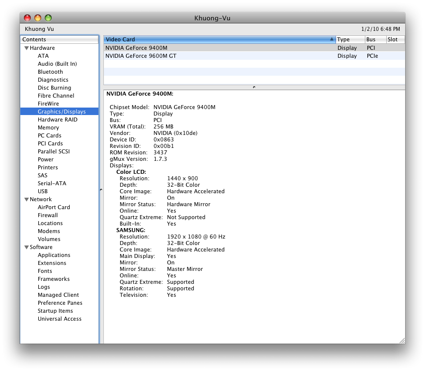

In my system profile, it shows:
attachment.php
This remains a BIG mystery to me. Thanks Tom for the screen shots.
