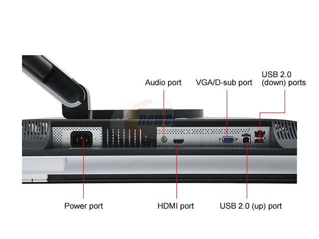

Do you think Apple will make one of these adapters? I'm thinking about getting a Monitor, this one, for my MacBook and the only digital input it has is HDMI.
Another question, do you guys know how exactly the USB ports work on this monitor? I want to be able to hook up my mighty mouse and keyboard to this monitor so I can have as little amount of cords as possible running into my MacBook, but I'm not sure I understand what the USB up and down ports are.
Would I just plug in my mighty mouse and keyboard to the down ports, and the up cord runs to my MacBook's USB port? Is it that easy or do I have it wrong?
Thanks for any help.

I'm guessing the USB (up) port is USB-B or rather the one's frequently used for printers and the USB (down) is USB-A the ones used by everything else.
I wouldnt recommend plugging your keyboard in to the monitors USB hub if you use bootcamp or any of the other key startup commands.
I did this with my monitor for a but couldnt do startup disk selection, I realised that it was because the monitor was turning itself off when it didnt detect a signal but would also turn the usb hub off. By the time it detected a signal and turned the hub on, my machine had already booted!
As to the connection, it looks like mini DisPort --> DVI then DVI --> HDMI cable is the best option.
EDIT -
The USB up port connects to the Macs USB port (using an A->B cable) and the USB down ports connect to your peripherals.
No... The USB 'up' port is where you would connect your Mac to. The monitor then has a small USB hub in there, and the USB 'down' ports are where you connect your mouse/keyboard etc.
It's the same on my Dell 2407WFP monitor.
Thanks for clearing that up!
