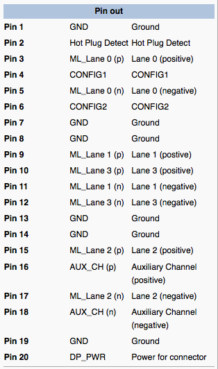

Curious... How is the OP gonna get analogue Component signals from the Digital only based mini DisplayPort???
Specs, see attachment.

This isn't going to work.
Long answer: VGA is an analogue RGBHV signal. Your TV's component video input (in all probablity) is only Y/Pb/Pr (unless you have one of those odd TVs accepts multi RGB ins). These signals are not compatible.
What the cable on Amazon is meant to do is to take a component out (or RGB) of a video device and connect it to the VGA in of a project. Most projecters can do this because they're set up to accept component or RGB over d-sub.
What this cable won't do is covert your VGA (RGB) signal to component (TV) video, unless your TV is set up for it and your TV in all probability, is not. The signals are similar, but sync differently.
Short answer: No. Don't bother.
