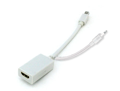

What we really need is for a company to come out with is something like this:
Mini DisplayPort + Mini Optical Cable -to- HDMI
Mini DisplayPort + Mini Optical Cable to HDMI
Meh, even better...
male Mini DisplayPort + male Mini Optical -> male HDMI
All in one CABLE, not an adapter that looks ugly next to my nice computer 😛
LOL nice photoshop. here's to dreaming... one day... one day. OR, apple could just firmware update....
