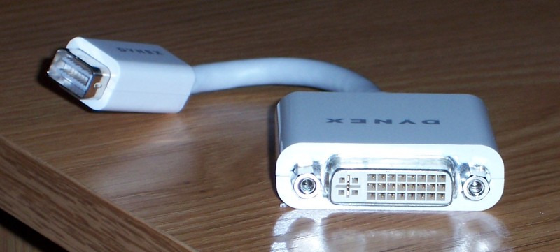

The DVI to VGA adapter never ended up working in the end. It detected that there was a monitor but it never displayed anything.

The Dynex DVI-I with a VGA adapter doesn't work at all in Bootcamp.
Ohhhhhh wait I bet I know what's happening. The Dynex mini DVI -> DVI connector likely drops the analog pins and only bothers remapping the digital ones. It probably assumes the destination signal will be DVI and thus there is no point in transmitting the RGB and other necessary signals for analog VGA.

Absolutely. See, the mini-DVI to VGA cable likely transports only the signals needed for the VGA signal. If you can find a generic mini-DVI to DVI adaptor that doesn't drop any of the signals, that would work for both straight DVI as well as for analog by adding a DVI-to-VGA adapter on the end of that.
Best recommendation is to just eat the cost of buying a mini-DVI-to-VGA adapter to get the job done.

Ok, I don't quite get it... You bought a mini-dvi to DVI-I adapter, but it won't let you add a DVI to VGA adapter? Like this one:
Cuz I've been looking for the DVI-I for ages already.. 🙁
Yup, that's right. It won't let you add a DVI to VGA adapter.

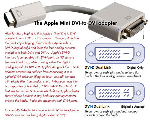

The adapter you took a picture of, although looks like it is transmitting DVI-I, is actually dropping the non-analog pins. It's just as bad as Apple's.
Well...maybe not: the only advantage to having a female DVI-I side, is that if, say, your trying to connect your Mac to HDMI, then with your adapter you could still use a DVI-I to HDMI cable whereas Apple's adapter will flat out reject it (they filled in the analog holes). 😉
That is, as you can see here:
It's worth noting that with Apple's adapter one can connect a DVI-I to HDMI cable granted one has a DVI-D male to DVI-D female adapter, as mentioned above. But that's yet another adapter... 🙂
