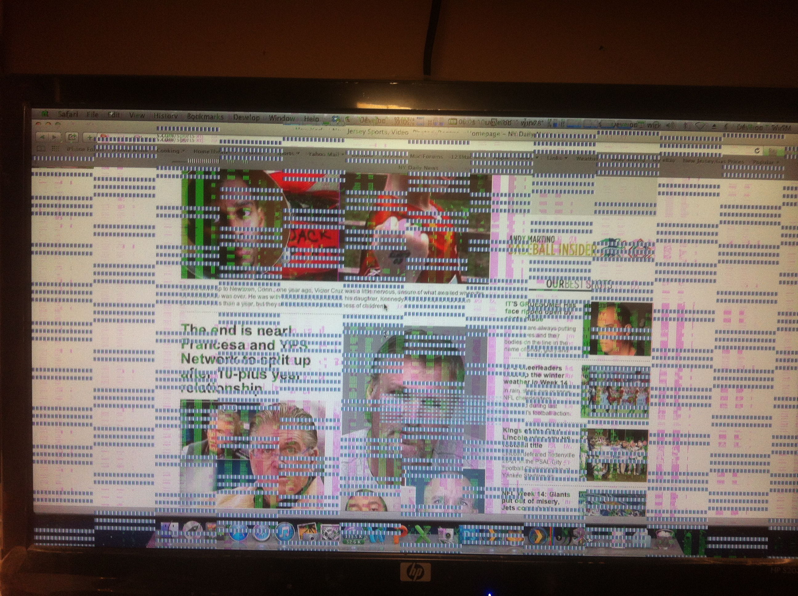

I'm having an issue with my mid-2011 base mini.
For the last week or so it has been randomly freezing up. The display will just freeze up leaving an odd fragments of the screen visible.
All I can do is hold down the power button and shut down then restart.
I repaired the startup disk, all was fine. Downloaded and installed the Lion 10.7.5 combo update, ran the Apple Hardware test.
Any other ideas where to troubleshoot?

Here's some random thoughts:
Be sure to try the hardware test as soon as possible after the next time the video is corrupted. It could be a heating issue, and the test may fail while it is still warm. Run both the standard and extended tests.
Which video output are you using?
Be sure to try the other output (Thunderbolt, instead of HDMI, for example).
You'll need the proper adapter for the display that you are using.
If you have them available, try different memory sticks. The basic mini shares video memory with the main memory.
If nothing helps, then it's likely a logic board (the video chip is faulty)

Thanks for reading and responding.
I did run the hardware test right after it froze, 3 passes with no problems detected.
I am using both video outputs. I have my monitor connected via Thunderbolt to DVI adapter, and my TV connected to HDMI. I always have Plex running on the second display (TV). It's been working fine like this for 2 years now all of a sudden I'm getting problems. When it freezes I get the same video distortion on both displays.
I was thinking it might be the memory sticks so I went ahead and reseated them thinking that might help. Perhaps switching positions would help? Do memory sticks just "go bad"? I'm using 2 4gb Corsair sticks that have been working fine since days after I got the mini.

You didn't say if you ran both hardware tests. I have sometimes seen the standard test fail, yet the extended test passes - which I can't explain, yet I have seen that result. (Apple has other, more extensive diagnostics that would mean taking to an Apple service shop or a trip to a "genius" for that test.
You say that your RAM sticks have been working fine - yet you are having video problem recently. One possible issue is the RAM, as it is shared by the video, and it's the only hardware that you can try by replacing with other sticks.
Or, it may turn out to be a failing video chip on the logic board (and both RAM or chips on the board can certainly "go bad" )
It's almost certainly not quite compatible memory.
I'm thinking it could be a memory issue as well.
But what makes you think they are not compatible? The same sticks have been working without any problems for over 2 years.
Replace the current RAM with the factory-original RAM, and run for 3-4 days with it installed.
Any better?
A Happy Update
Well what I did was remove the DDR sticks, cleaned the connectors, blew air into the socket and switched the sticks.
Has been problem free for 6 days and 23 hours now.
Looking good.
Thanks for all the suggestions 🙂
