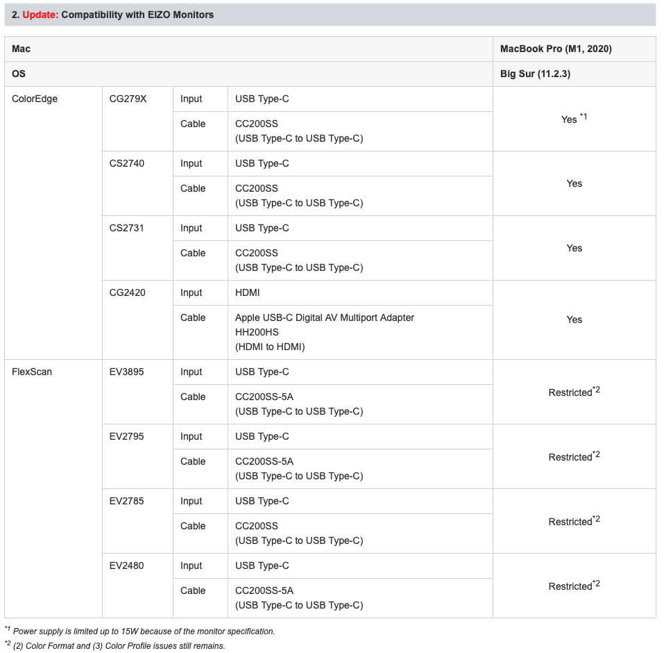

Are you sure that it works fine?
=> https://www.eizoglobal.com/support/compatibility/pc/mac/apple-m1/
As far as I understand the link, you have to use USB-C or Thunderbolt to Displayport to avoid the problems mentioned. Alternatively, you should adjust the settings for HDMI as described in the link.
As far as I understand the link, you have to use USB-C or Thunderbolt to Displayport to avoid the problems mentioned. Alternatively, you should adjust the settings for HDMI as described in the link.View attachment 1771718
