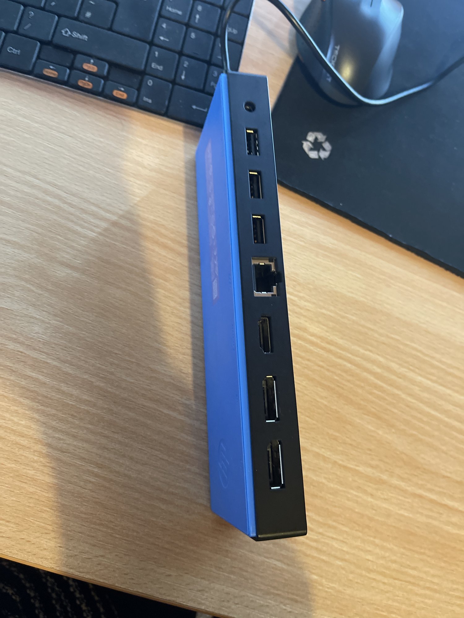

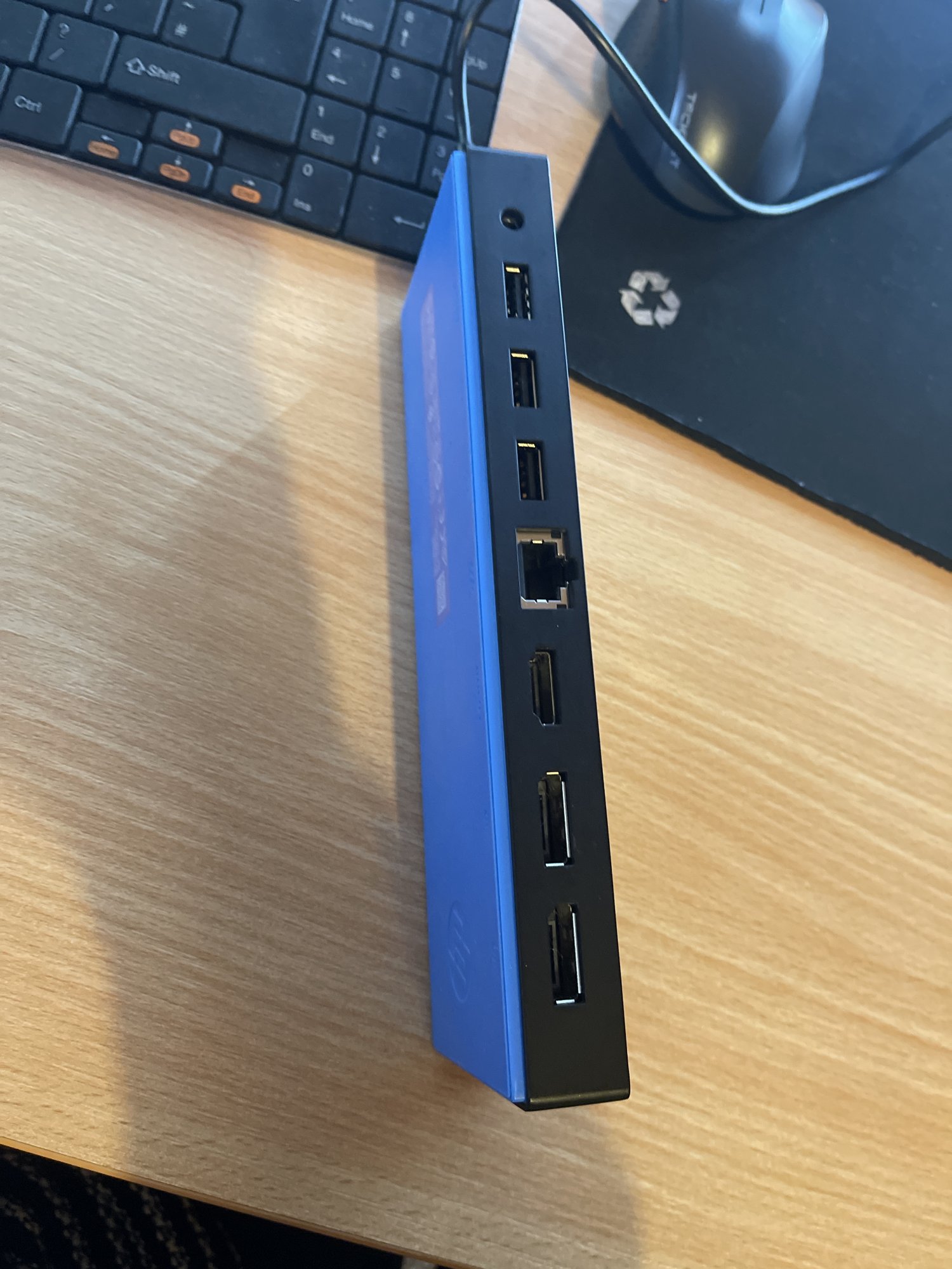

I have a HP one from work it’s a USB C DOCK G4
That appears to be a USB-C dock (not Thunderbolt) with built-in DisplayPort 1.2 MST hub for multiple displays. macOS does not support MST for multiple displays, therefore you'll only be able to connect a single display to this. The dock supports USB 3.x which means it only has two DisplayPort lanes (instead of 4) so the single display will be limited to 4K 30Hz or 1440p 60Hz.
You can connect two displays to a single Thunderbolt port using a Thunderbolt dock or a Thunderbolt 3 to Dual DisplayPort adapter. Otherwise you'll need to use two Thunderbolt ports with a USB-C adapter or cable for each.
