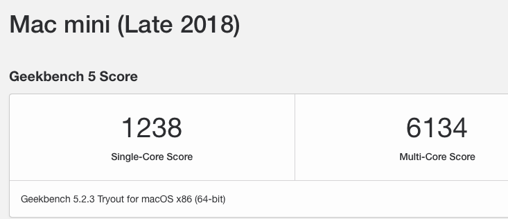

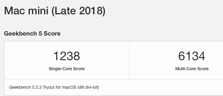

I don't think the 2018 Mac Mini has a throttling or cooling issue. I just ran the test at default settings and it handles the temps very well, It got up to 83 C but only for a second and the fans ended up just over 3K, you can hear them very well over 3K but it was short and when the test ended it was 40's C in seconds. I don't see much of a benefit for performance blasting the fans full. My default score is very close to your Max fan score.
GB5 is not the program to test heat because of the sporadic bursts. Try Cinebench for your testing.

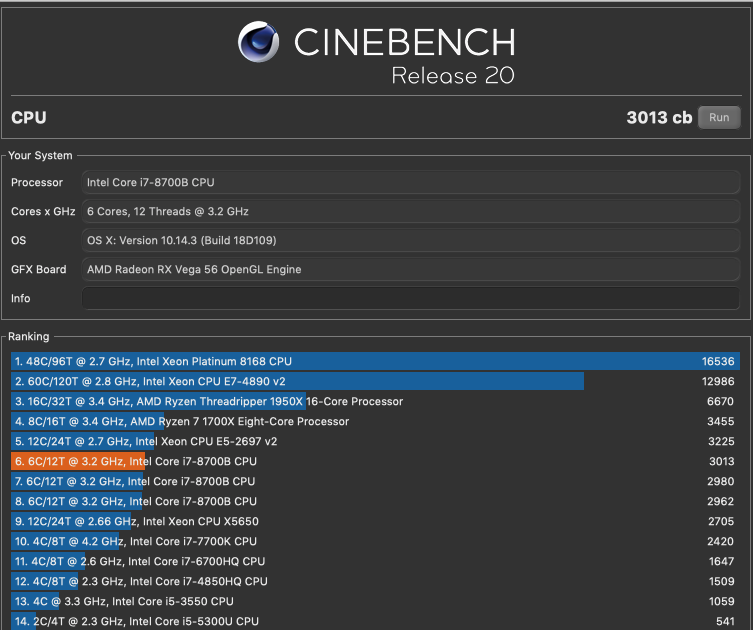

Cinebench is even worse for thermal throttling on the mac mini, but your'e right it's a better way to demonstrate the issue.
With turbo on - fan on max:
The chip can only sustain 3.49GHz to keep within the 100C limit, it only peaks at 4.6Ghz for 2-3 seconds at the start of the test and the nose dives as the temperature hits 100C almost immediately.
-CPU remains steady around 3.49Ghz
-Chip draws ~70W and maxed out temp at 100C.
Score: 2797
With turbo off - fan on max:
The chip runs at 3.2GHz - which is the base clock of i7-8700B
-CPU remains fixed at 3.2Ghz
-Chip draws 55W max and temps gradually increasing until reaching 81C max towards the end
-Repeating this test with fan set to normal, I get score 2478 and temps gradually increasing until ~95C towards the end
Score: 2487
So with Turbo on, I only sustain 300MHz higher clock rate yielding 12.5% more performance, yet it's reaching boiling point of water and using 28% more power.

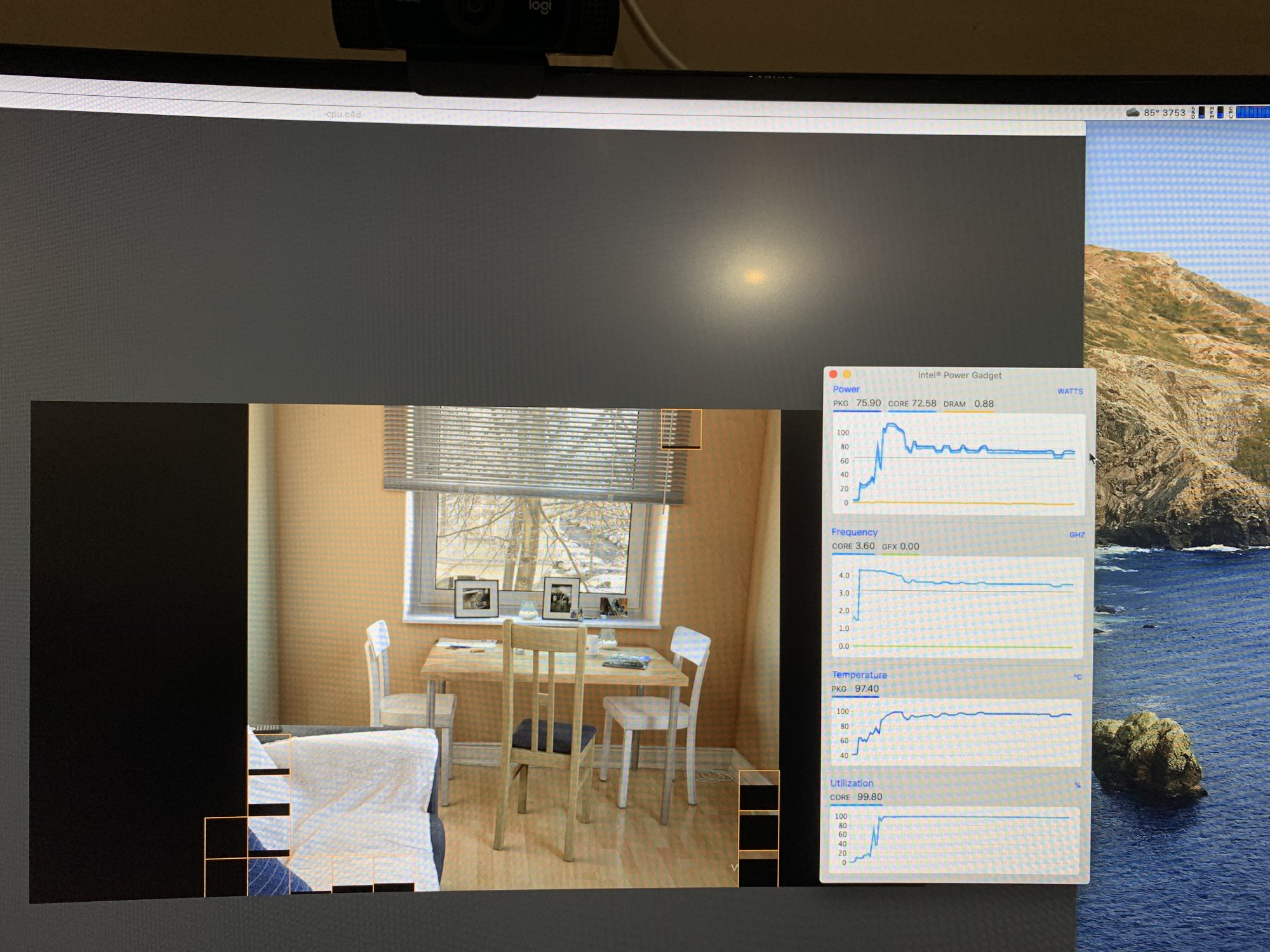

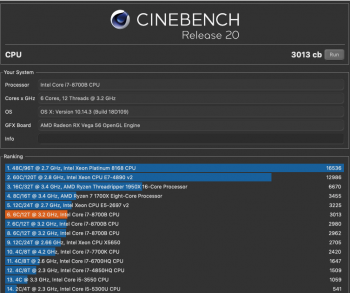

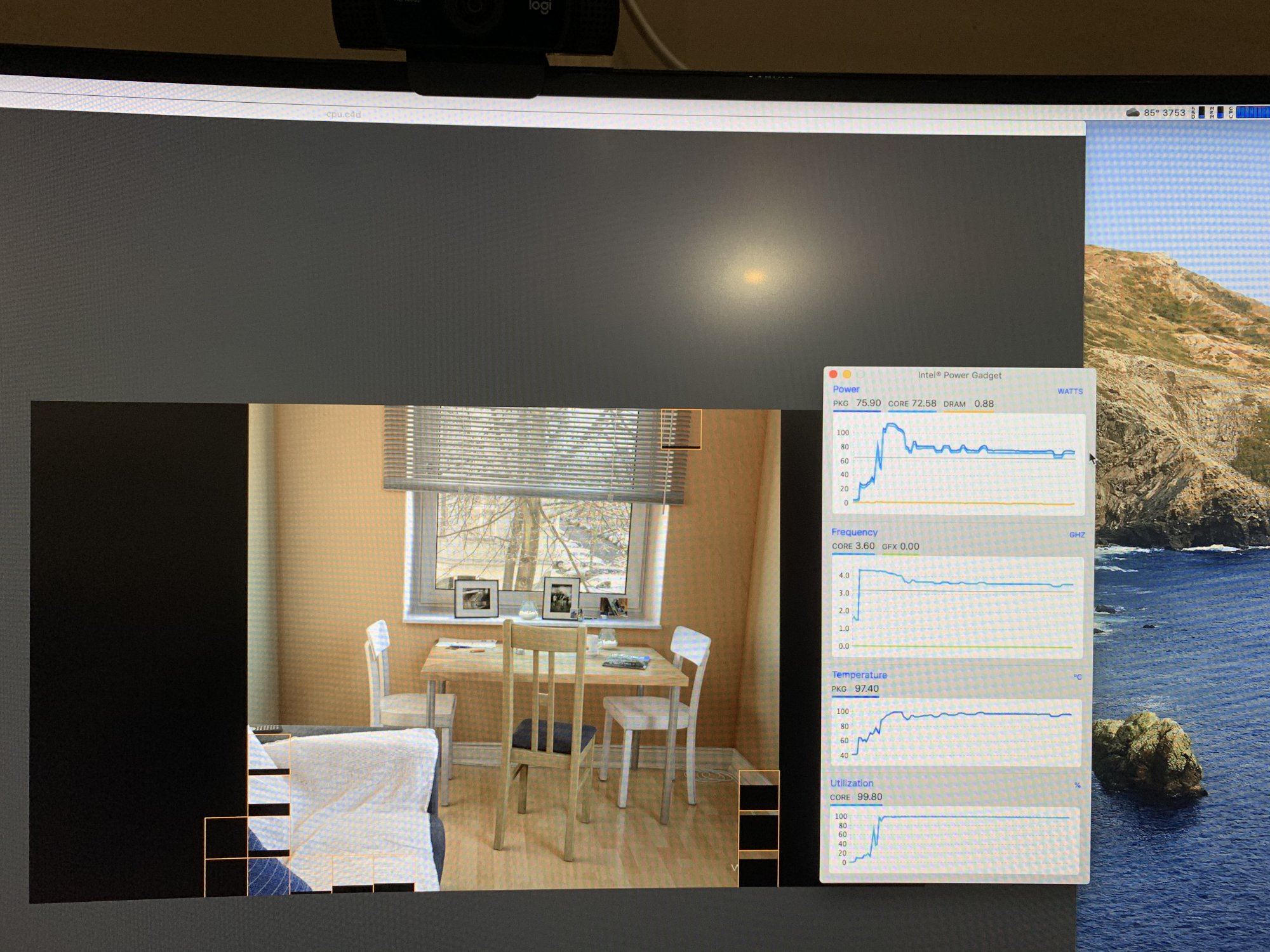

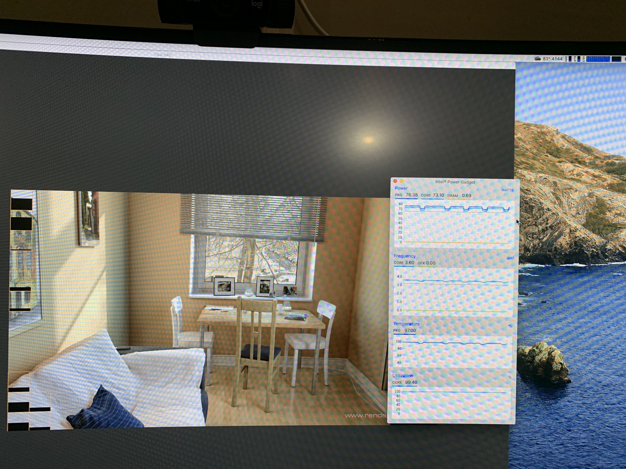

I ran the App after I suggested it, its been a while but I scored over 2900 and the temps never exceeded 85C and ran in the low 80’s. My fan speed did top 4K midway through the test, I do have a $5 Nupad I am sitting on which may help for air flow. I also know mine is dust free for I just upgraded the ram. If your maxing out at 100C then that’s a good 15C higher than mine? 2915 was not my highest score, I bested over 3000.

An i7-8700 should reach 3547 on cinebench when it's able to properly use the 4.3GHz "6-core turbo speed". Also keep in mind you have an eGPU there, but yeh the base is a good idea probably helps with airflow a little bit. Can you run the test with Intel Power Gadget in the background as it will be interesting to see the actual core temps and sustained turbo speed during the benchmark ?
An i7-8700 should reach 3547 on cinebench when it's able to properly use the 4.3GHz "6-core turbo speed". Also keep in mind you have an eGPU there. Can you run the test with Intel Power Gadget in the background as it will be interesting to see the actual core temps and sustained turbo speed during the benchmark ?
Will do, but I am done tonight on the MM. I will post it tomorrow. If you would like something else let me know before the AM, I already have it back in the freezer preparring for the next test 😂. That was a joke....

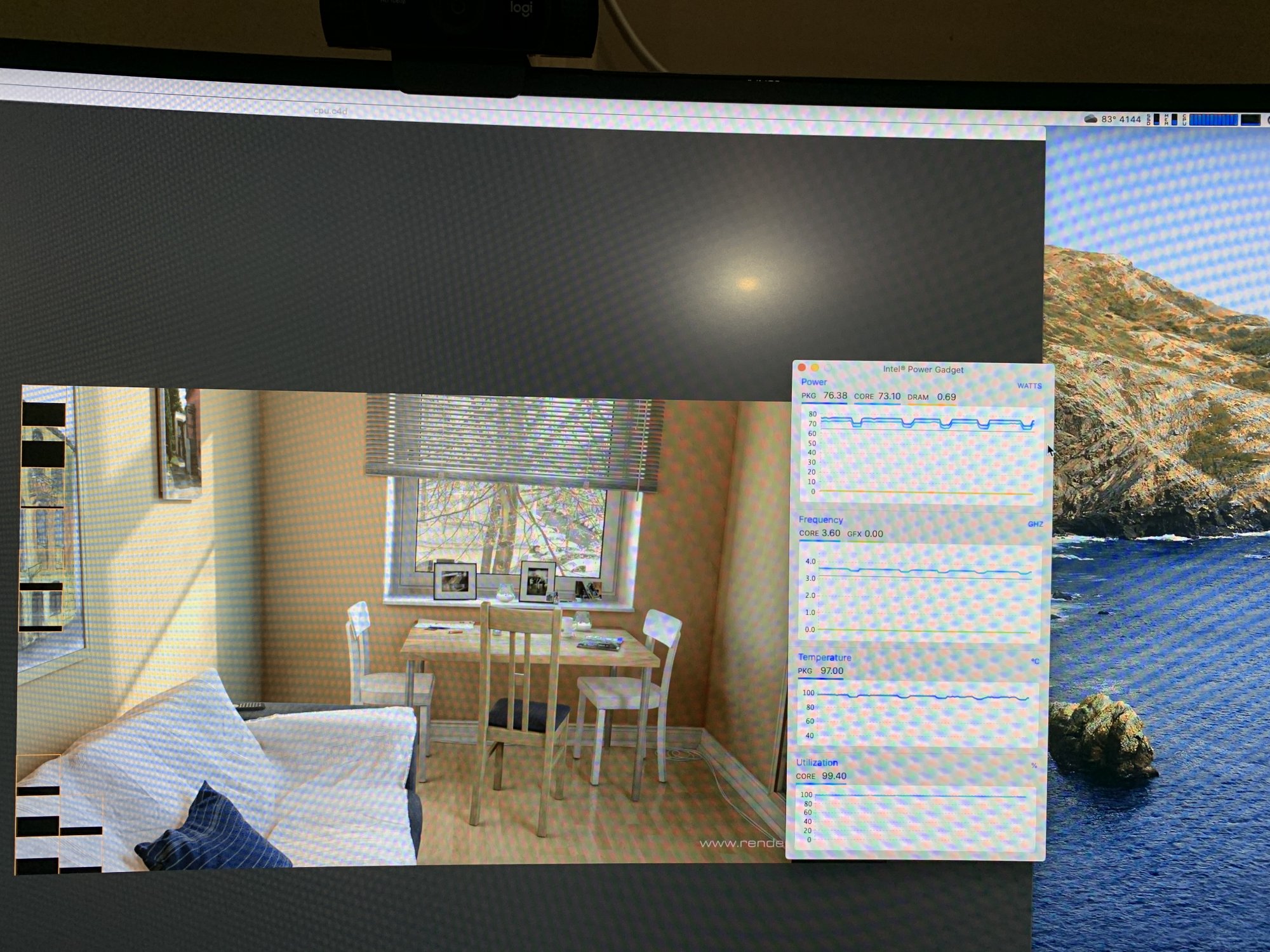

I ran the test with Intel power gadget. Frequency peaked at 4.+ in the beginning and sustained around 3.6 +/- .1 for the remainder. My temps was in the high 90's on intel oddly my iStat showed (istat top menu bar temp)in the mid 80's, obviously a different sensor I have picked on iStat. Scored 2922 running both apps.
update: Checked my istat sensor and I was using CPU Proximity, changed it to CPU PECI and it matches the Intel temps now which I confirmed after rerunning the test.
