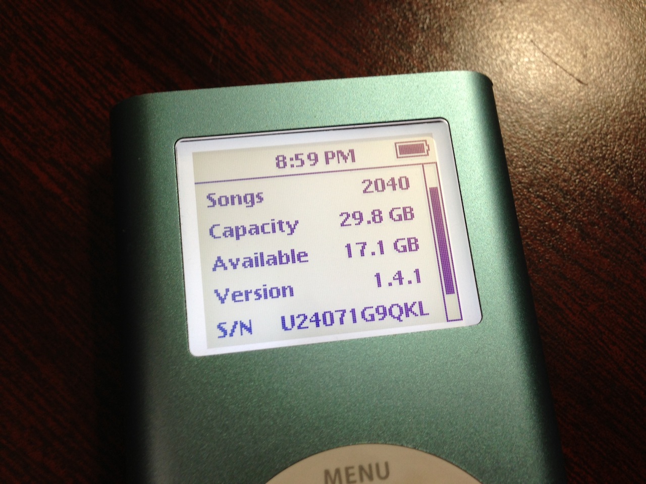

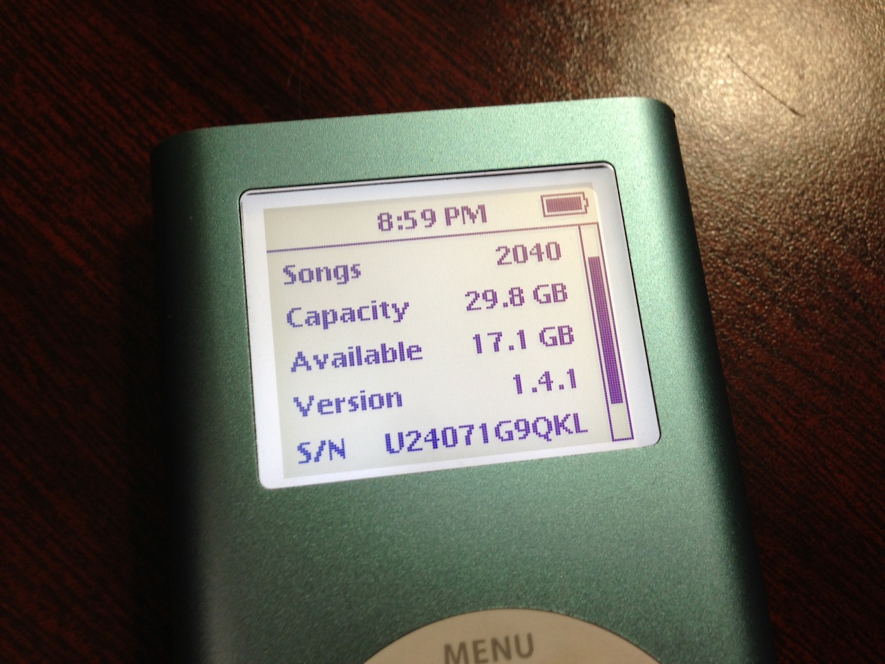

I did this a while back with my old mini - swapped in a new battery and a 32GB CF card. Works like a little champ now!

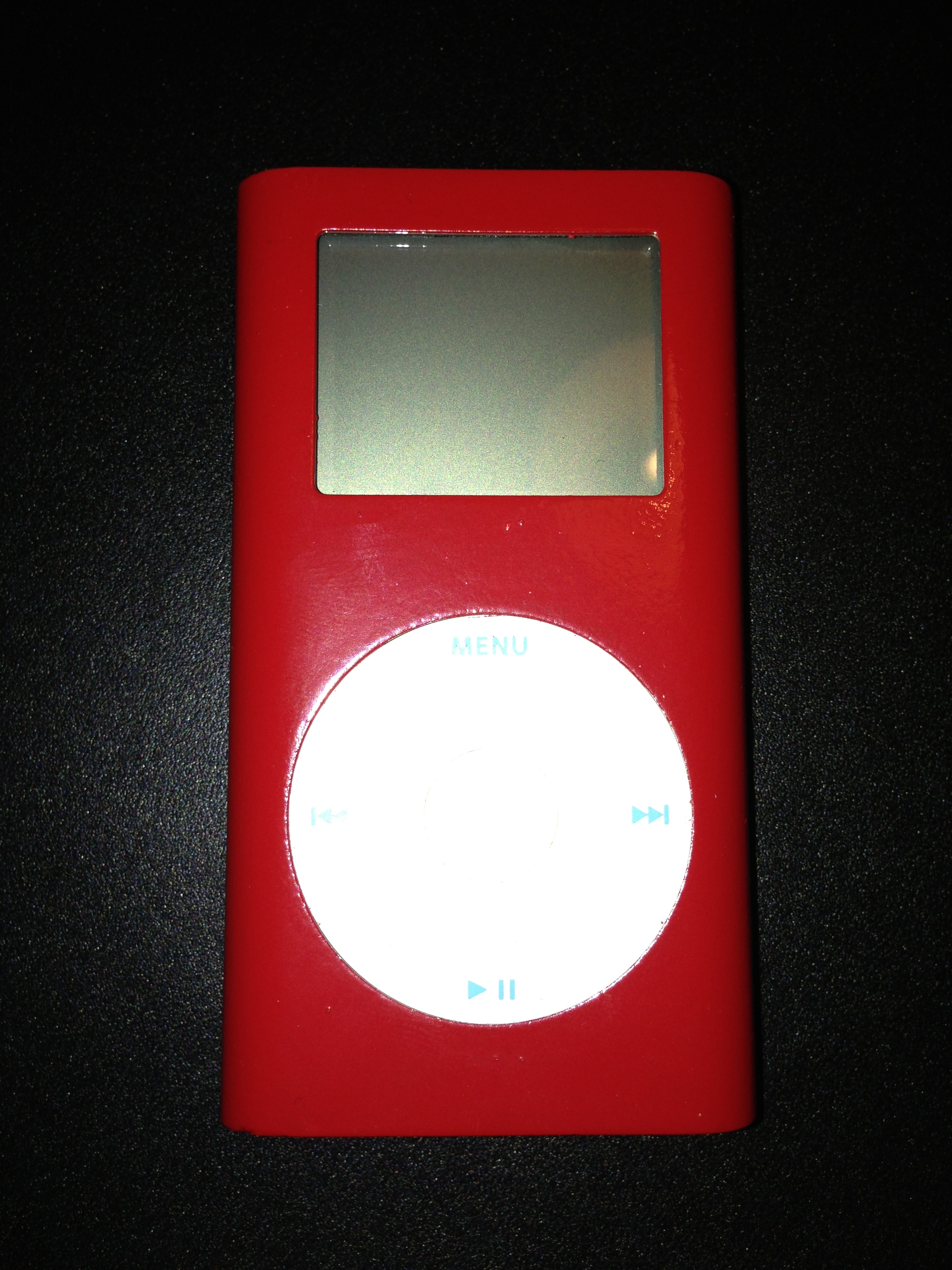

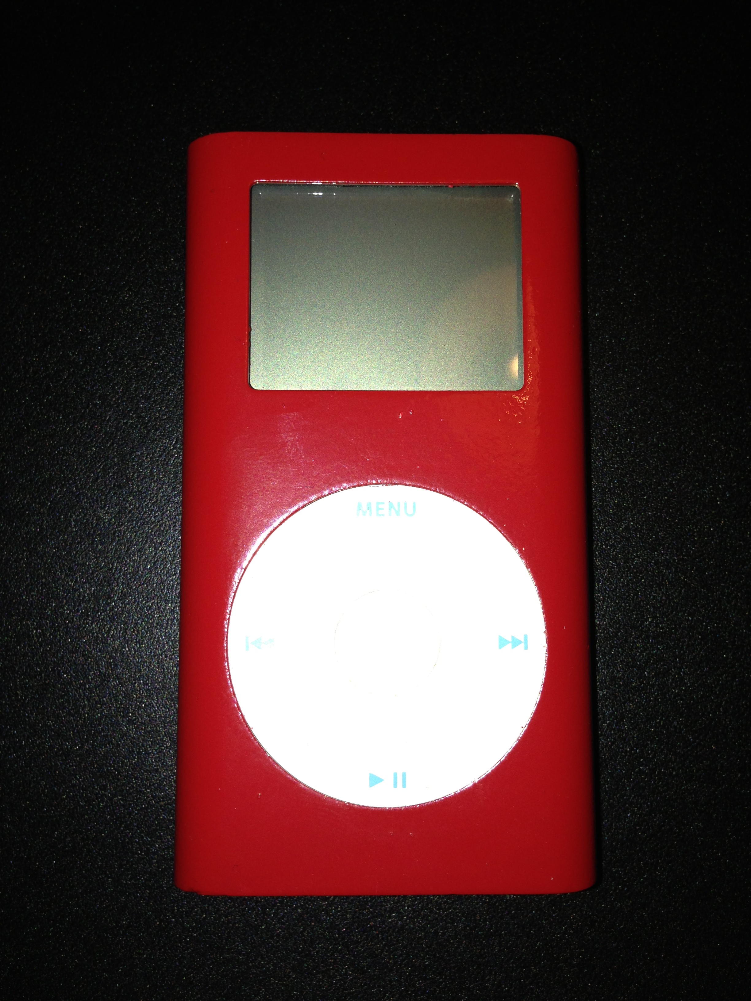

Just a little project with a spare iPod Mini I had lying around, pretty rough but it does stand out! Just needs a 16GB CF card and its good to go 🙂
