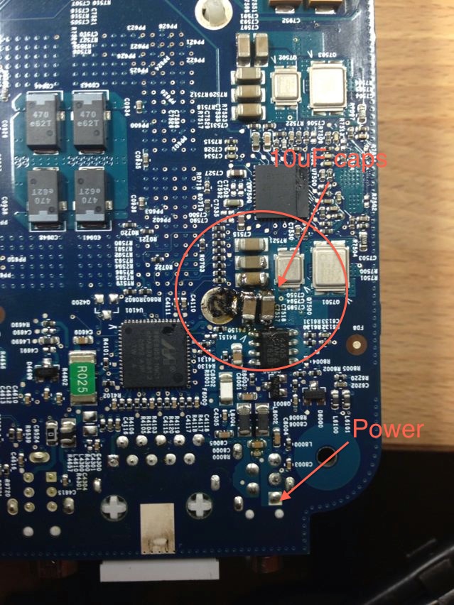

If apple said the logic board is bad, there is a a likely fix you can do. the capacitors on the underside of the motherboard next to where the power adapter plugs in are likely bad. I believe they are 10uf caps. I have attached a pic of my repair.
Can one desolder those surface mounted components?
Yes. The only concern is that the solder on these seems to have a pretty high melting point, so make sure you have a good iron. You'll notice my repair looks a bit ugly, but it started right up and has been going for 2 weeks with no issues now. The caps themselves should cost you < $5 with shipping, or if you have any dead computer parts around, this is a common value that you could salvage. I took mine from a dead imac g5 board.
