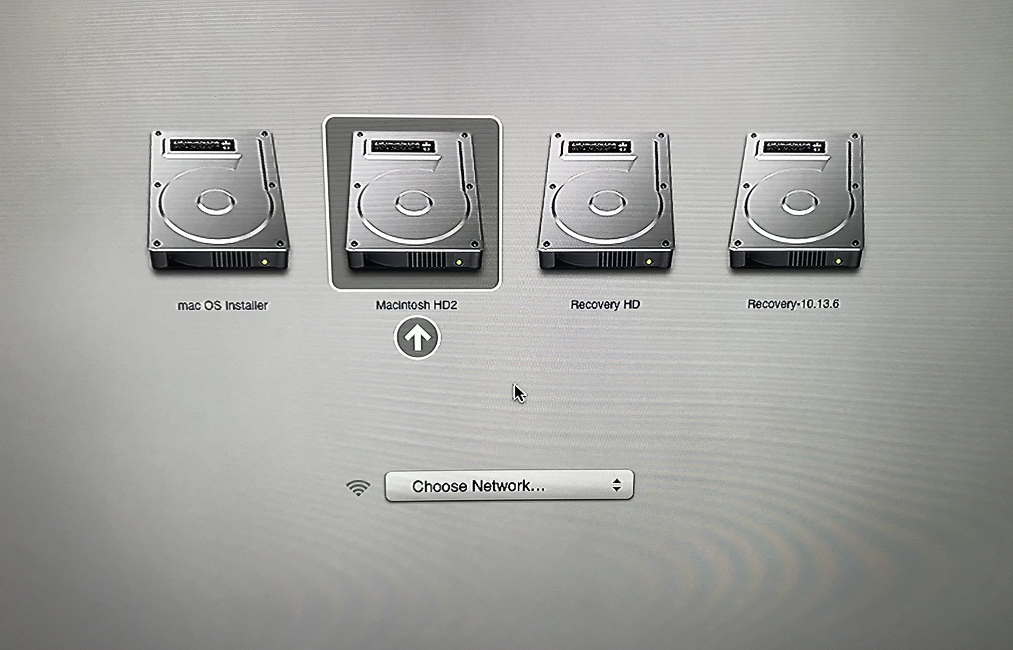

Well, I guess this confirms that “Macintosh HD2” is the bootable drive that I’ve been using, and “Server HD” does not have a bootable system on it.

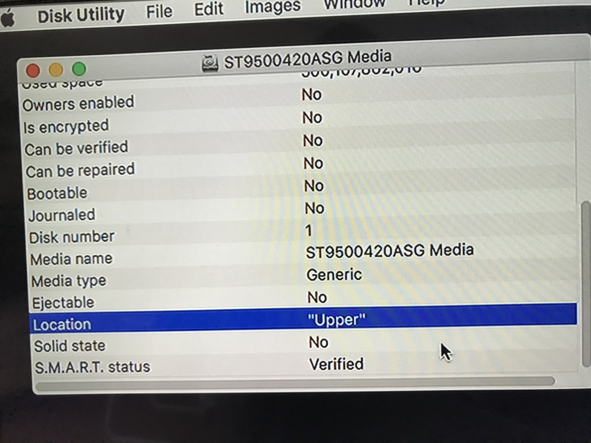

OP still needs to discover which of the two hard drives to remove.
There is a method to find out which "bay" your Macintosh HD2 is located...
Boot to your High Sierra external installer.
Open Disk Utility. Click on the View icon, and choose "Show All Devices"
Select the device which has your Macinstosh HD 2 listed underneath.
Again, the device is the line showing the device model or part number. On your mini, that begins ST9500 ...
Click the Info button (top right corner of that Disk Utility window.
Scroll near the bottom of that Info window, and you will see "Bay", or "Location", then either "Upper" or "Lower"
"Lower" bay is nearest the opening on the bottom of your mini (the location when the mini is in the normal upright position. The "Upper" location needs much more disassembly, compared to the "Lower" bay.
Yes, that will work (assuming your bootable installer is correctly created).
You will find out soon enough. It will either boot up, or will fail (such as displaying a "prohibited" circle with a slash across.)
Ok, it worked. I booted to the mini, while holding the Option (alt) key and then selected “Mac OS installer”. Then, following your directions, I unfortunately found that “Location” for “Macintosh HD2” says “Upper”.

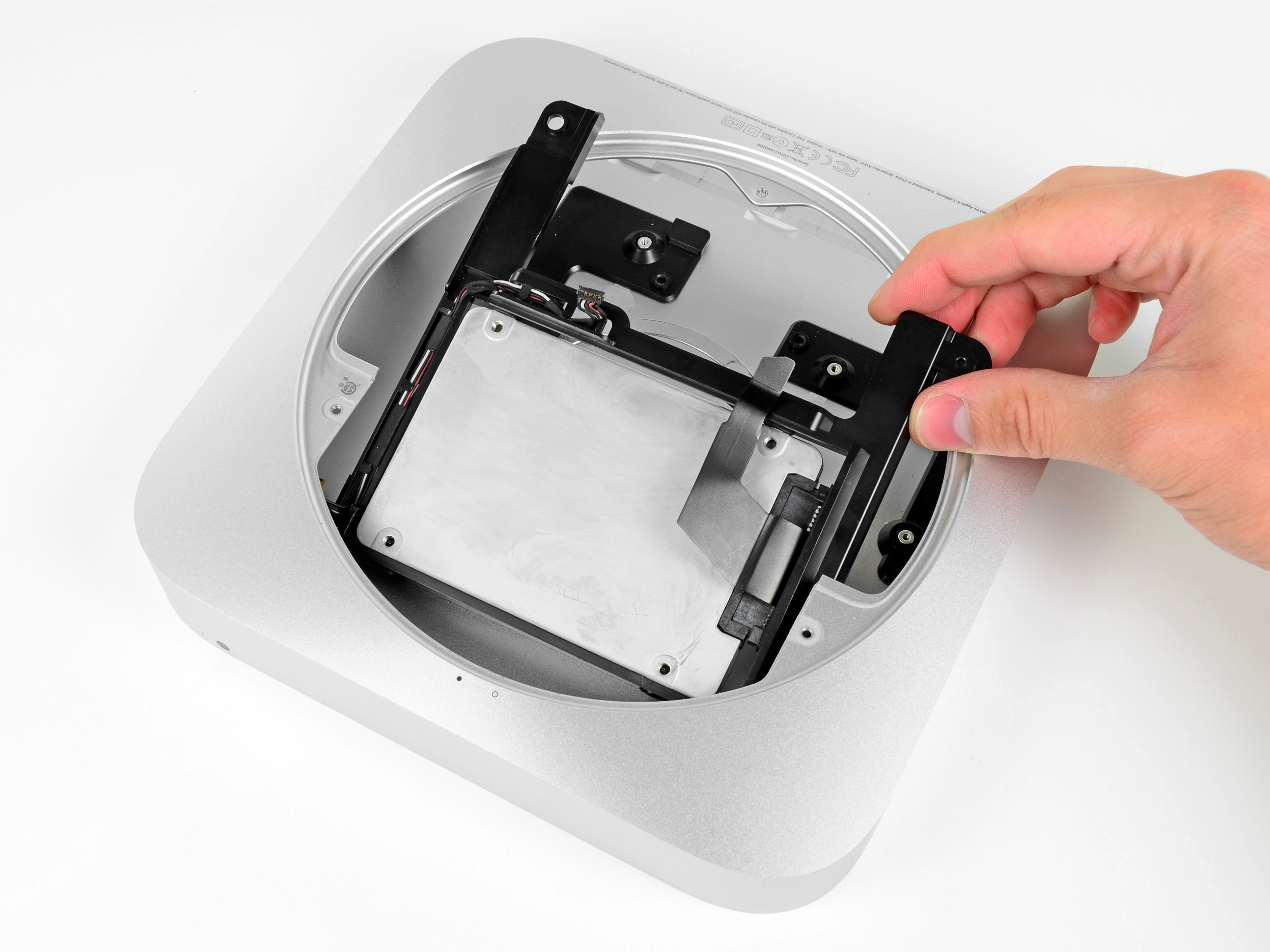

I found this video, How to Upgrade/Replace the Drives in a Mac mini Server 2010 (Updated).
However, I’m not sure if it’s exactly the same disassembly as my 2011, but I certainly see what you mean by “‘Upper’ location needs much more disassembly, compared to the "Lower" bay”. It’s basically 100% disassembly. 😬
The 2010 mini Server is very similar to the 2011/2012 mini, although it looks like the drive bracket inside might be slightly different. I would suggest that you compare that video to the iFixit steps for replacing drives in an actual 2011.
If you use that guide, it takes some time to show how to prepare new SATA cables for installation. You probably won't need to do those steps, unless you replace the SATA cables, too.

I actually also found the How to Upgrade/Replace the Drives in a Mac mini Server 2011 / 2012 (Updated) video.
Before I attempt to replace “Macintosh HD2”, I’m assuming, if possible, the first step is to back it up. If possible, how do I back up “Macintosh HD2”?
I’m thinking, I potentially have two options of where to back it up to, either to the “Server HD” or to my external WD My Passport Ultra (2TB), but I’d appreciate your input.
If you are replacing the "Macintosh HD2", then the original is already your backup.
If you still want to back up that drive to some other storage, then you might use Carbon Copy Cloner for that.
It really doesn't matter what device you choose for a backup, assuming that backup drive is working, and has enough space for the backup. (AND, of course, you do want to know that the backup will be successful. Trying to do that backup will tell you if that is a good bet 🙂 )
I have a couple of 500GB external SSDs that I reserve for temporary backups, and a 1TB SSD if I need more space.
(You can make your own 500GB SSD external USB drive for around $60. I have about 10 that I have accumulated over the last 3 or 4 years -- big variety of brands for both SSDs and enclosures...)
I only mention that, to let you know that your options for backups are more than just two!

And excuse my ignorance or “flopping around like a fish out of water,” 😉 but if I’m replacing “Macintosh HD2,” because it isn’t working, and “It really doesn't matter what device you choose for a backup, assuming that backup drive is working,” then how is the original already my backup, if it isn’t working? 🤔
Because that's where the files are now -- that you would like to back up. Even if the files are not accessible, they are still on the drive. You might not be able to backup to another drive, but the files are still there on the original, and (in theory) can be moved to another drive.
If the drive is not working (which you don't know for sure while the drive is still installed in your iMac), then the options for backup get pretty limited, if it is even possible. Important files, such as financial docs or unique pictures, on a drive that "isn't working" may still have an option of sending to a data recovery service, if you think that is worth the cost.

Other steps before moving forward? Check that you have the tools that you need. The iFixit repair steps lists the various tools that you will be needing for the repair. (It's always "fun" when you get things partly done, and suddenly realize that you are missing that T-6 screwdriver, etc. 😀 )

I’ve watched the video that I found a few times and have been reading through the iFixit repair steps & comments, which are actually for a single HD mini NOT a dual drive mini server, but I do appear to have most if not all the tools listed and/or suggested alternatives. That said, it sounds like once I’m confident enough to get in there, it’s time to just do it.
You should be able to find the Apple service manual for your mini, which would give you a bit different idea about how to do this.
Search for "mac_mini_mid_2011.pdf"
