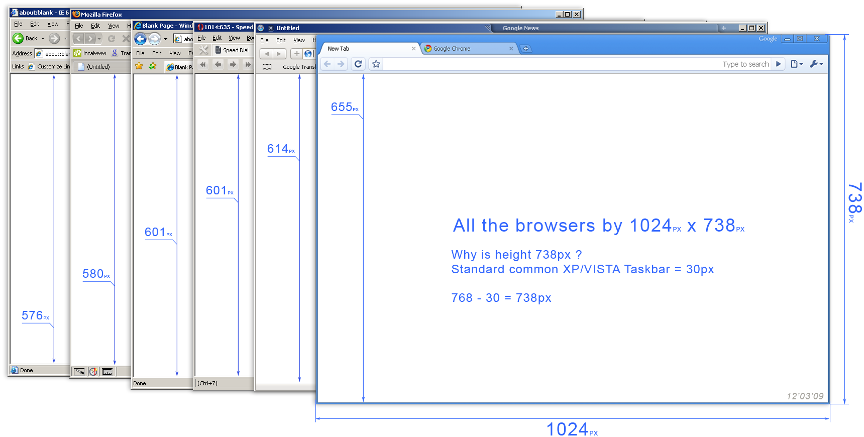

Currently planning a site that will have elements of fluid layout, but will have a "core" that -- sadly -- must stay fixed. Of course, I don't want users to have to scroll to see it.
On "todays internet" what is your opinion on the smallest viewport that you care about? 955 x 600? 1000 x 800? smaller? larger?
The site is is for a museum exhibition, and targeted at a youngish-to-middle-age, educated, somewhat-affluent audience who are looking for a visual experience -- so bigger is better, but I want to find a balance between best experience and most average supported users.

Minimum view area?
The Minimum view area by height is different in all the browsers
By width IMHO it's still 1000px(after ScrollBar) for 1024x768px, less it's already very rarely

IMHO the problem here is that any common user uses the different toolbars and OS taskbars, which is always reduces the view area by height, and these measures are can be variable
if we are going to build on standard browser settings, take a look and compare Browser View Area in the attached image for the 1024x768px resolution

For your self investigation you can use a ff useful plugin Firesize
How you are able to calculate your best height further, it is up to you
You can use Golden ratio division 1000/1.6= 625
Or you are going from minimum measure 576px
Good luck, hope my explanation and image are helpful
Alex
