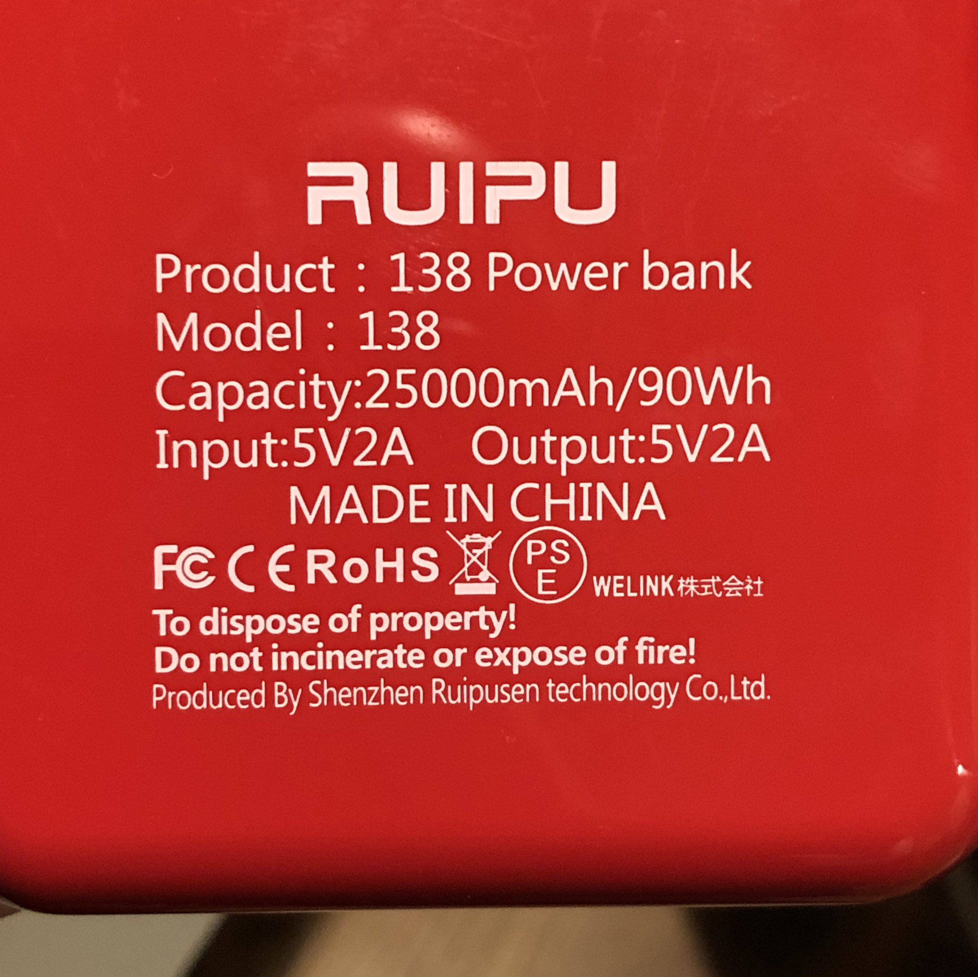

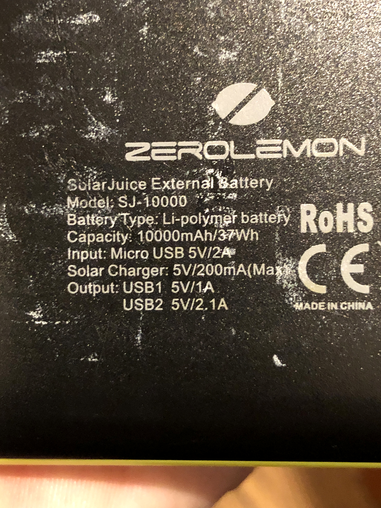

Hey there! Does anyone know what the minimum wattage requirement is to charge the M1 iPad pros? I have two external batteries. One puts out 5W and the other 10W but neither of them will charge my M1 iPP 11. Thanks!

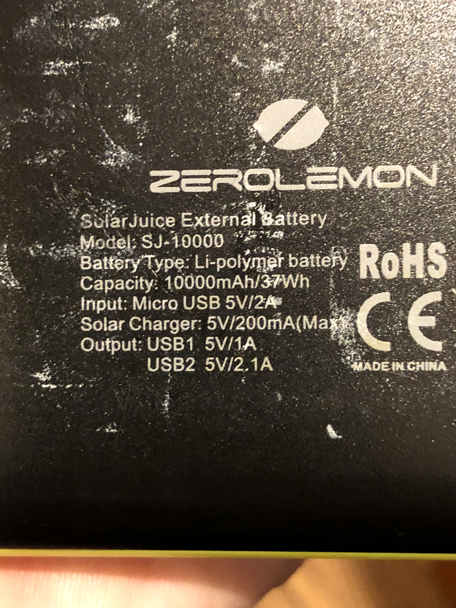

Ok. I actually have 3 batteries all with similar specs and none of them trigger the charging mechanism on my iPad Pro. The iPP does work with all the wall chargers I have for it, lowest being 18W. I dunno. I do see a lot of battery packs that specifically advertise work with iPP 2021 that are 18W and above. Not that big of a deal. Amazon has a ton of them and they're not that expensive. Anker makes some good products. I'll probably just get one of theirs.
Edit: Just to add to the mix. My older Apple 10W iPad charger does not trigger charging on my M1 Ipad Pro either.🤨

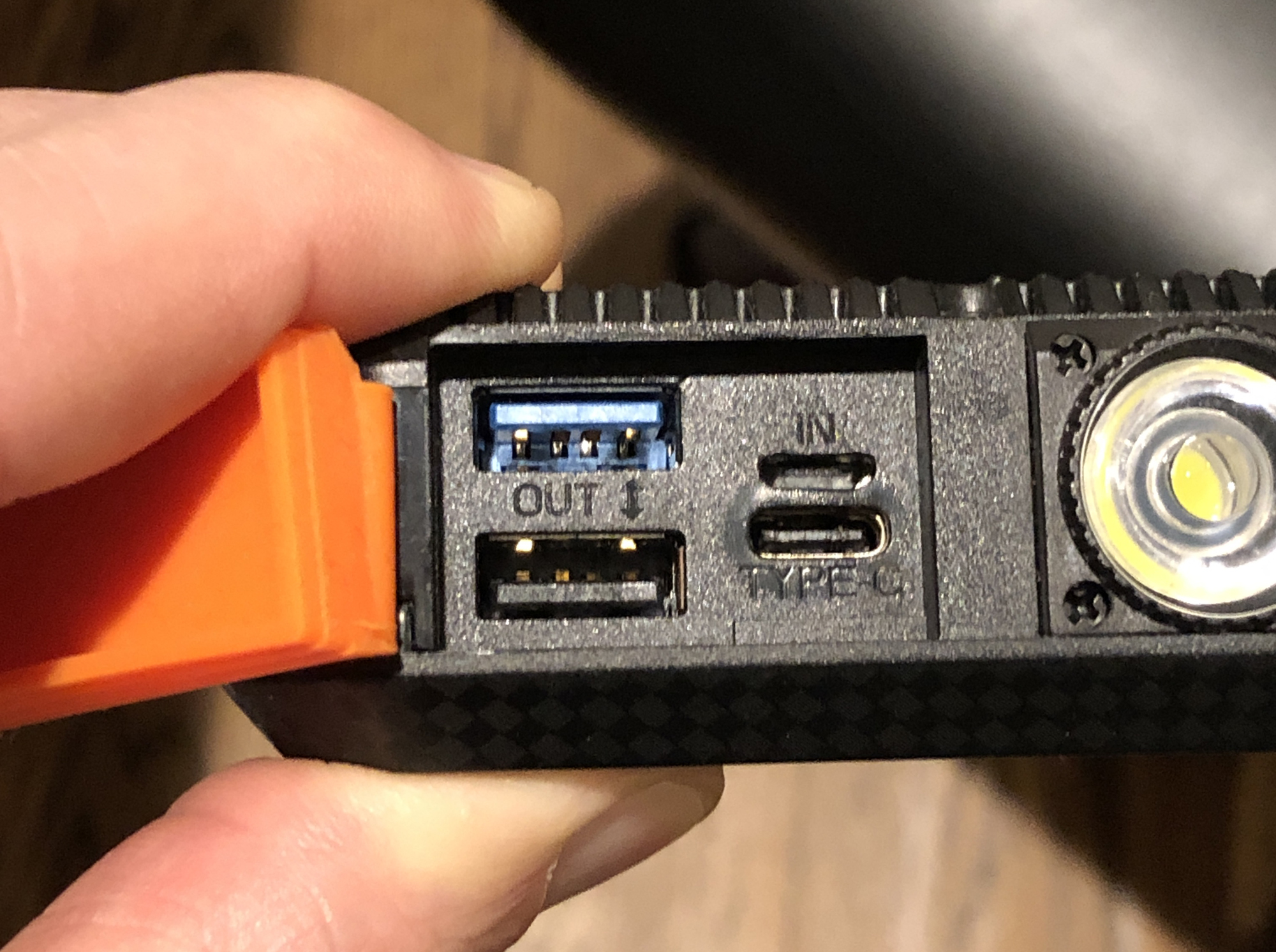

View attachment 1977460 View attachment 1977462 View attachment 1977463 View attachment 1977465 View attachment 1977466

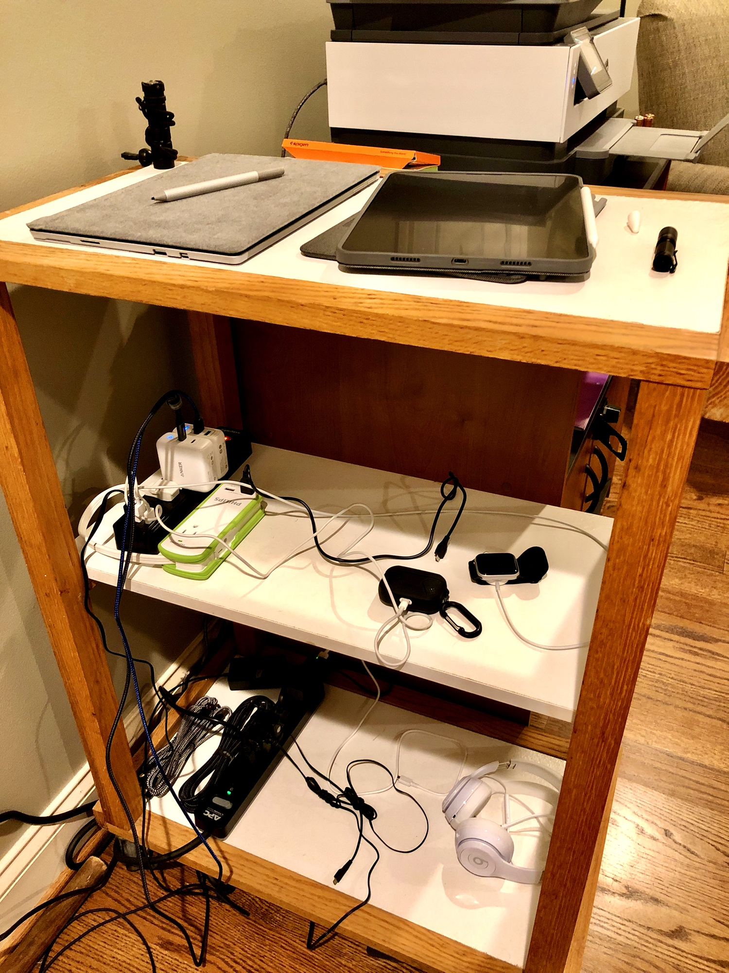

Yeah, I have plenty of chargers. It's a portable battery to throw in my bag when out and about that I need. Anker has several of those also. Just need to head to Amazon and pick one or two up.😉

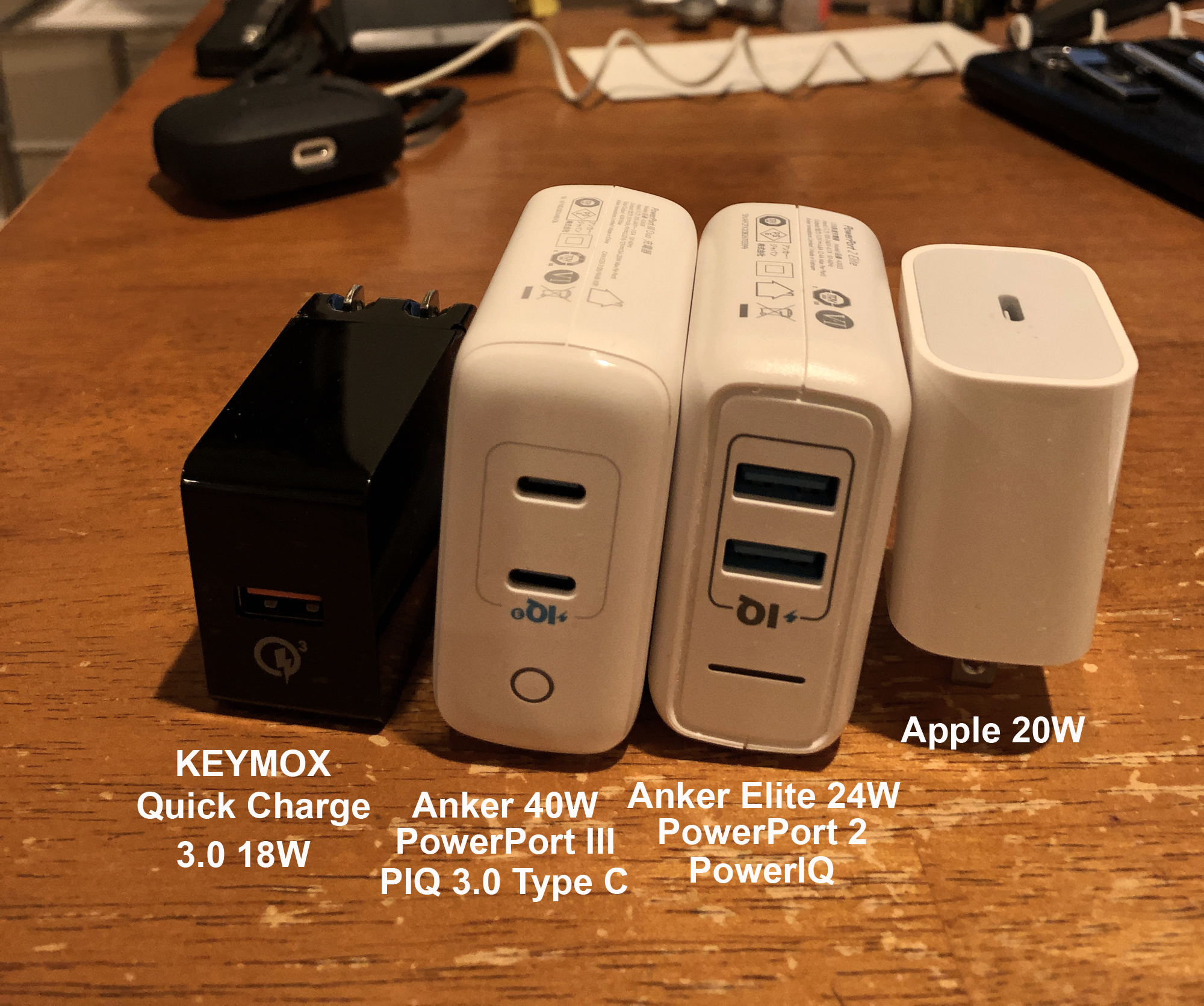

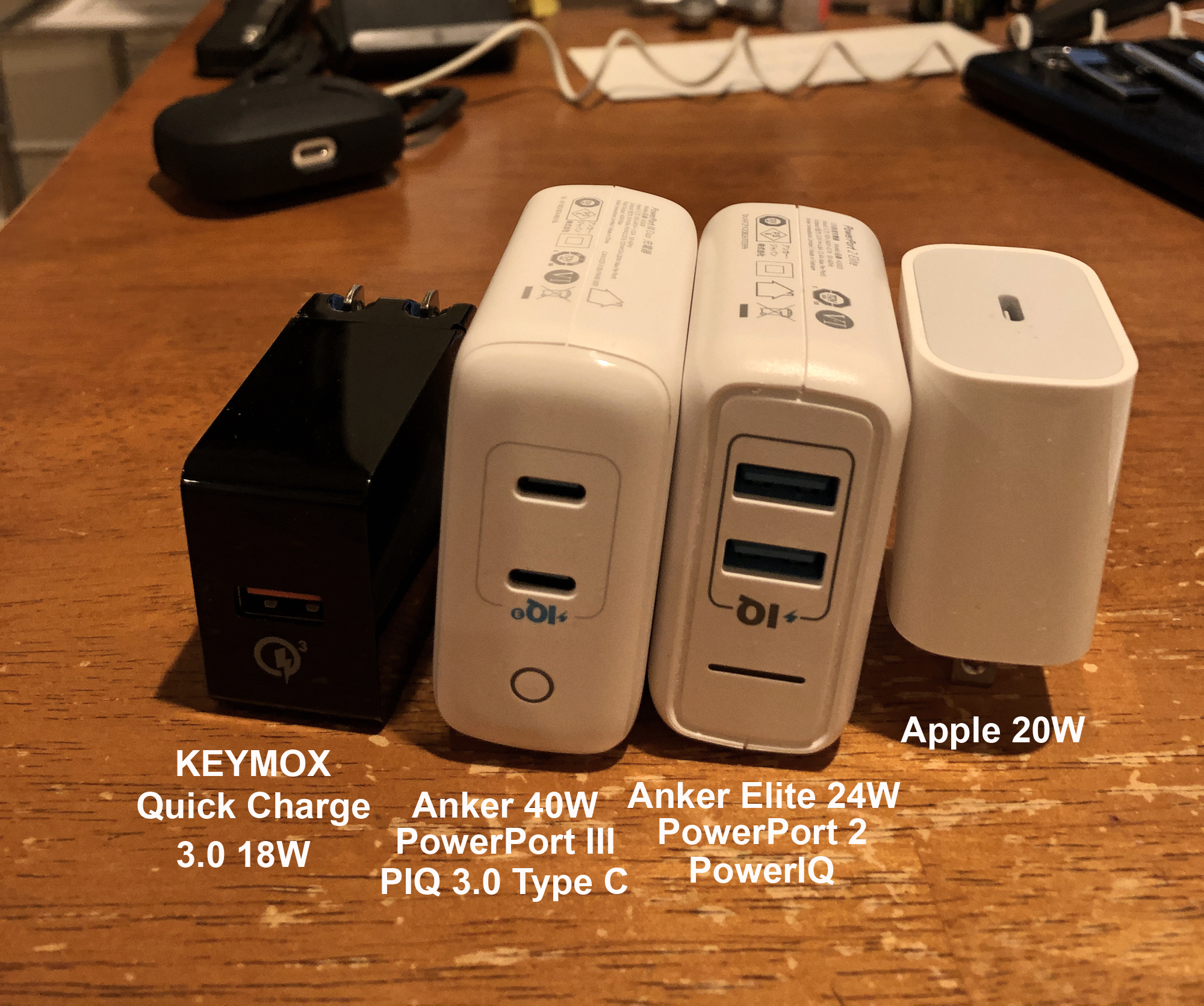

The KEYMOX is in my bag. The Anker 40W is on my charging stand. The Anker 27W is on my charging stand. The Apple 20W is my nightstand charger.
Not very orderly, but functional.😛

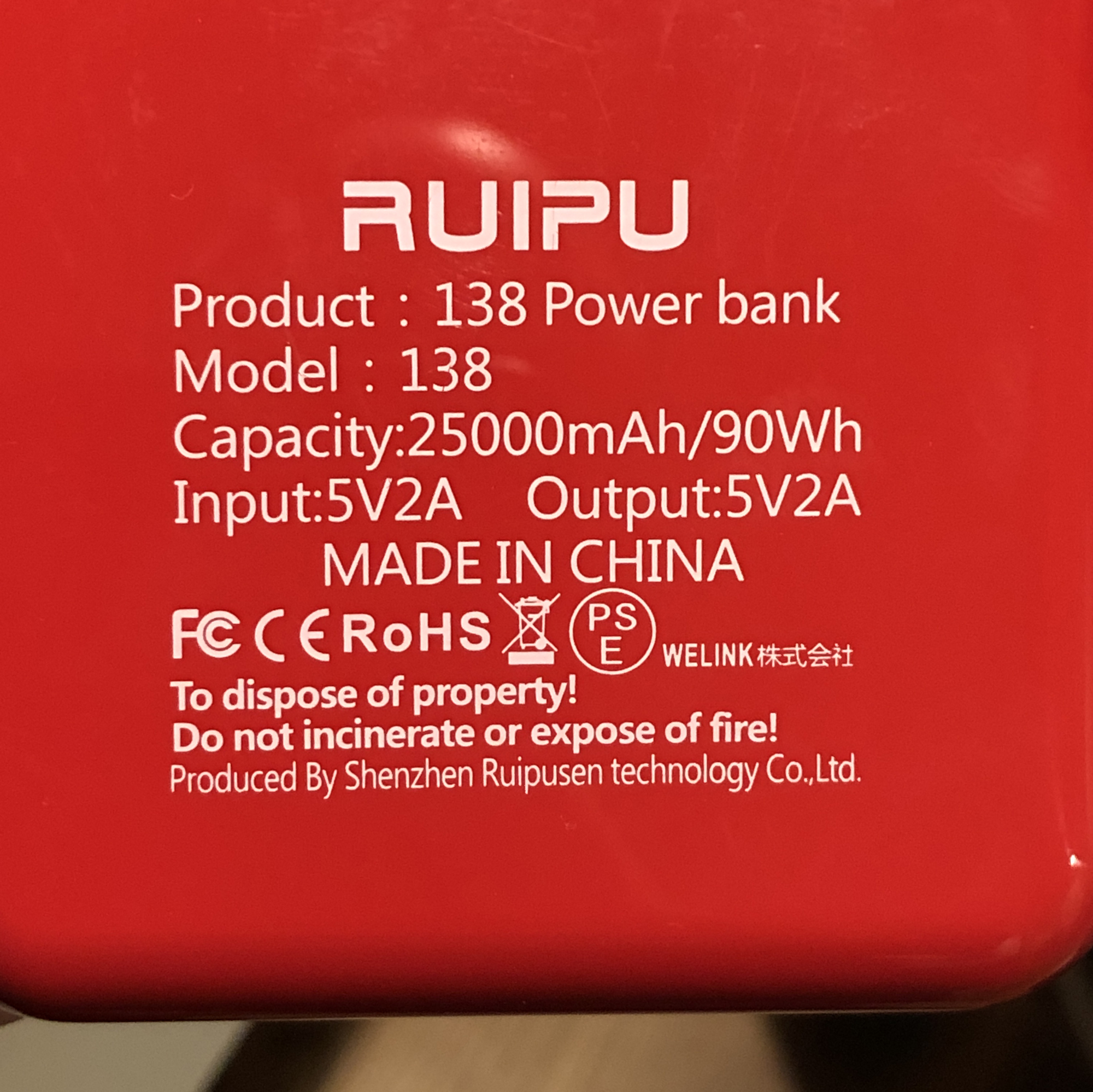

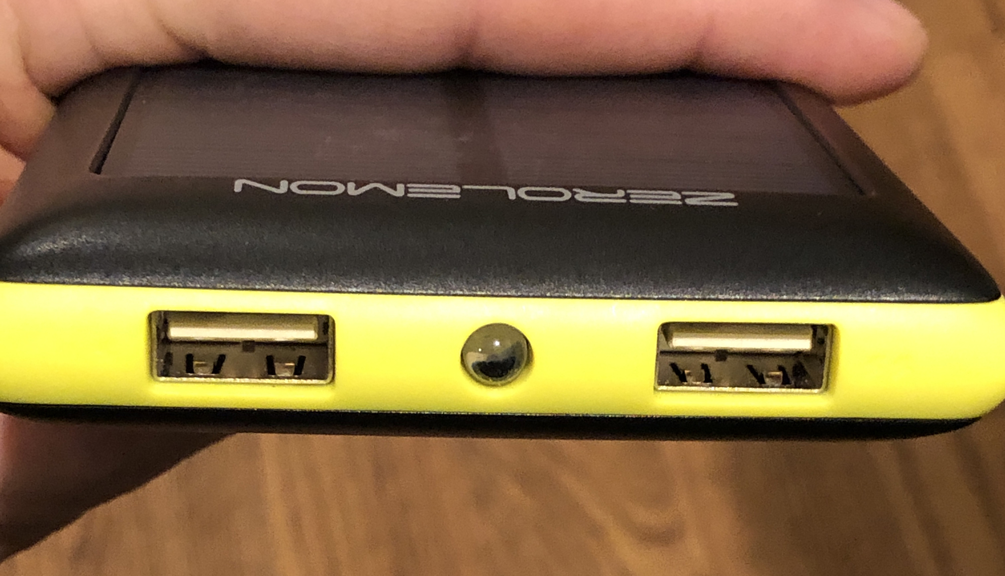

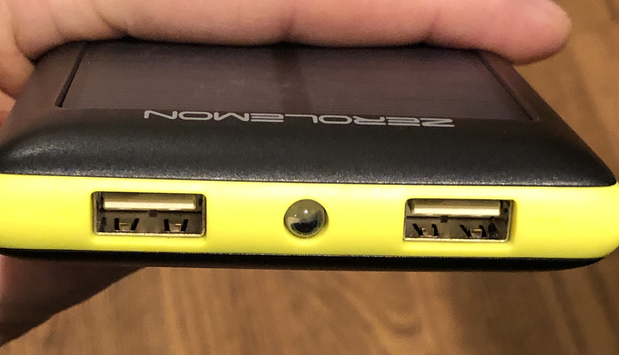

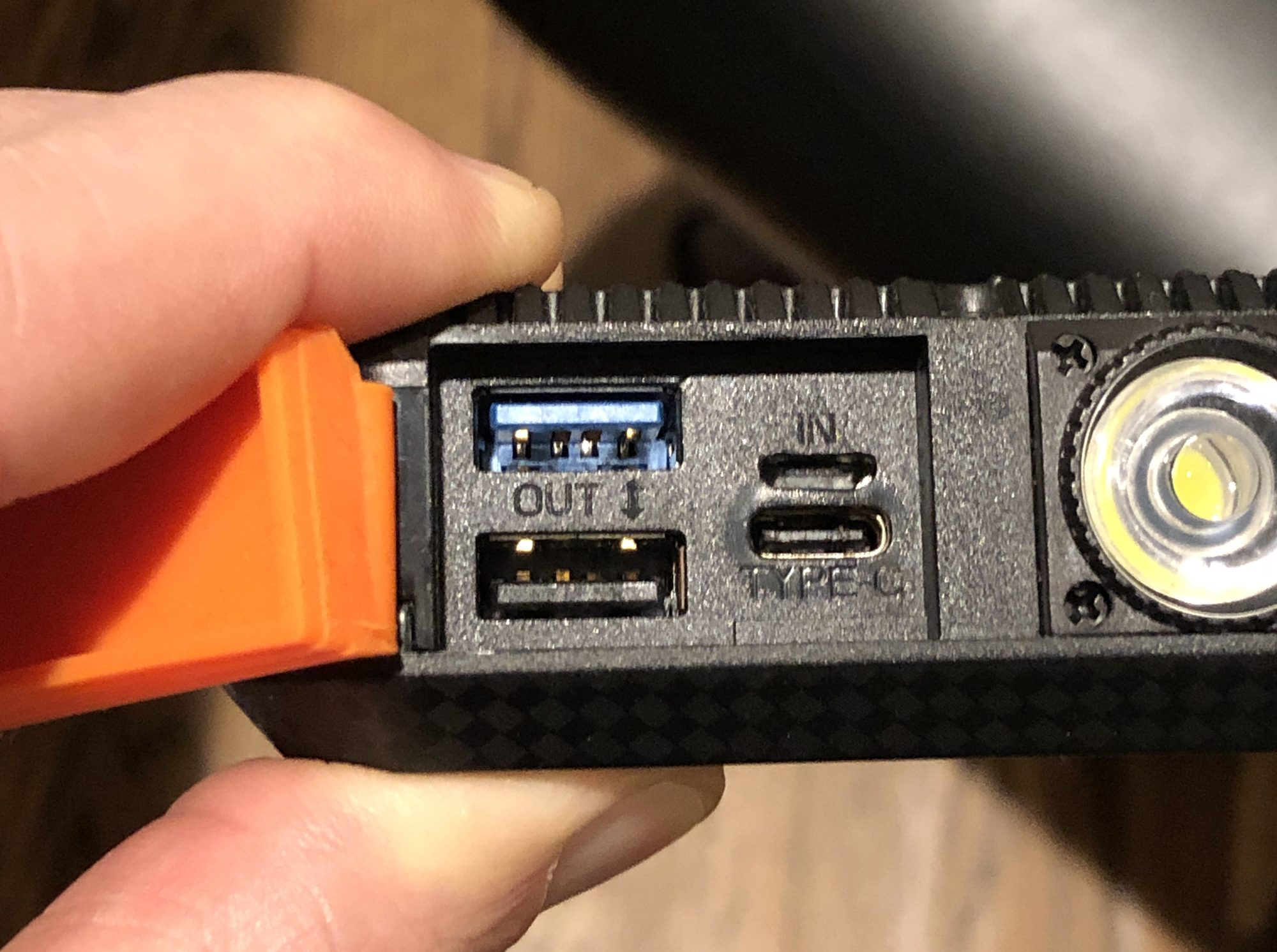

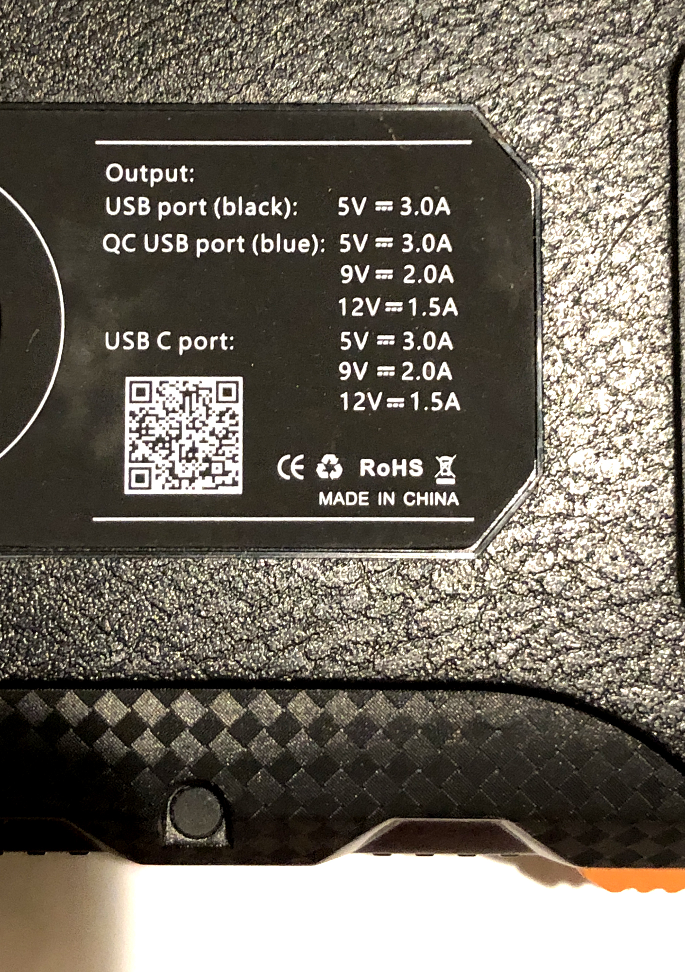

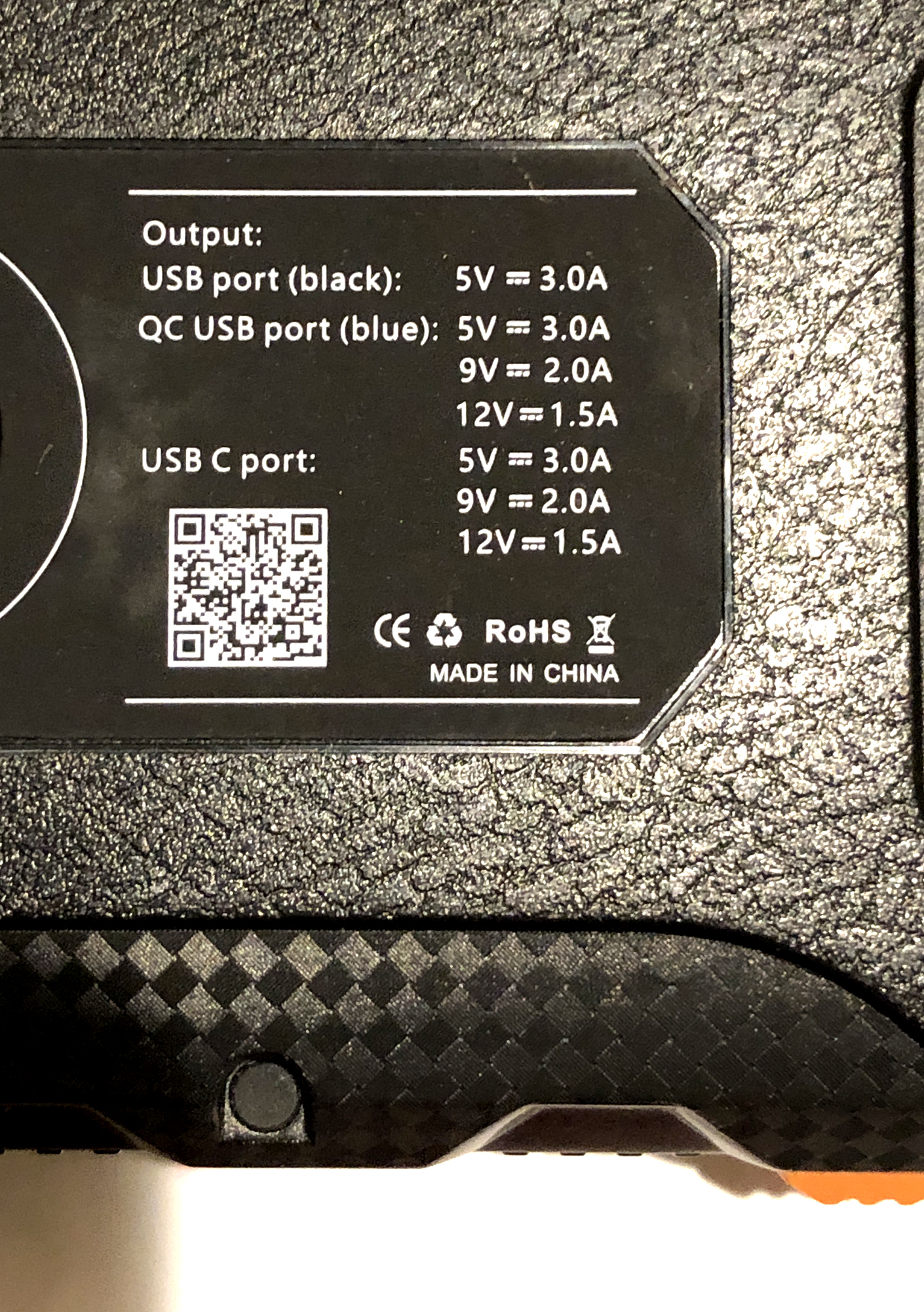

Well, I don't know what to say about that. I have 5W and 10W chargers, and none of them trigger charging on my M1 iPP 11, but the 18W and up do with no problem.
Well, I don't know what to say about that. I have 5W and 10W chargers, and none of them trigger charging on my M1 iPP 11, but the 18W and up do with no problem. View attachment 1977813View attachment 1977814
Just a thought, you're obviously using a USB-C to USB-C cable with 18W and a USB-A to USB-C cable for 5W and 10W. Maybe it's not the chargers but rather the cable that's problematic. Have you tried using a different USB-A to USB-C cable?
Yes I have, to no avail. All my cables are from Anker except for the Apple cables. I could understand if I was using older cables not compatible with new tech, but the new cables are advertised as backward compatible and should work just fine with older chargers and batteries. Two of the batteries in the picture above are only a year old, so there should be no compatibility issues there either, other than the fact that they are much lower wattage than the charger that came with my iPP. I have several chargers that work just fine. I just need to get a couple batteries that are advertised to work with the M1 iPP.

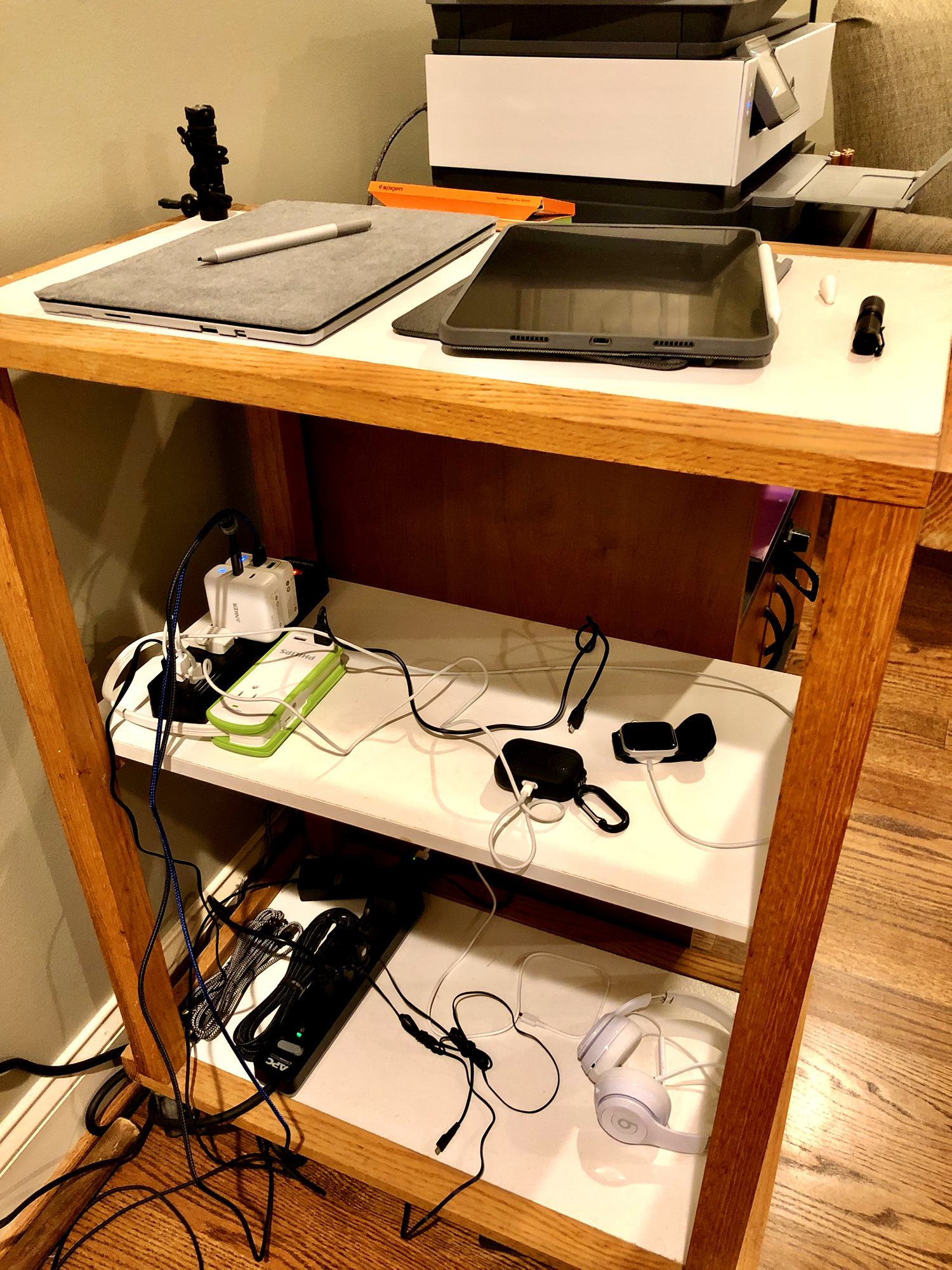

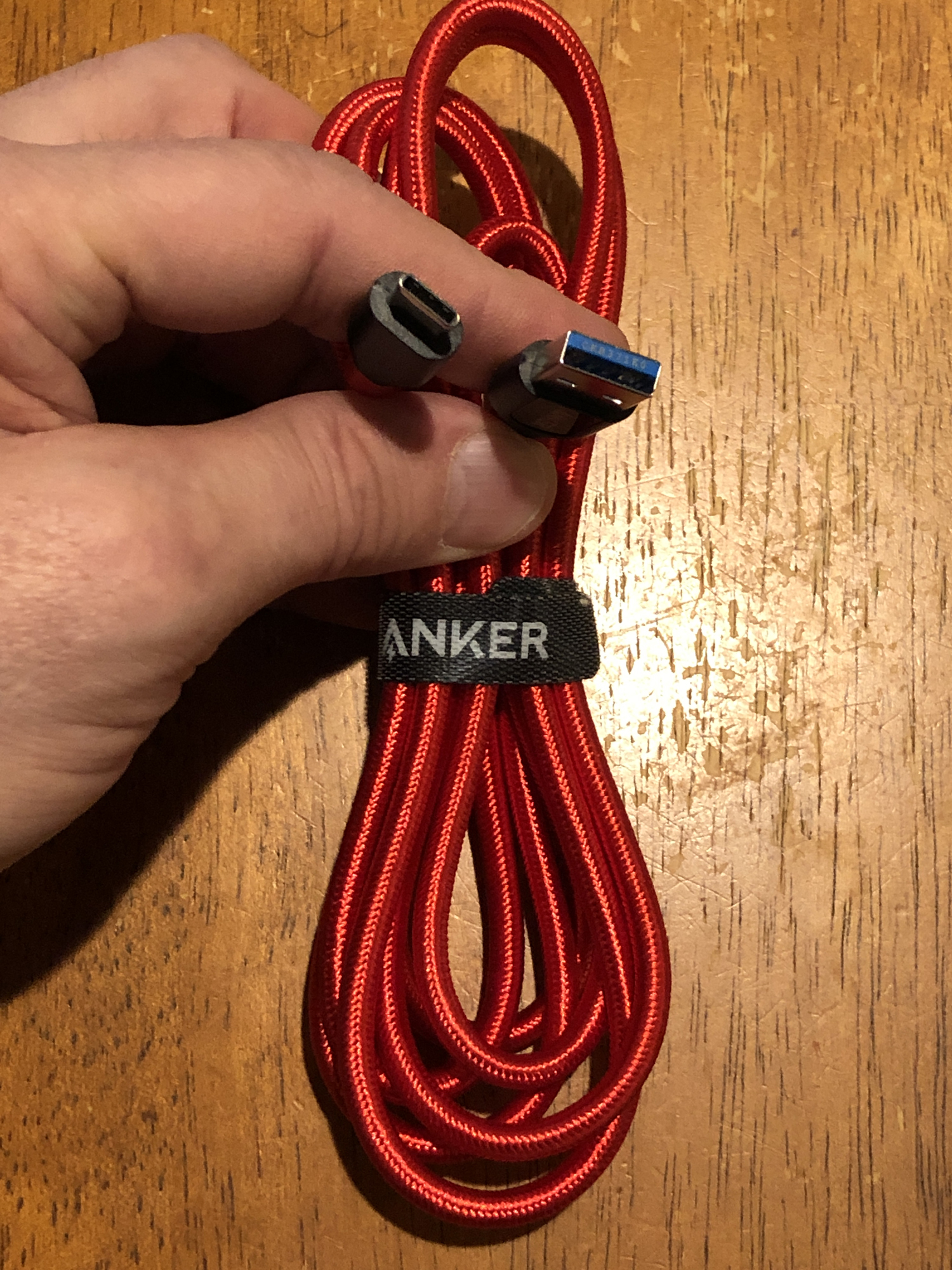

Well damn! I am going to have to do some more experimenting and report back. The same cables that work with 18W and up chargers just won't work with the lower wattage external batteries I have and I don't know why. And why does my older iPad 10W charger not work with my iPad? Using the same cord that I do with the Anker Elite 24W charger.
Well evidently most of my USB A to USB C cords aren't compatible with my M1 iPP. All the batteries and the iPad 10W charger work with this cord.
Guess I don't need new batteries. I need new USB A 3.0 to USB C cords.
None of my USB A to C cords are more than a year old. Seems like they should be current technology. Especially since they are made to plug in to USB C devices.

Thanks! I guess I could always use another battery. The 3 that I currently have in these pictures do in fact work with this Anker cable, but none of my other USB A to USB C cables work, so it is definitely cables I need. I am over at Amazon searching as we speak. Not sure I want the Anker again at $19.00 each. I might get another one of those, but search for a pack of less expensive one's just for extras.
Edit: Looks like these should work just fine.
This is the cable I used for my charging tests.
