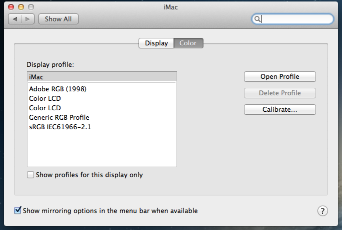

The attached screen shots are what shows on the iMac Displays settings:

I don't think it is recognizing your TV. You would see it as a selectable display if it was. You may have a bad adapter or HDMI cable.
Also, there is no need to mirror. It is actually the worst way to go as it could mess with resolutions and such. If you ever get it set up correctly, you should uncheck the mirror option and set it up so that it treats your TV as a second monitor.
