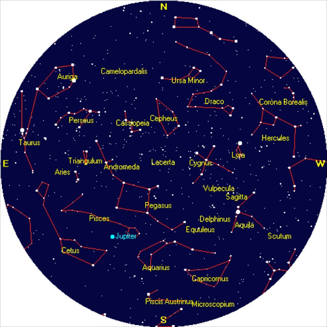

Here is the whole sky chart for 8-13-10 @ 2:30am
(gotta love heavens-above for this handy chart for your location)
