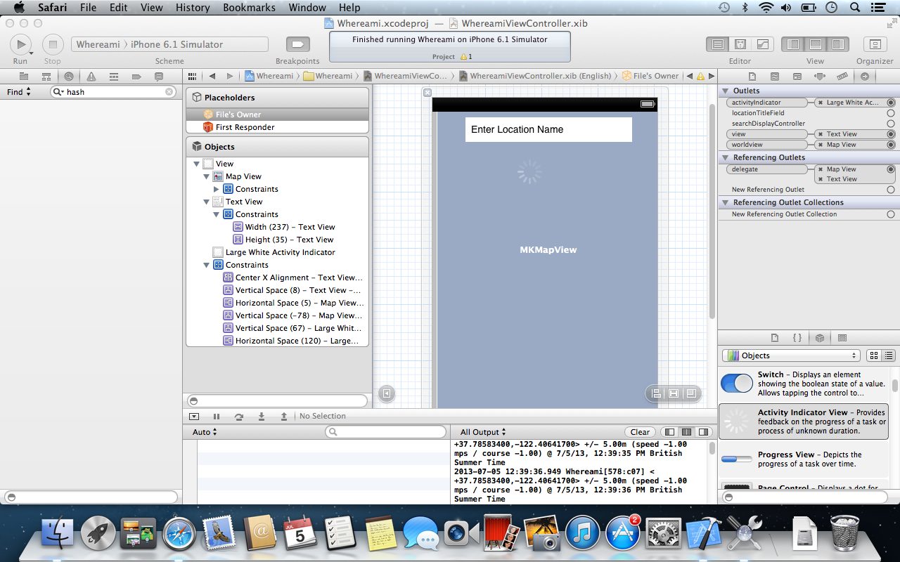

I am working through the Big Nerd Ranch IOS Programming book page 107. I am looking at Chapter 5 -and trying to construct a graphical user interface. My XIB file has three objects (MKMapView, a UITextField and UIActivityIndicatorView. However, :-
1) I am missing a connection from the "LocationTitleField" to the "Text Field"
2) the connection view to view should be "view" to "text view"
Can somebody explain why I cannot make these connections. Much appreciated.
Thanks
Kaps

It's not clear what you are trying to do. I think what you are saying is that you are trying to drag a connection from the "locationTitleField" on the left "Connection Inspector" onto the "Text view" entry in the hierarchical list of view objects in your XIB file.
Can you open that screen-shot in an image editor and draw circles around the two points you are trying to connect and then a line between them? (say in red at 2 pixel line thickness and 50% opacity)
If that's what you are trying to do, it would create an iBOutlet link from the "locationTitleFileld" outlet defined in your view controller's header to a text field in your XIB.
If I had to guess, I would guess that your "Text View" is a UITextView object, and the outlet is set up as a UITextField object.
UITextView and UITextField objects are not the same type of object, and you can't make a connection between objects of different types.
You need to switch one or the other object to the correct type.
Thank you Duncan - as you inferred, I have mixed up UITextView and UITextField. I will make these changes and then revise the connections. Much appreciated.
