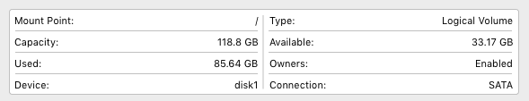

So i hope I havent missed anything here, but im trying to find ~13gb not showing up under my SSD on my 13" MBP on El Cap GM.
I have 120gb Samsung 750 Evo drive, and my finder says I have 33gb available. Although disksweeper only calculates a total used of 72gb, os x reports 85+gb used.
Ive disabled localbackups and rebooted a few times since.
What else am I missing?
Screen Shot 2015-09-12 at 11.11.21 PM.png Screen Shot 2015-09-12 at 11.11.44 PM.png

I think that graphic showing 88GB used is just incorrect then, because that command is accurate and includes all hidden and system files.
