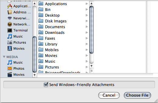

Hi again,
I've checked on my home machine and I don't see anything in terms of preferences to change... however I did notice that the attachment window now has the "Send Windows - Friendly Attachments" selected by default. Maybe that's all that needs to be done... at the very least it's worth a shot for your client to try out.
I hope this does the trick!

He says he has always had that checked, so that cant be the problem. It is specifically forwarded emails that have attachments on them. I have not had a problem with him sending a new email with his own attachments. It i just a hassle for him to have to download attachments, upload them again to a new email when he should be able to just forward them over. Anyone got any ideas?
