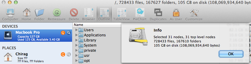

I've also attached a screenshot of Whatsize reporting the discrepancy in size - approx 18gb missing as 105gb used including hidden files and the used report being 123gb.
