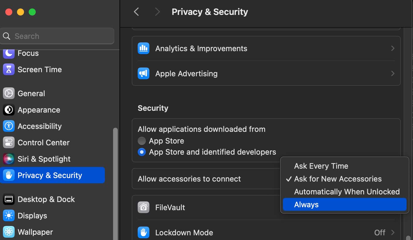

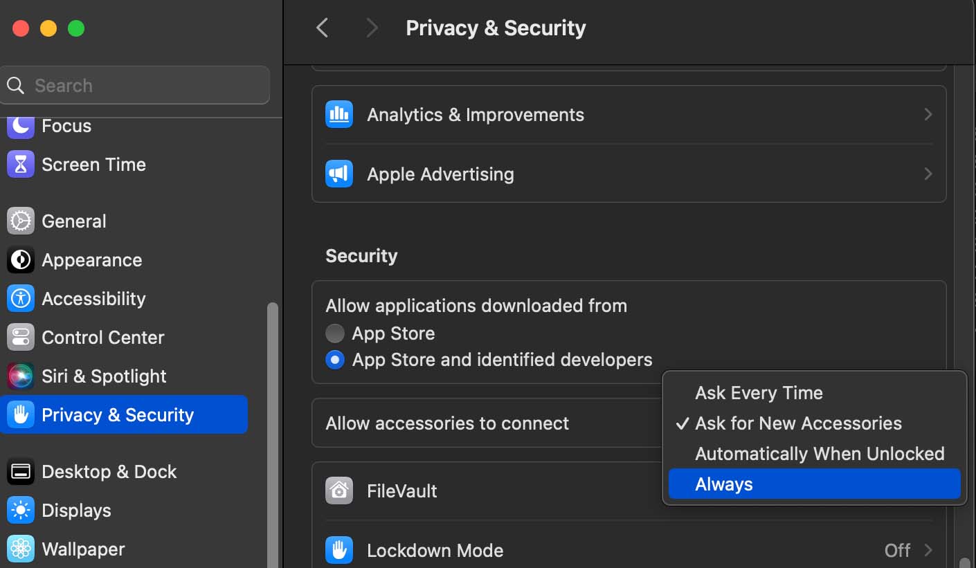

As the post above states, this setting is only available for Mac portables, and it is in Sonoma. Mac desktop computers will always allow all devices to connect.

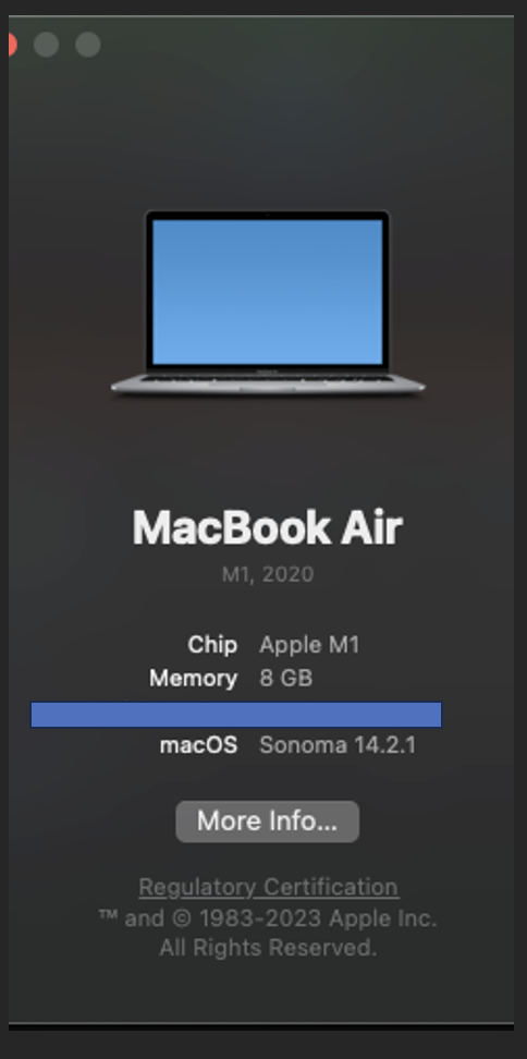

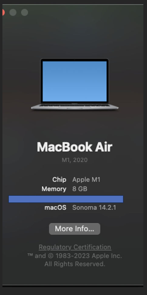

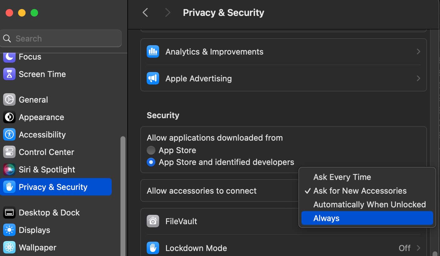

It's working in Sonoma 14.2.1 (23C71) MBA M1

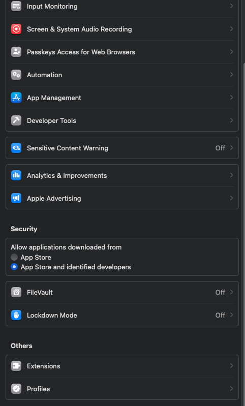

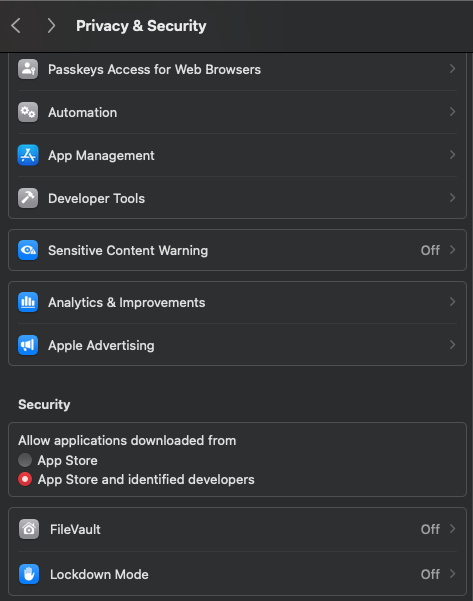

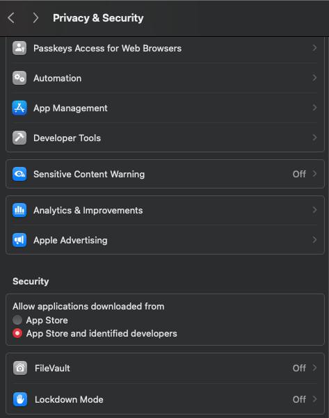

its a M1 MBA See SS 1 below and I dont have the option shown above see SS #2, I will also say the reason this came up is I have an LG monitor that once I plug into the Dock wont work. Ive tried USBC and USBC to HDMI with multiple known good cables. If I plug the USBC directly into the MBA it works fine. Also I've plugged a PC laptop into the dock with the same cables and no issues...
